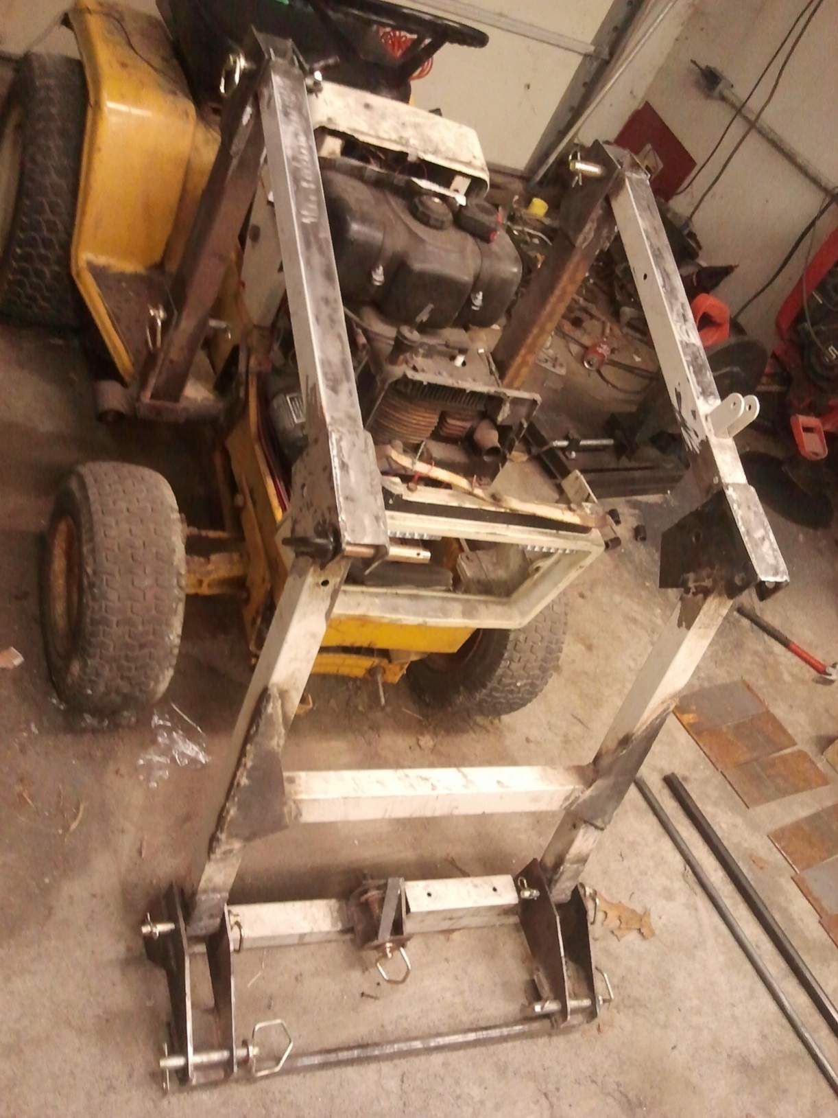

This is my 1250 cub it will push a decent pile of gravel with snow blade so i decided it would be perfect for a small front end loader for the garden
i have built a trencher,Gp bucket,a 4 way dozer blade all with quick attach possibly a tiller to come. I am waiting on the cylinders and pump then will have to get hoses made. Can't wait to play with this thing!

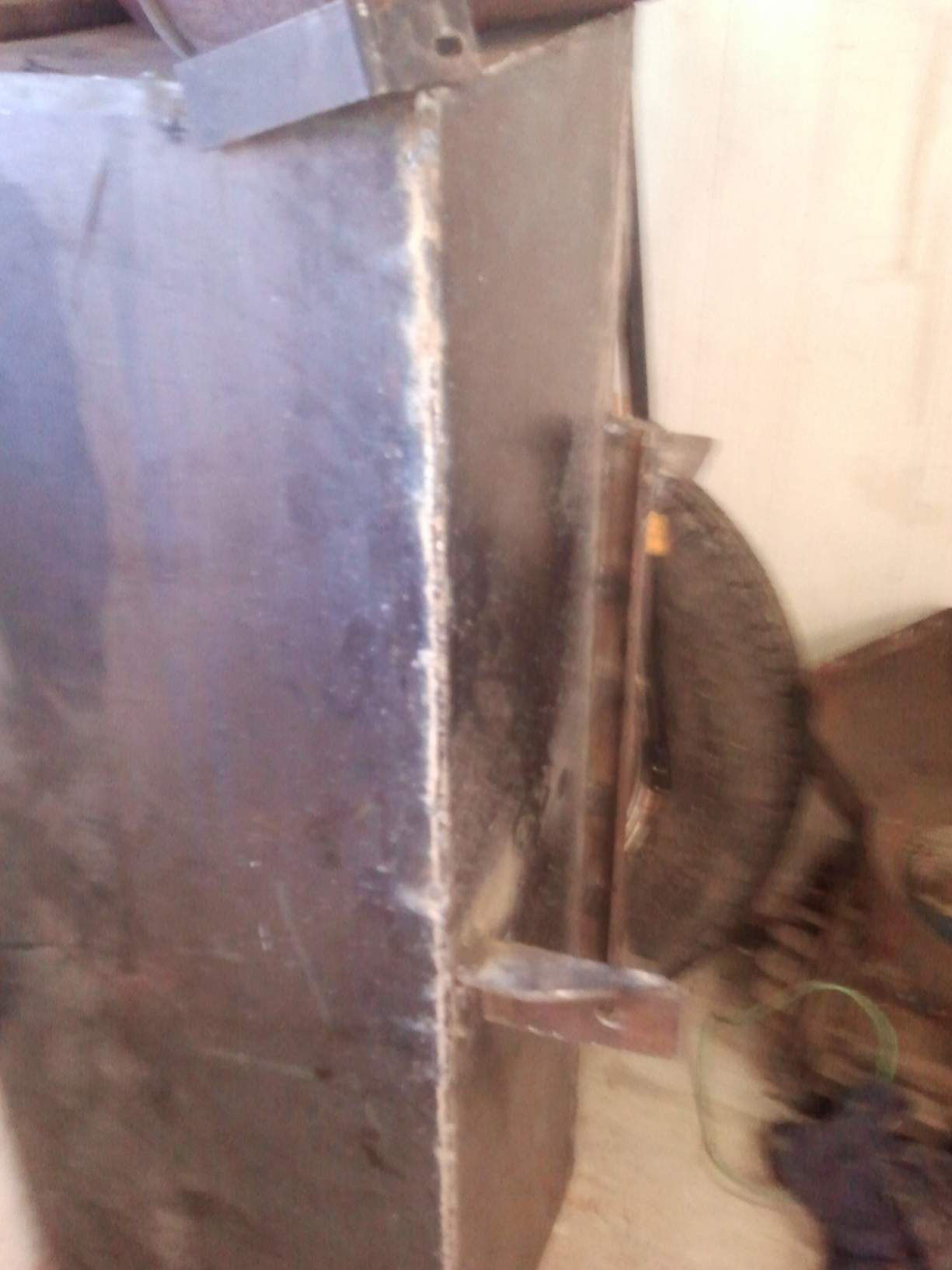

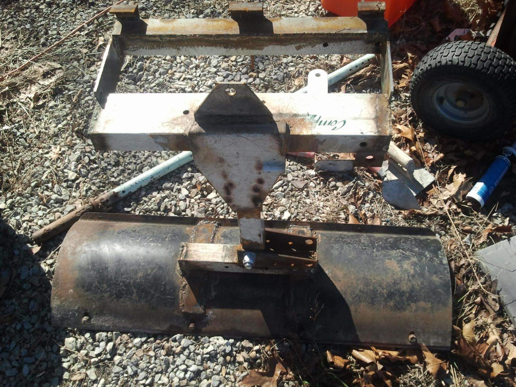

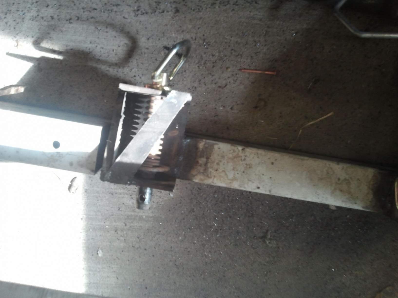

here are some pics. looks like it will work quite nice should have just over 6ft of height at dump.

Looks like a good start. What are you doing for a subframe? Have you considered upgrading those front spindles to trailer spindles?
   / cub cadet FEL
I have the 1"spindles stock curious to see what they will handle. The sub frames bolt to each side through factory holes and the arms slide in them and are pinned in place. There is a factory brace between the frame rails right where the sub frames mount. It is very solid I blocked the arm up on each side and moved 7 80 lb bags of concrete mix a couple weeks back the only problem was no weight on the rear.
