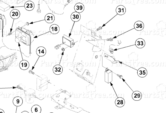

We have owned this tractor since new about 2005. about 700 hours now and it has been a headache since day 1. My current problem is when the ignition key is turned, it is hit or miss if the ignition controller will turn on. (dash lights, fuel pump, etc. I have to on/off, on/off, on the key or bump the engine to get it to come on. Then once the tractor starts, it will sometimes die while in service. I replaced the ignition switch and tried to trace the wires to ensure there are no loose ends. I have read on some posts that the safety switches tend to draw down the voltage and produce this type of behavior. It was posted that a Relay can resolve this issue. Would anyone be kind enough to elaborate on this.. I am aware of relay function, installation etc... But I need specifics on circuit intervention and part/s..

I would like to thank those who replied to my post. This was a difficult issue for me to trace, but I problem was a faulty Relay.. Cub Cadet Part Cub Cadet MA-19572918000 located behind the dash board. I ordered it from partstree.com for $95.00. (I have no affiliation with them, but they have been great to me) This may be an isolated issue, but my symptoms were when I turn the ignition on, the dash panel indicator lights would not come on. No fuel pump noise, etc. If I on/off/on/off/on I would get it to come on. my fist inclination was a faulty switch. I could still bump the engine but it would not run due to lack of fuel.. I hope this helps someone else who may own a Cub Cadet 7532 tractor (Mitsubishi) The engine runs great! Hydros worke great! Front frame sucks due to notch for power stearing hydraulics. Mine fractured due to end loader stress.
