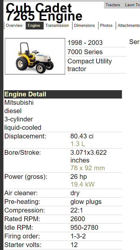

Welcome to TBN
It appears your CC 7265 has a Mitsubishi engine. I know the CC 7360 I owned a few yrs ago also had a Mitsubishi engine.
