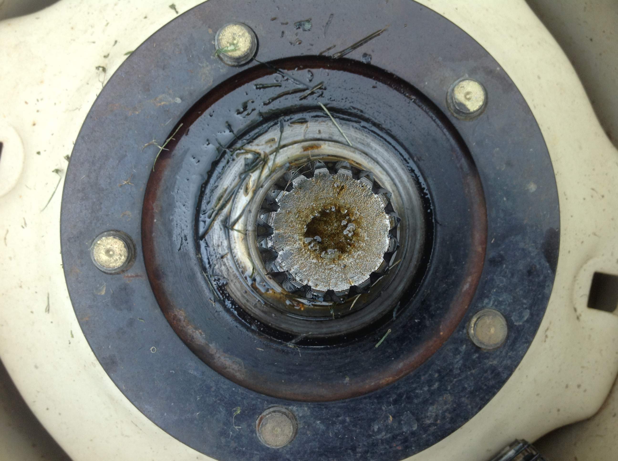

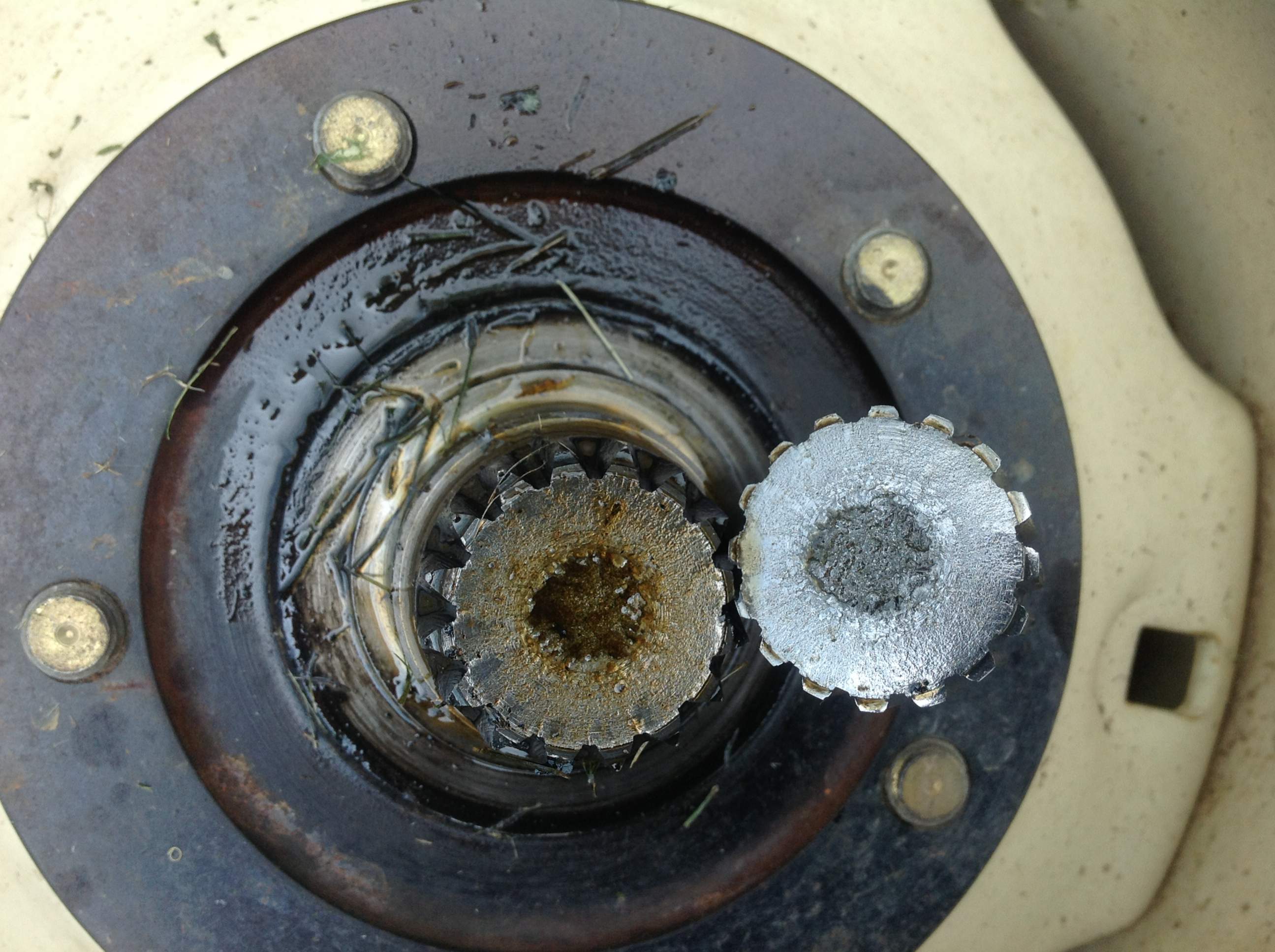

While mowing, wheel fell off.
I do mow with the loader on, but had no idea a shaft would break so easily.
Ordered parts, will document fix.
1 of 911-04141A - Cub Cadet - SHAFT-WHEEL HUB W/ @$116.51ea.
1 of 721-0497 - Cub Cadet - Seal, Oil, 35mm x 55mm x 8mm @$7.07ea

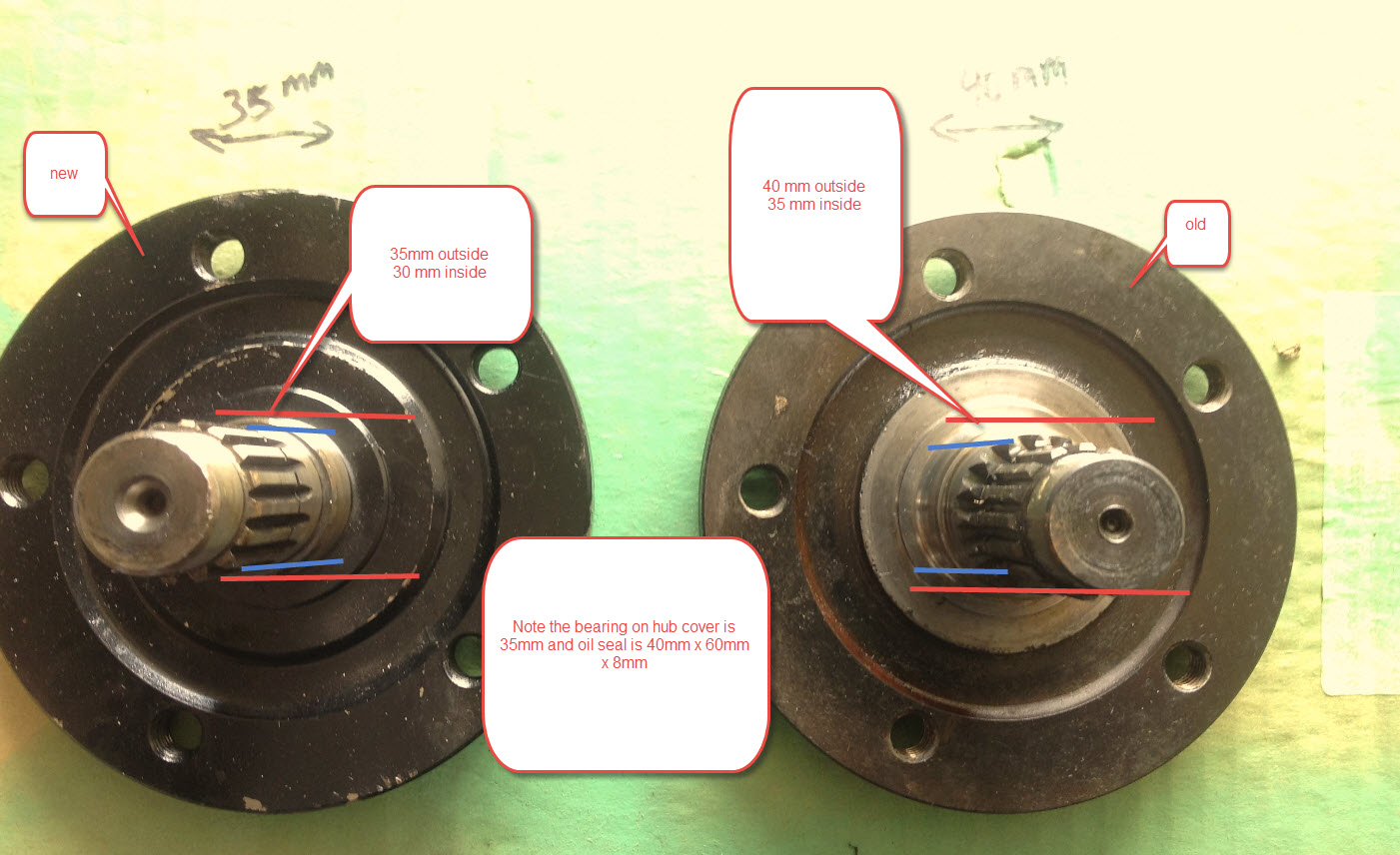

Well.. Parts came in, and wouldn't you know it, not the right size.
Turns out my 6284 have 5000 series parts in them(note, axle has never been apart before)
I've read about the 5000 series breaking axles, and sure enough mine has the 5000 series axle shafts, go figure.
So I new part was from a 6000 series, so I just now had to order different oil seal, bearing and cover as the 6000 is 5mm smaller than the 5000
I'll post part numbers and more pics next week when more parts arrive.

finally got all the parts in and put back together. Waiting on permatex to dry for 24 hours.
Here is a list of parts I bought. Note these parts are for the 6000 series, mine had 5000 parts in it, but I opted to replace with 6000 parts instead of just replacing the 5000 axle (911-04060)
911-04141a axle shaft
919-04024a axle cover plate
941-3033a Bearing (goes in axle cover plate)
716-0201 retaining clip (prevents axle coming out of axle cover plate)
721-0497 oil seal
Some things to note: the axle diameter towards the outside bearing end is smaller than the 5000 series, the axle cover plate is thinner than the 5000 series, the retaining clip is thinner, the 5000 series uses a thicker c-clip.
Bottom line is now I have some 6000 parts on the drivers side and the old 5000 parts on the passenger side, I guess time will tell which side will hold up better, you would think the 5000 parts as they are thicker, but maybe the metal was inferior?
It is interesting that you mention that. I am not a metallurgist, but I thought that the fractured end in your picture looked like poor quality, low density steel. It seems to me that good steel appears as a much 'cleaner' break when it fractures, but again I have no real scientific basis for my observation.
You mentioned that the 6000 series has a thinner C-clip. If I remember correctly your break occurred at the point where the C-clip is installed. Perhaps the groove required for the thicker 5000 series C-clip was a design flaw that weakened the shaft at that point. I think I remember others posting about breaking axles so maybe they can reply with information regarding where the breaks happened on the shaft. In general, the fact that most of the dimensions of the 6000 shaft are smaller indicates to me that it is engineered using higher quality (stronger) metal.
