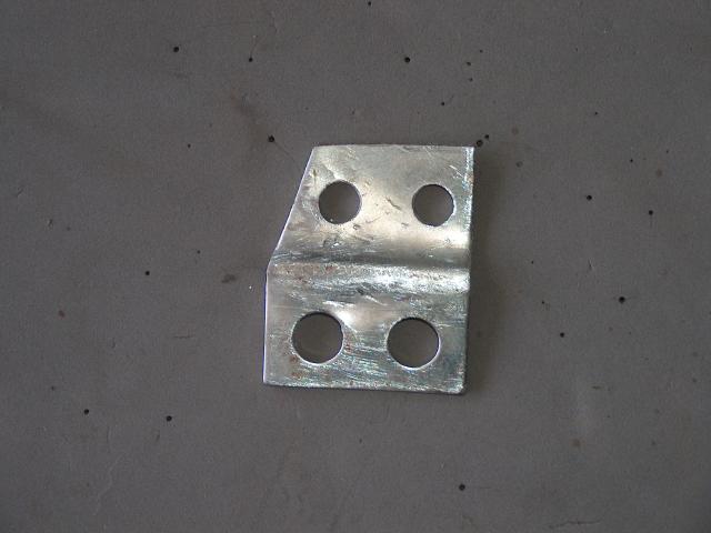

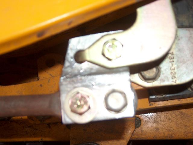

Here are pictures from an old post of a modification that I made to my 3235 which helped gain a little reverse speed.
Bob B.
   / Cub Cadet 3000 series slow reverse #10
<img src="http://www.tractorbynet.com/forums/files/cub-cadet-tractors/440120-cub-cadet-3000-series-slow-hpim0766-jpg"/><img src="http://www.tractorbynet.com/forums/files/cub-cadet-tractors/440121-cub-cadet-3000-series-slow-hpim0765-jpg"/> Here are pictures from an old post of a modification that I made to my 3235 which helped gain a little reverse speed. Bob B.
I like the way you think. Looks like a solid fix! With as expensive as the 3000 series tractors were, you'd have thought it would have been designed better than the cheap plastic bushings rubbing against metal.
