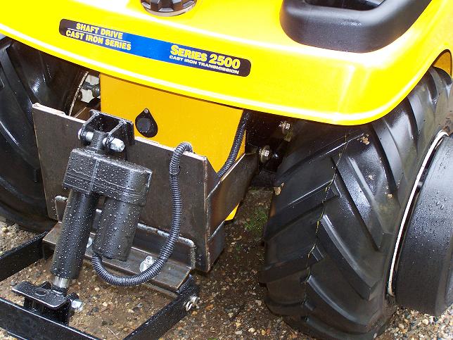

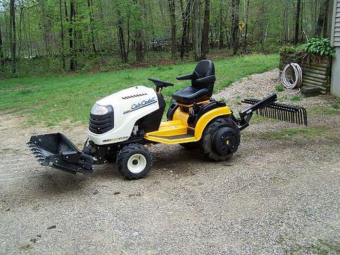

I agree. That's a very nice machine. How is that rake attached?
Dean
Thanks.
The rock rake is attached with a sleeve hitch. I puchased it on ebay. I had a mounting bracket made for the sleeve hitch.

Nice Johnny Bucket $1000 ?
I'd love to get one where'd you mount the switch? 2 holes in the dash
one fo rear/front.
Pic's....Pic's.....

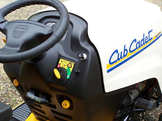

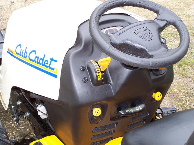

The JBjr cost me around $1185.00
The switches for the JB are on the left side of the console, and the switch for the sleeve hitch is on the right side.
