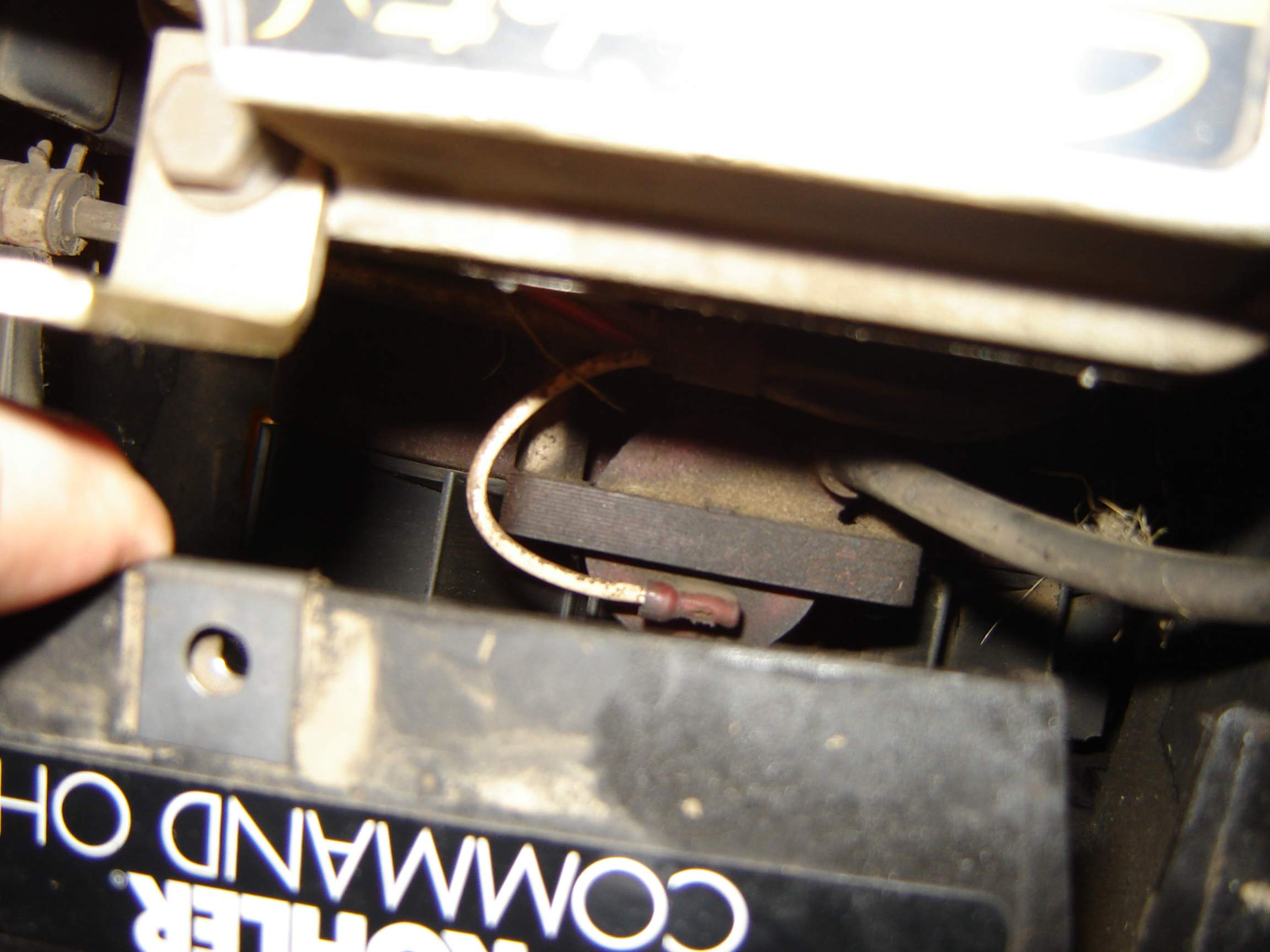

Well I'm having trouble pulling the engine shroud/blower housing back. I was able to pull it back some, but it seems to be hung up at the bottom. I've checked many times and all the screws are removed.
So how far back do I need to be able to pull the top of the engine shroud to be able to change the ignition module? Here's a picture of how far I've been able to pull back the shroud: DSC00185.jpg Will I have enough room to line it up properly with the fly wheel or is there a way to get this shroud off further? Thank you.

Yes, I had exactly the same problem. It was the coil. Next time it has to come out, I'm cutting the shroud in half. Dumb universal design which requires taking the tractor in half to remove a sheet metal shroud.
Two things to try before spending $50 on a coil. With the engine running, insert a hose sprayer in the air intake on the lower left side of the shroud. Wash out all the dirt and grass. Then, with a piece of sandpaper on a stick, sand the rust off the flywheel. Often this will make the problem go away.
