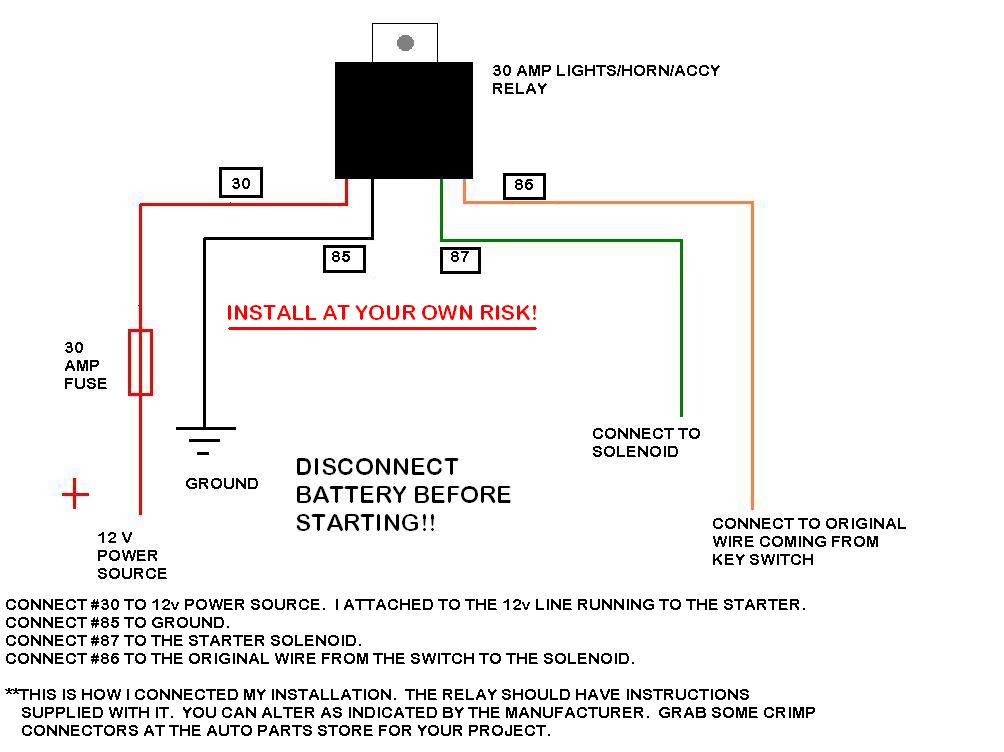

   / cub cadet 2135 no start #8
Might be the safety switches are getting corroded and by the time the circuit has been completed and made it's way to the solenoid, there isn't enough voltage to activate it. A starter assist relay may help. This in no way will bypass any safety features/switches. The circuit has to be completed as normal, but it takes less power to activate the relay, which will in turn supply full voltage to the solenoid.
