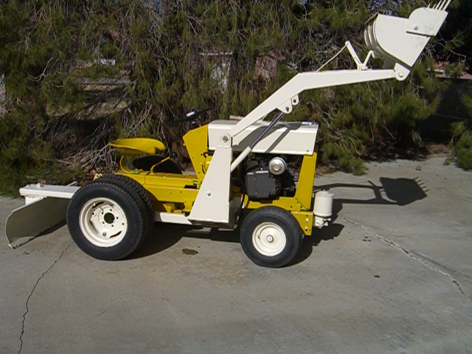

Years ago, I had the Cub 100 that had a B&S L series 16hp engine in it. Had to lenghten the frame a few inches to fit it in. Ran great and had plenty of power. Probably used it for 10 years before i sold it.

   / Cub Cadet 122...what would you guys do? #5
Since the original 10hp motor was blown when i got it, I can't compare it to the 16hp motor. If you notice in the picture, there are dual rear wheels and there are wheel weights between them. My biggest problem was traction, even with the engine at an idle, doing any real work with it, the back wheels would slip. The 16hp never loaded down, I think it was worth the effort. I did have two hyd pumps on it, one in the front for the loader and one on the back of the engine for the rear blade lift. I had to have a custom clutch machined for it. You might be able find a replacement motor that would fit without having to modify the frame. Harbor Freight has some low cost engines that might work?
