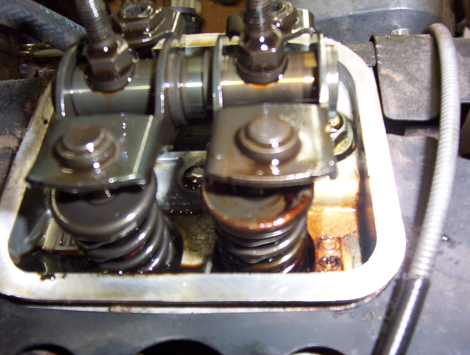

Hi and thanks for reading,
I was mowing the lawn and the motor started to sound like it was missing, then stalled. I pushed it into the shed, removed the air cleaner, and the plate the air filter sits on was very wet with gas. It runs but misses, pops, backfires (but with no flames). It does not seem random. It has kind of a pattern to it. Any idea what would be causing this?
Thanks!!!
   / Cub 1641 Backfire/Pop Through Carb #2
You are running on one cylinder. Could be a spark plug wire shorting out, faulty plug, valve clearance issues. Just will need to start checking out things.

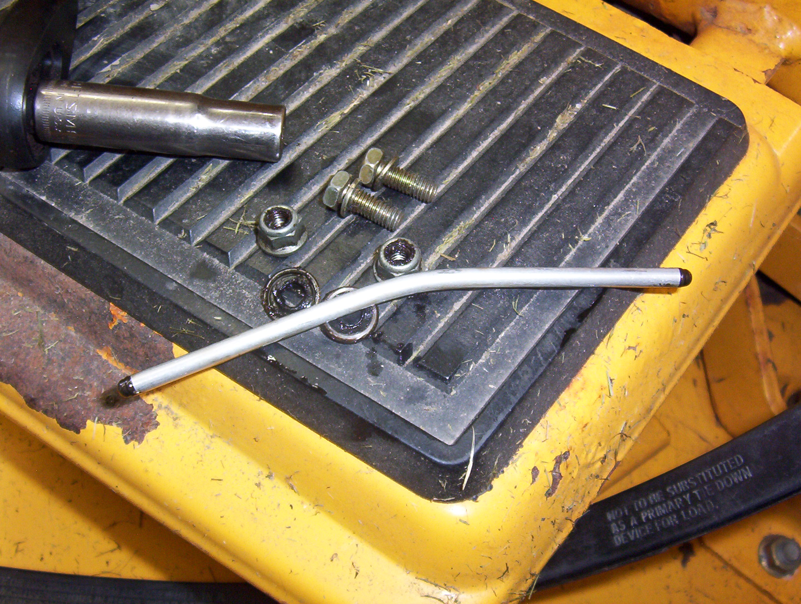

From the short video I can confirm that it is the Briggs Vanguard engine. Model type and code will be either on a tag on the blower housing, or stamped into one of the valve covers. The vanguards will bend a pushrod now and again for no apparent reason, so that may be the issue.

And here is the reason:
You can see the front rocker pivot was installed backwards.
And this was the result.
So I inspected the other cylinder, and both pivots were installed backwards! My neighbor bought this at a garage sale for a song and a dance. The seller said the top end was just rebuilt. I'm willing to bet that they just replaced the valve seals and screwed things up putting everything back together. I'm surprised he could even drive it off the trailer, let alone finish mowing half of his lawn. I think 4 new push rods and he will be back in business.
