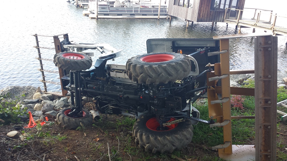

Hope no one was hurt, but how did you manage to do it? Looks like level ground
Seat belt was on and no one was hurt. It hit a little dip with a mouthful of rocks lifted a little too high!
Things happen fast, so be careful!

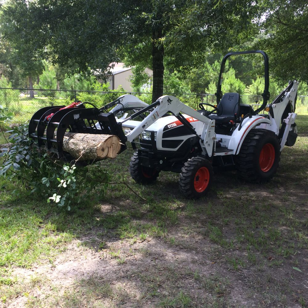

Here's an upright Bobcat pic for you guys! It has the same size Wicked Grapple installed on it.
