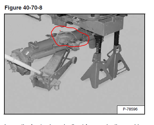

I know you are changinf oil anyway but just FYI, there IS a vent on front axle. I found mine by accident looking around under the radiator and found hose I thought was disconnected. Traced it back to the axle. Attached is photo from shop service manual that shows it after axle removed.
