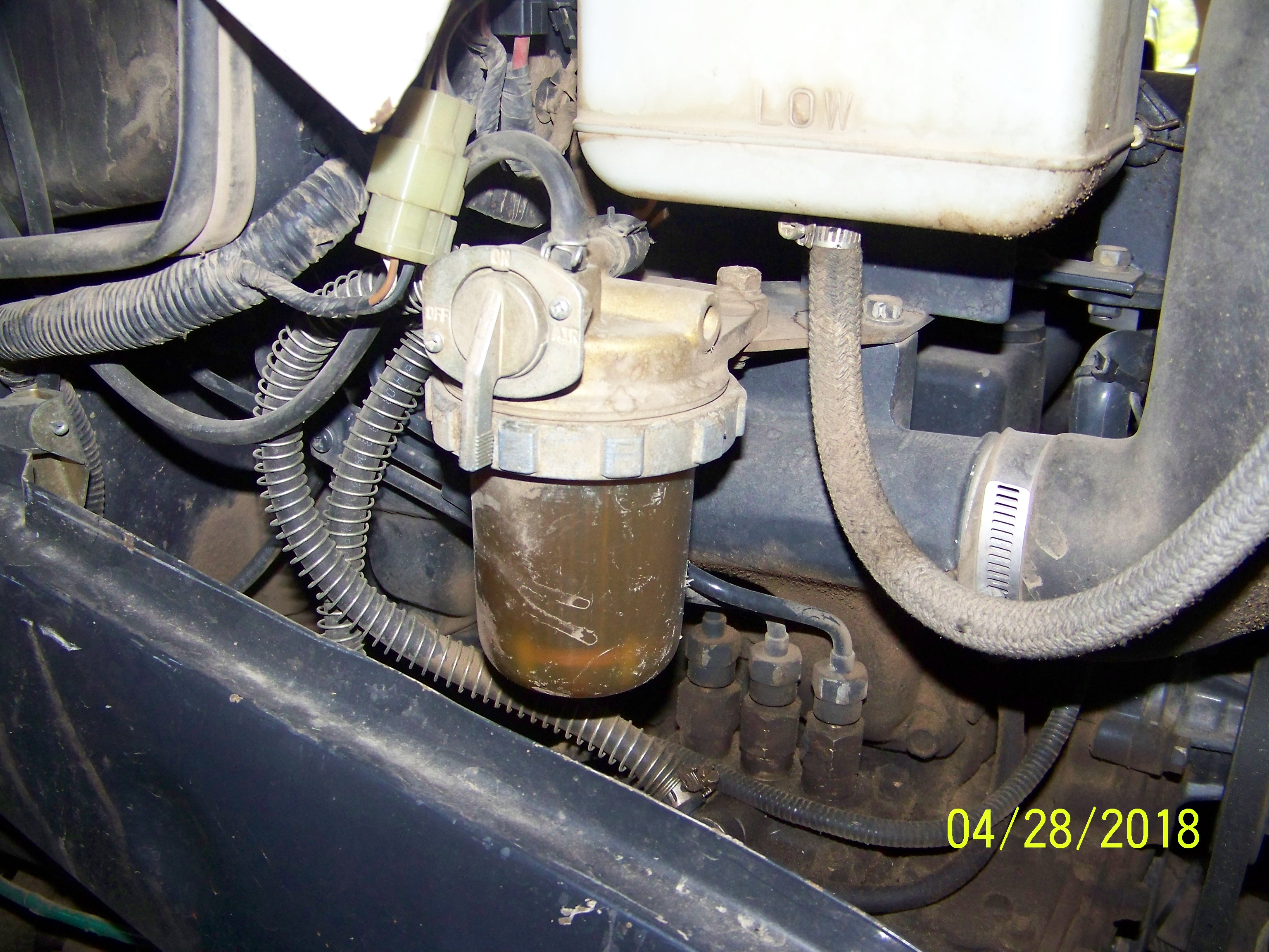

is there an in line fuel filter on this tractor, if so where is it located
   / ct 235 losing power under load #2
Right here. Bobcat 6695912. Baldwin PF717, Wix 33507
