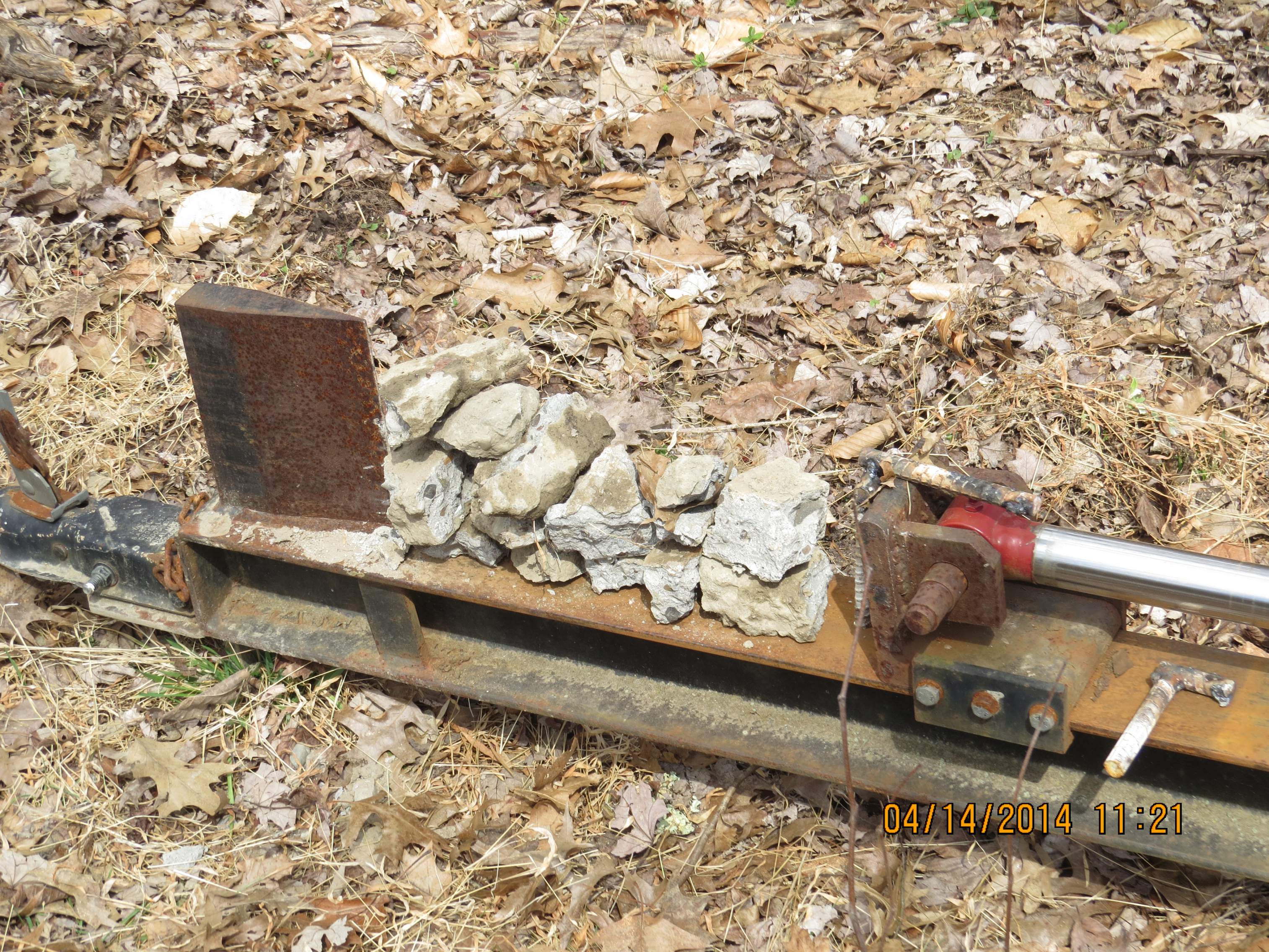

I need a crusher. I have hmm maybe 7 yards of concrete from a slab I picked up no wire in it but had fiber. Size ranges from 2" thick 6" x12" to 6" thick 2' x 4'
set over a couple of rails a sledge will crack them . I also have a small rotary jack hammer. I can use feathers and wedges or Dexpan ( better) to reduce the big ones .
I saw a great small crusher on you tube , the link started here . But It was 12k and needed a 16hp engine. Neither of which I have laying around. I do ,however have lots of time. I was thinking of a log spitter . The wedge is ok the pusher would need two projections the place the concrete piece in tension around the wedge. I tested the theory on a press with a pressure gage on it 4T to snap a 2" by 6" piece. With a bang I might add.
I have a small spitter around 9 tons. Thats the next step. I also have something in the 25 ton range but it has a box wedge on it and I would have to make a new wedge for it . Only if I have to. Will keep you posted. I bet a vertical machine would work great for this with projections on the base. And one could sit while doing it.

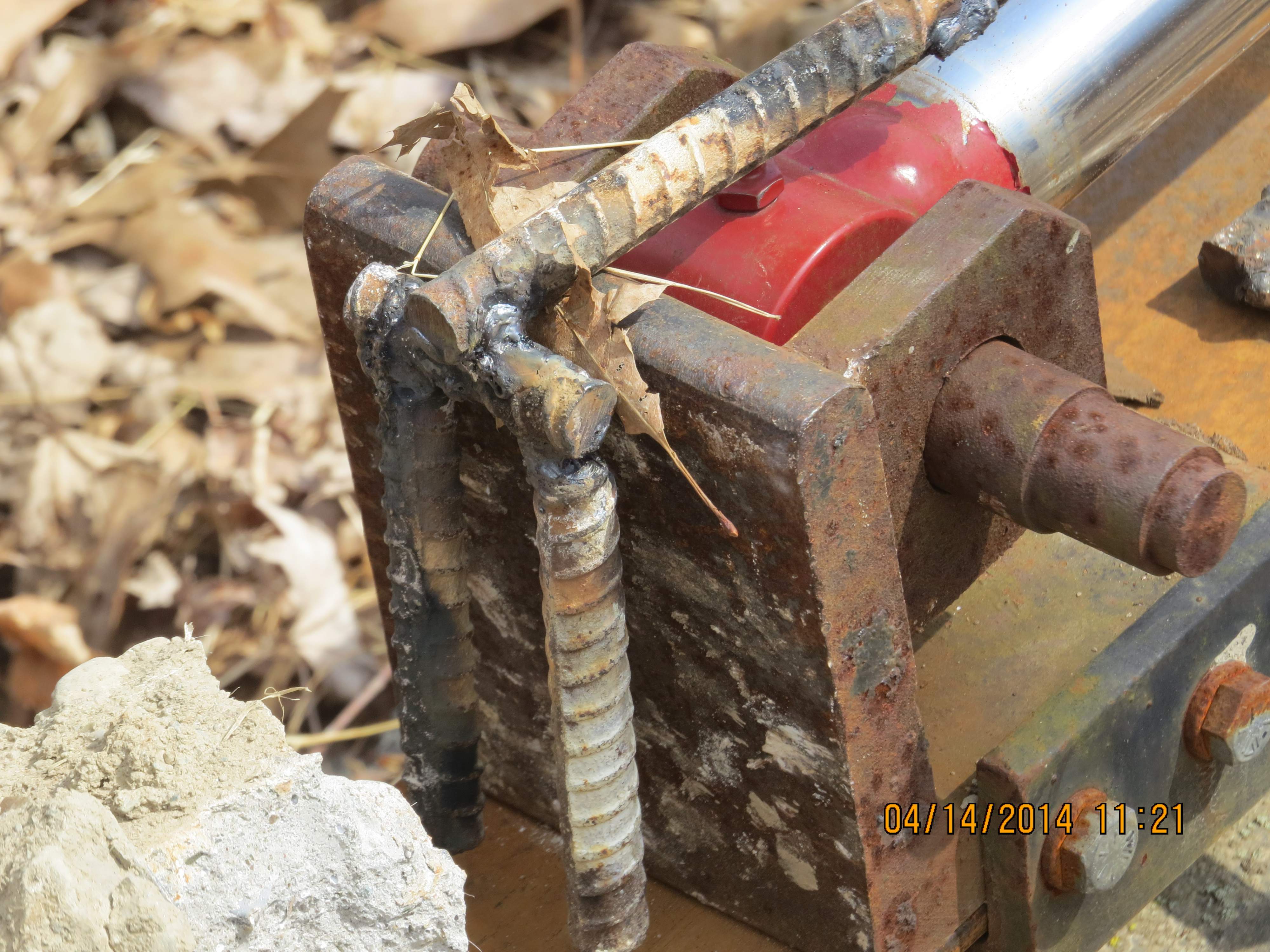

Amazing Log Splitter pops concrete easy. Easier with some projections on the pusher flat. Did not even go into low gear and the broken pieces did not fly around much. Then the projections broke off and I tried with the flat pusher. Maybe pump shifted , more energy in the split and the pieces flew a bit . It broke 2" thick standing up as well as 2" thick laying down with 4" the long way . I supose 2 x 4 is the same as 4 x 2 . I have to make a better way to keep the rebar verticals in there , Maybe a loop around the cross pin. I do have pictures but I can tell you guys want movies. I can do that but let me get the cage fixed first. IMG_0576.jpg]IMG_0577.jpg
Now that I look at the picture I realize that I could just weld the rebar on the flat. it would still work as a splitter. Except I cannot get the splitter to the welder right now. Waiting for a guy to place 11cy concrete no show today. IMG_0529.JPG
