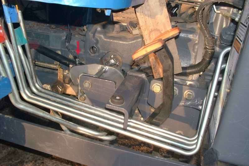

Tom, I love the way you casually say you took the magnet off and put another on. /forums/images/graemlins/smirk.gif That is not an easy job, considering where the magnet is located. It is tucked away pretty good as you can see in the attached photo. I had my platform raised a foot, or you'd never be able to see the magnet in the photo.

In this second photo, the magnet is easy to see, but most of the pedal mechanism is removed. Can you describe a little of what you went through to get the magnet out?
