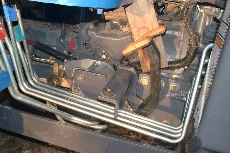

Jumped on the tractor for the 50 drive to the property and the cruise didn't work. When I parked it Sat night it worked just fine and Sunday morning no go. When I push the switch the light comes on and stays on but the pedal doesn't stay. I've done a search on the cruise control and have a direction to go to see if I can figure out what the problem is. Only 20 hours on the clock.

1. Loose wire at the electromagnet that energizes onto the HST swash plate.
2. Loose mounting screws for the electromagnet bracket.
   / Cruise is out #5
The brake switch should not be the problem. It would cause the green light to go out also and you said that the green light stayed on. Chris mentioned two possible problems. It could also be something between the magnet and the plate that won't let the magnet establish enough friction to hold the plate in place.

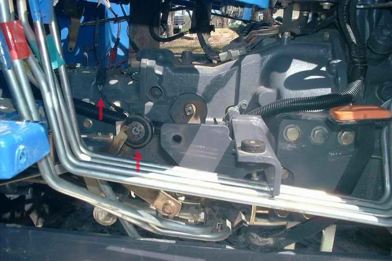

I'm attaching a couple of pictures from when I had my HST pedal problem and disassembled the operator's platform. You won't see things as clearly as the picture shows, but at least these will show you where to look. The first picture has the plate removed and the red arrows show the cruise magnet and the connector. The second photo shows the plate in place.
You do not have to have the tractor running to troubleshoot the cruise control. Start with the wheels blocked or the tractor on a flat surface. Just turn on the key with the brakes released and press the cruise button. You should hear the magnet engage and disengage with the cruise control switch turned on and off.
