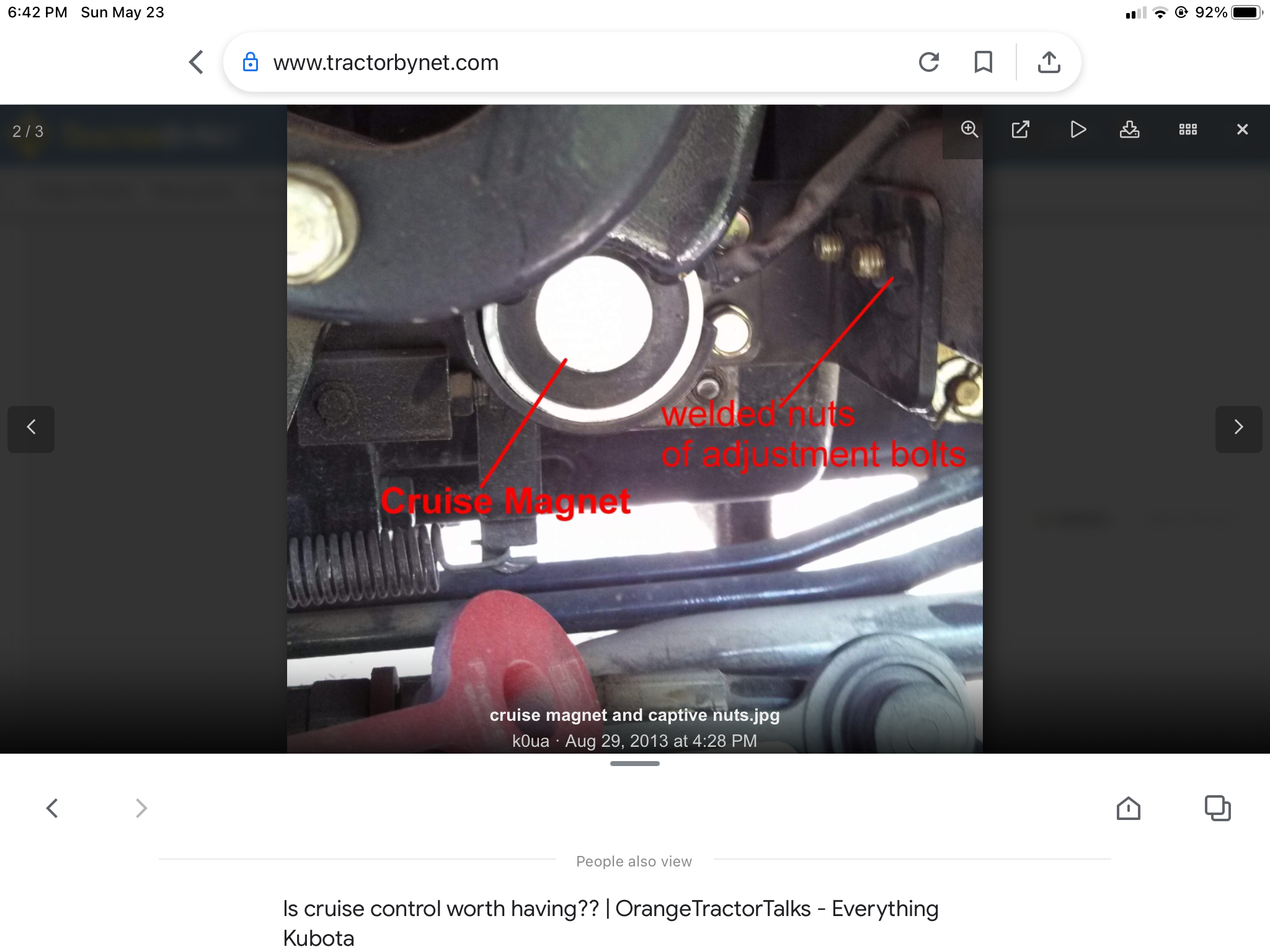

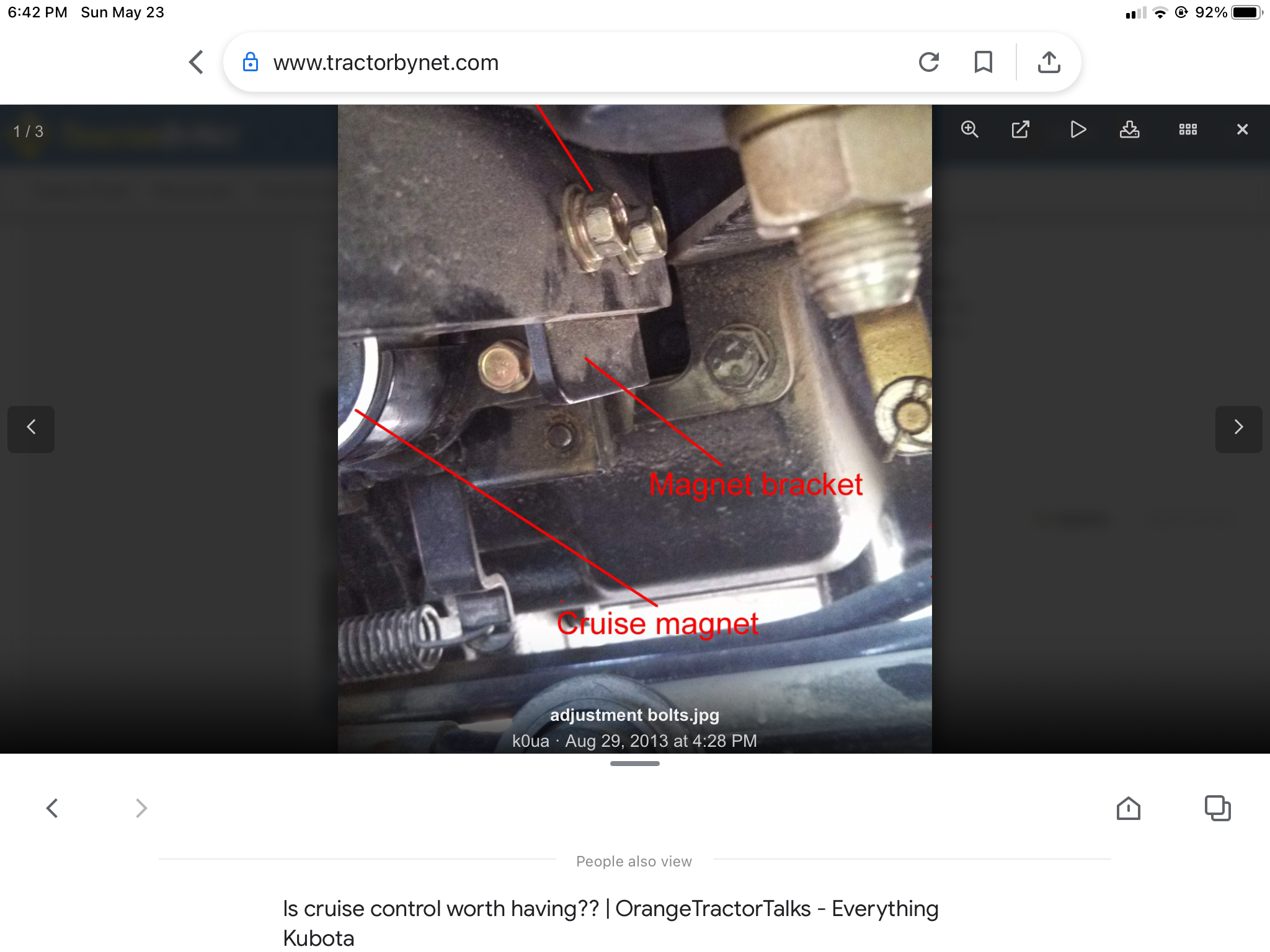

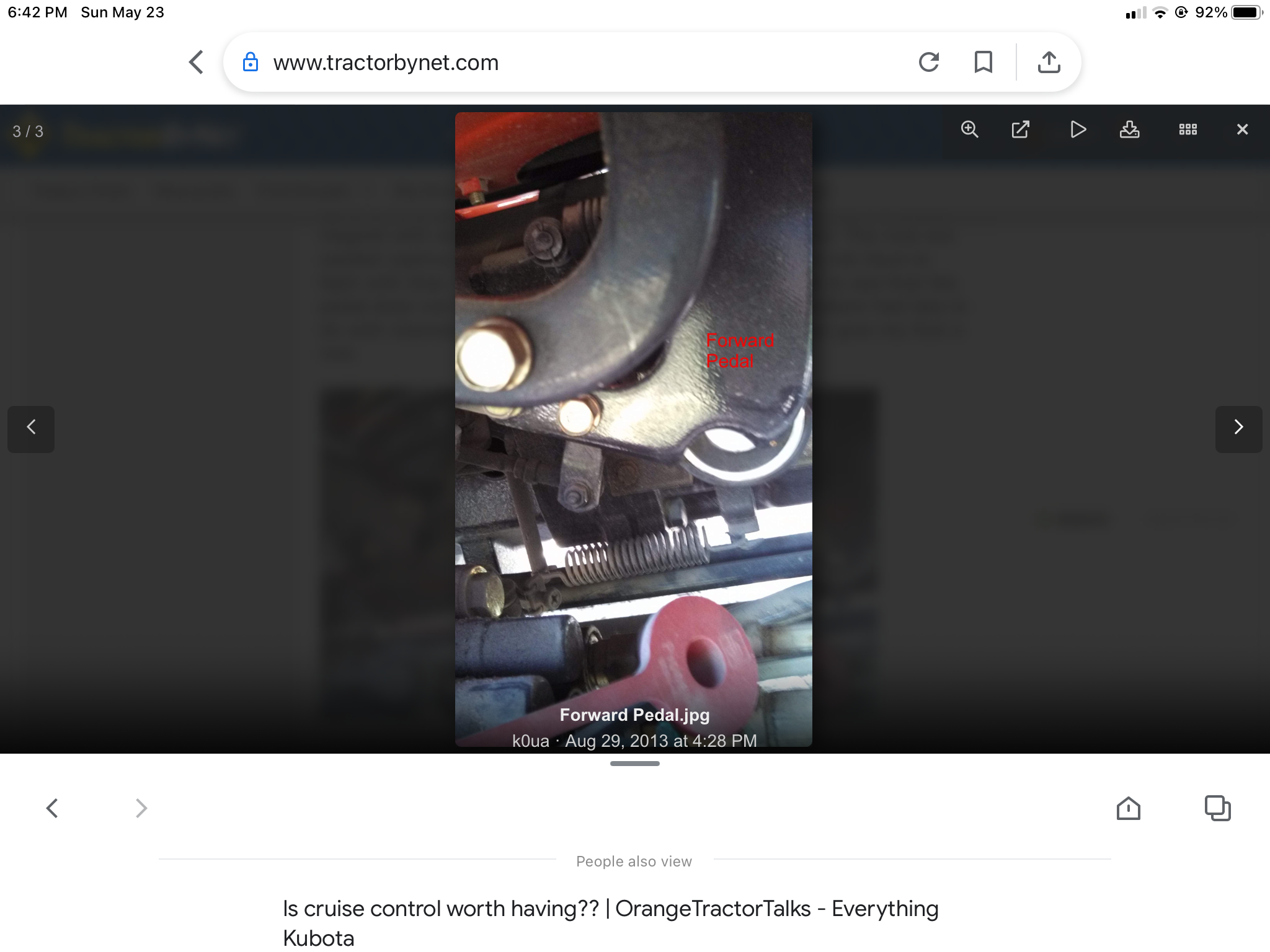

I have a 2020 DK 4710 SE Hyd After mowing about 6 acres I have to admit my foot got a little tired I could sure use the cruise control. I wish I would’ve had the dealer added it on when I added the link peddle. I cannot find the part image on the Internet. even though I believe I have the part number CkA120 From what I’ve read this is for the CK series but I’m sure it works on the DK as well. Has anyone installed this. I don’t want to take it to the dealer leave it there for two weeks. It doesn’t seem that difficult. There’s a magnet attaches to the frame you run a wire add a fuse.
if anyone has added one please let me know the steps involved. I’ll be calling the dealer tomorrow to order one but I’d like to have firsthand knowledge of anyone has done it themselves as well

I spoke to the dealer it turns out that this is a plug and play it’s a very easy install.

Just installed it easy Peezy four bolts all the electronics were plug and play already set up pigtailed Add a couple relays Fuses to the fuse box which came with the kit 10 minutes you’re done . Works like a charm absolutely love it.

Old thread, sorry. But important to me. Would this have memory or you have to wait and guess your speed then set it ?
   / Cruise control kit install #7
There is no memory. When you disconnect, the magnet lets go of the pedal, and the tractor stops. To reengage, you get up to speed, and the magnet holds the pedal for you.
