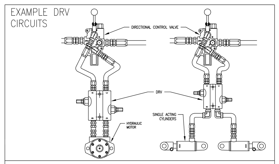

i just purchased a Prince cross over relief valve that i want to mount on my snowplow push frame. did not come with any intstructions. Are there any instruction videos etc for this item??? It is marked C-512 and has the A B C D ports etc. thanks for any an all guidance..
   / cross over relief valve... #2
This from a Prince valve manual for motor or cylinder(s) with dual relief valve. Not the only way(s) maybe. Looks like both sides are bidirectional with 'line' on one side and 'load' on the other. To me, the hookup to SA cyls suggests they're opposing. (implement rotation, steering, etc) The motor circuit is plumbed the same way for bi-directional use. How about to a cylinder or pair then? :unsure:

This is EXTREMELY HELPFUL...thank you very much
   / cross over relief valve... #4
A&C to the valve
B&D to the cylinder

One thing that can be very confusing if you don't know is that the relief pressure adjust screw on the A-B side adjusts the relief pressure in the C-D line and visa-verse the screw on the C-D side adjusts A-B relief pressure. Don't ask how I know.
