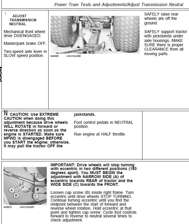

I have a 1993 JD 855 and it tends to creep when letting off the pedals in forward or reverse. What is the best way to adjust the pedals?
   / Creeping JD855 #2
   / Creeping JD855
Thank you I have been searching the forum for hours and could not find anything. Good to know 4300 shares some things with the 55 series.
