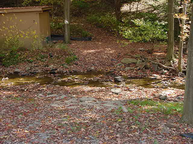

Based on your description, your creek is probably a little bigger than mine (pic attached). I have clay banks and lots of stone for the base so I'm not having the issues you're referring to for driving through but let me throw a couple things out.
For culverts, you're probably going to have problems. Here in PA, you're not even allowed to use them in a natural creek. If you do put them in, under a heavy flow they may either clog, forcing the water over the banks, or wash away all together.

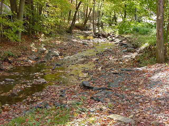

I had a ramp going into mine (see next post) that had 1" stone going down the bank. It only took 1 good flow to wash it all away so I don't know if that'll work for you. (In the next picture look at the cloth to see where the stone was).
What Gatorboy did may be a very good option for you (and it's what I tried) but you mentioned 5' banks. Are they sloped or do you need the existing ramps to get through?
Besides just driving through it (weather permitting), I've realized that I don't have much of a choice other than to build a bridge out of 10" I-beams and decking (pretty much like what TBAR posted). I'm going to raise above the banks and set on concrete posts on both ends and one pair in the middle. The concrete posts will all be in double-wall 15" culvert pipe.

Another pic - stones washed away (right side, where you see the cloth)
