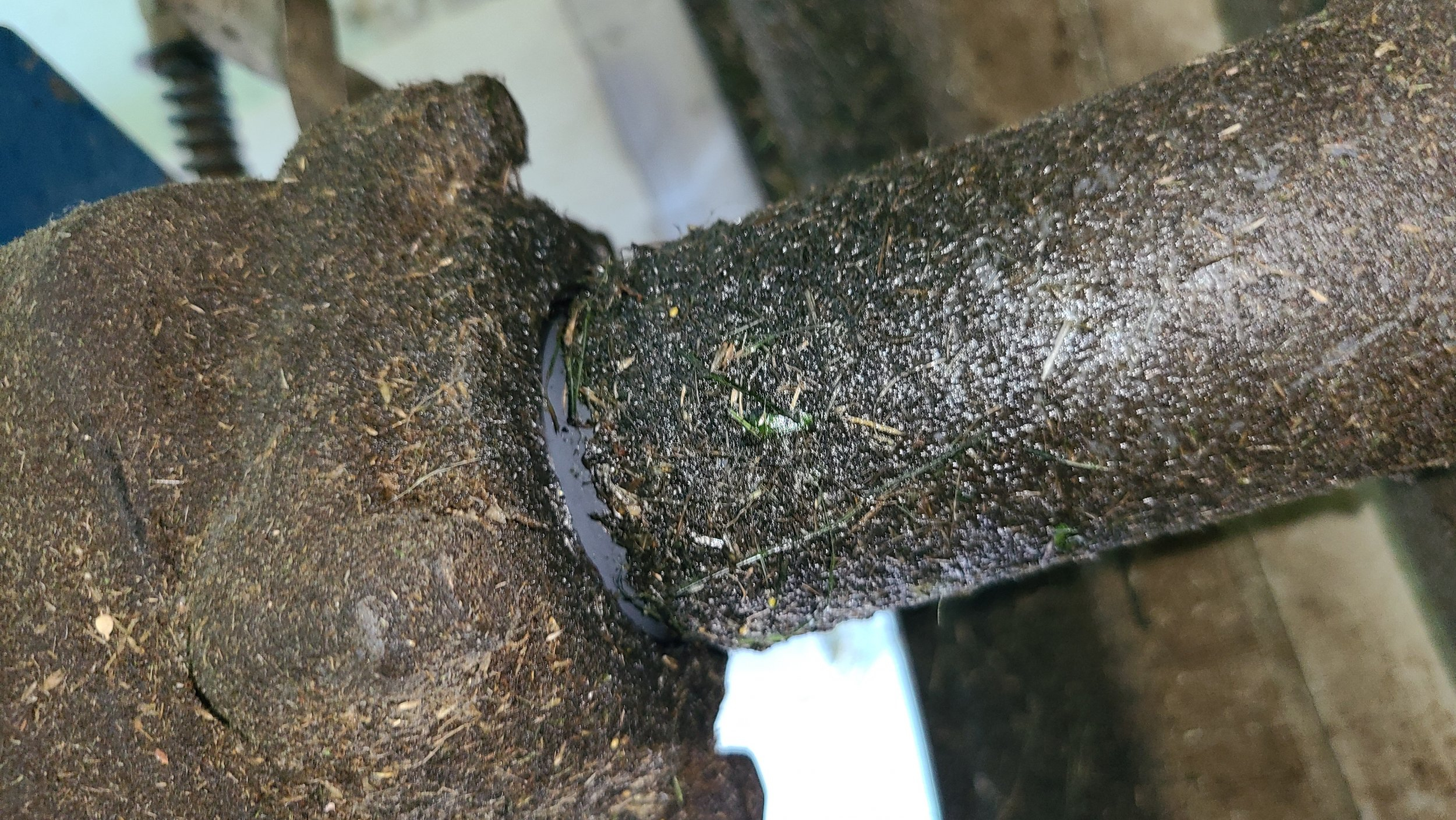

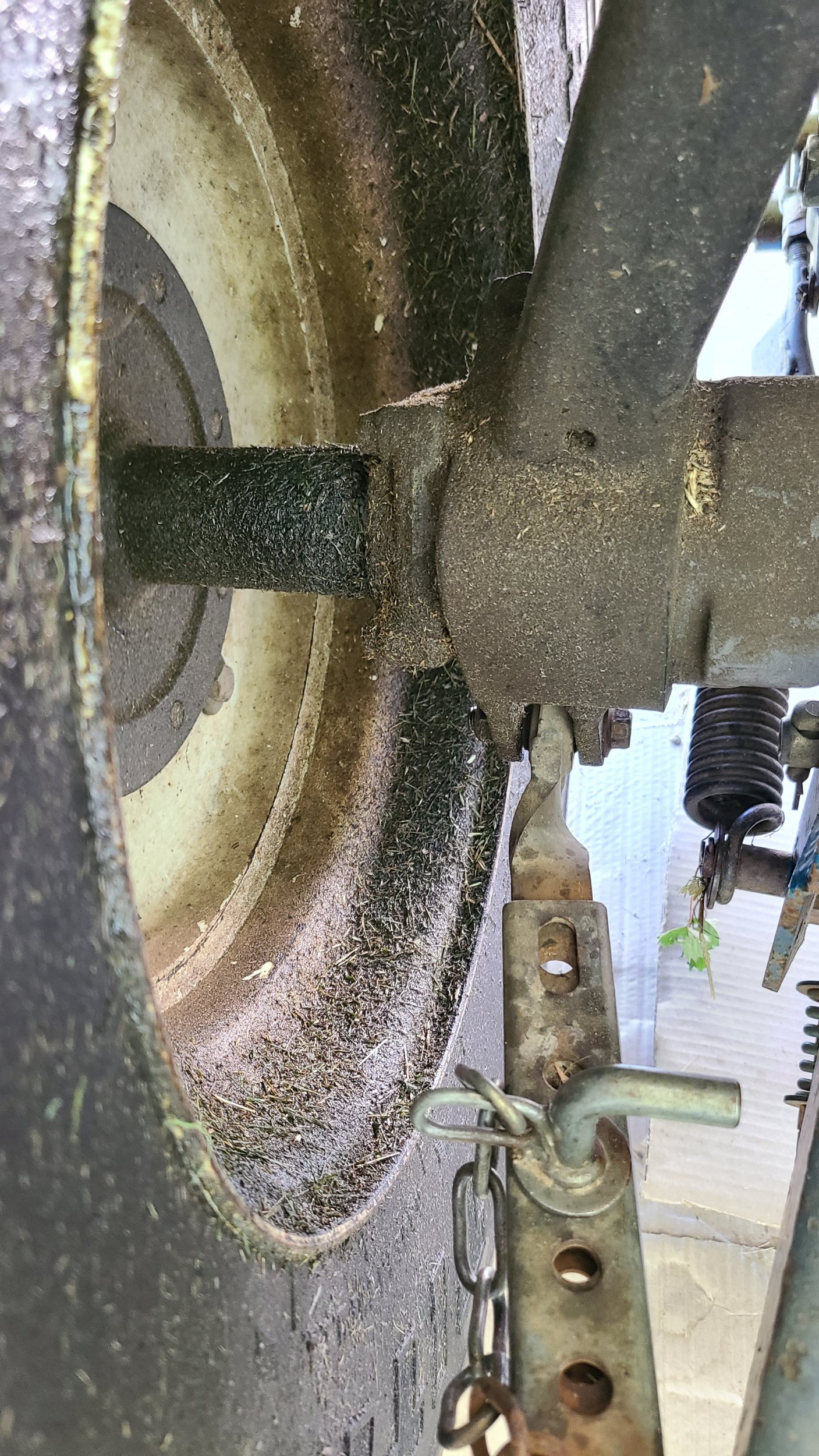

I've noticed a creaking and popping noise coming from the left rear axel area (same side as differential lock pedal). I've noticed it previously but only once in a while but this week while Bush hogging my field it was happening a lot. I'm not sure if this is differential related or other internal to the axel? I've also noticed I have a leak on rear axel seal and seems to be getting worse, related? I have a picture of inside rear rim and axel, it looks like axel may be pulling out some (towards wheel)? Looking for some advice. Thinking I need to seek professional repair. I reviewed the manuals and just to replace the axel seal is a large job for me as you have to pull the transaxle case to service. Thanks.

Never seen loose wheel bolts cause a seal to leak. That amount of oil/dirt inside the rim is a tell tale sign of a wheel seal leaking. The other sign is the slightly less dirt crusted area right at the wheel seal.
If you have to ask if you need professional help you should prob take it in for repair. The creaking and poping could be bearings going/gone bad. The more you use it the more stuff can break so take it in.

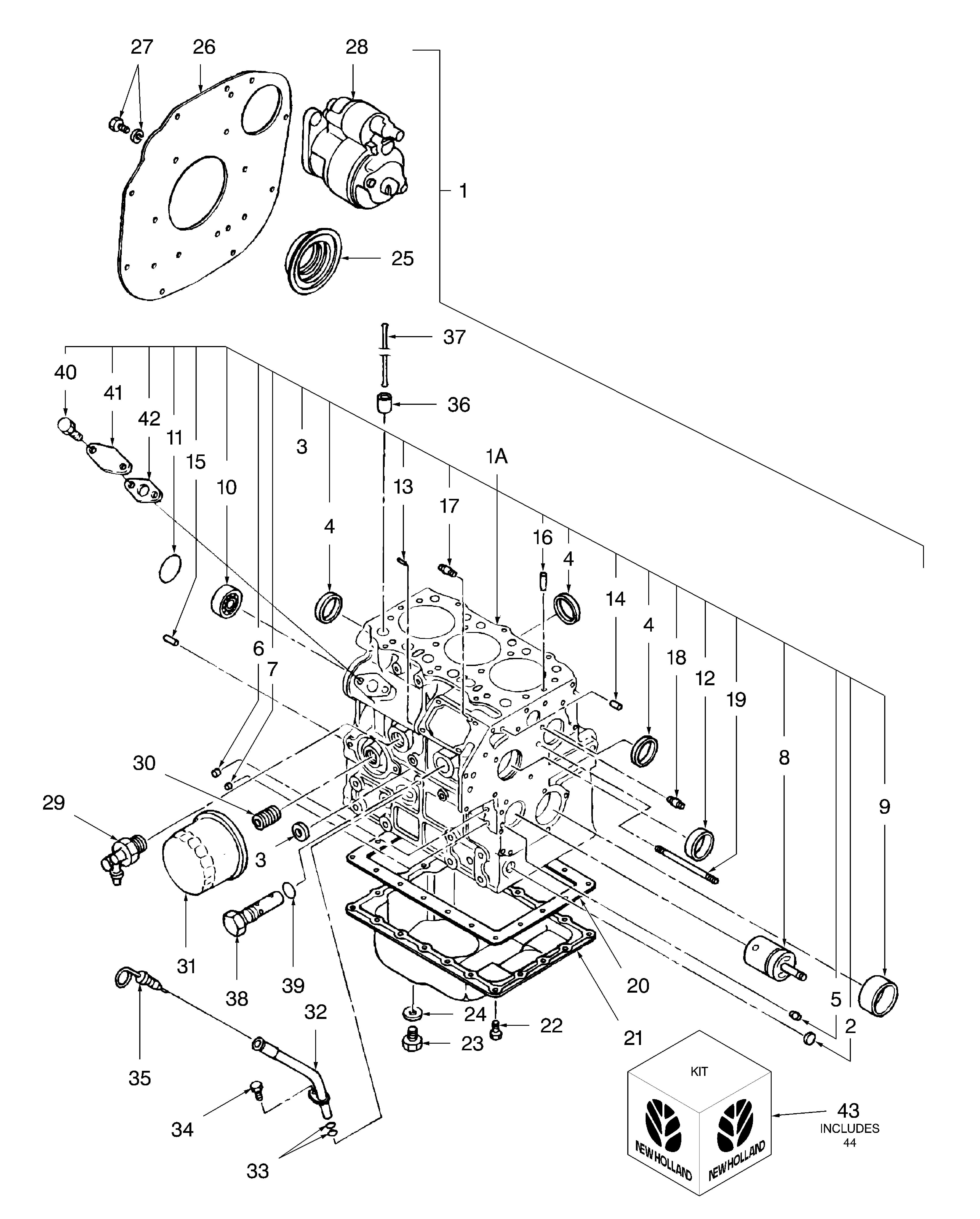

Due to oil leakage & clean area on axle indicating axle has moved out of axle housing I think rear axle housing needs to be removed to inspect axle brgs. It's possible nut(item 21) has backed off.
Thanks for your reply. I was coming to a similar conclusion as you and I just don't have the time to do this and possibly don't have the skills 😄 I found a New Holland dealer about 40 miles from me, I'm going to take it in and have them repair.
   / Creaking and popping noise New Holland TC33D #8
Probably the best bet as you need to access the back case to access the nut. Not familiar with NH compact tractors but on my bigger Kubota's the rear pto carrier casting is removable and that allows access to the rear gearcase.

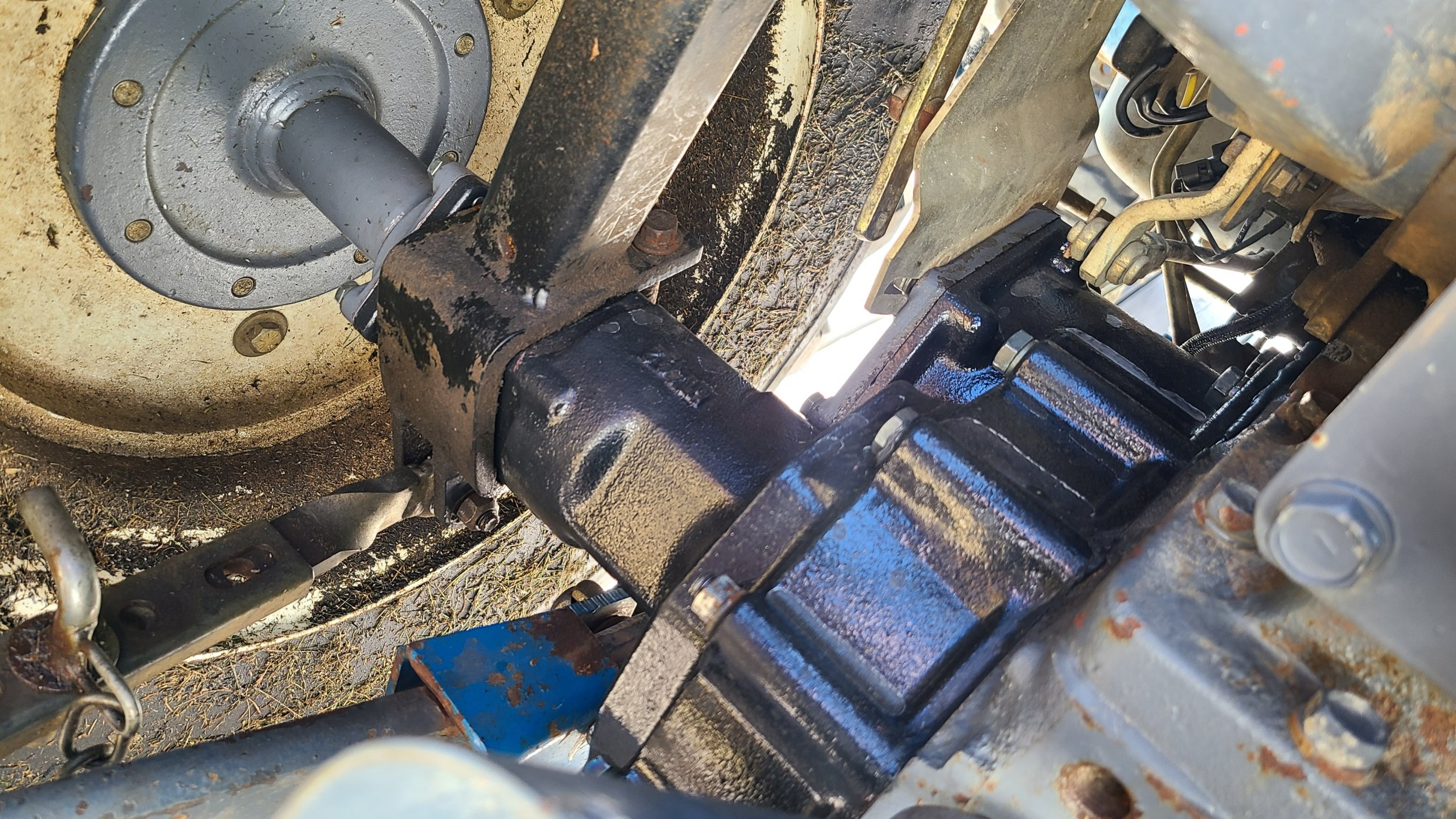

Update: had my machine repaired at a New Holland dealer. New transaxle housing, bearings and seal. Expensive repair but glad I have it back and also glad I didn't attempt 😅
