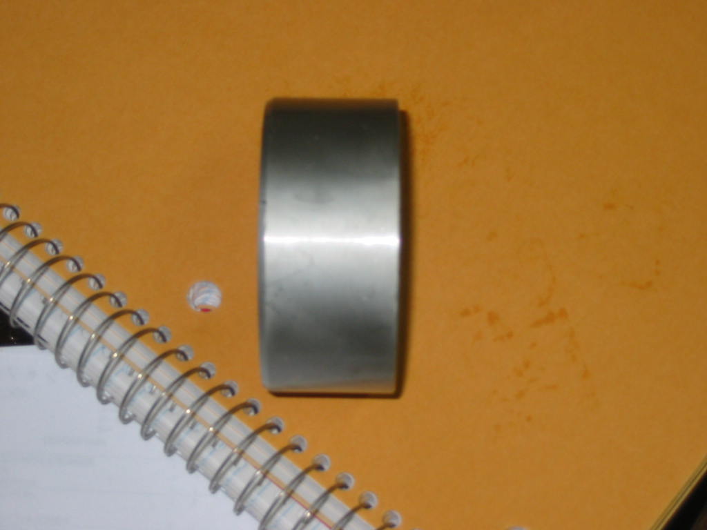

We know there are no caps, I'm talking about the bevel on the bearing. I've seen several installed backward and locked up the engine.
Danny
Danny
OK. I hope to never have to rebuild my Yanmar, but I'm curious.
How does the crank go in the block with out caps?

It has a solid front bearing that presses directly into the front of the block. The back of the block is bored so that you can slide the crank through it. Then the large bore in the back has a piece that holds the back bearing that slides in and fills the large bore and locks the crank in place. I hope that makes some since and i hope that you don't have to rebuild you tractor either. The guy I bought mine from just took very poor care of it. (clogged radiator, cracked block, spun rod bearing, no antifreeze in the radiator, and so on.)

Thanks. I think I got it. The front of the crank is smaller then the rear. There are caps in the middle and there must be a larger journal at the rear. Seems odd but I'm used to regular engine design. Almost sounds stronger since there is no cap or bolts at the front or rear.
