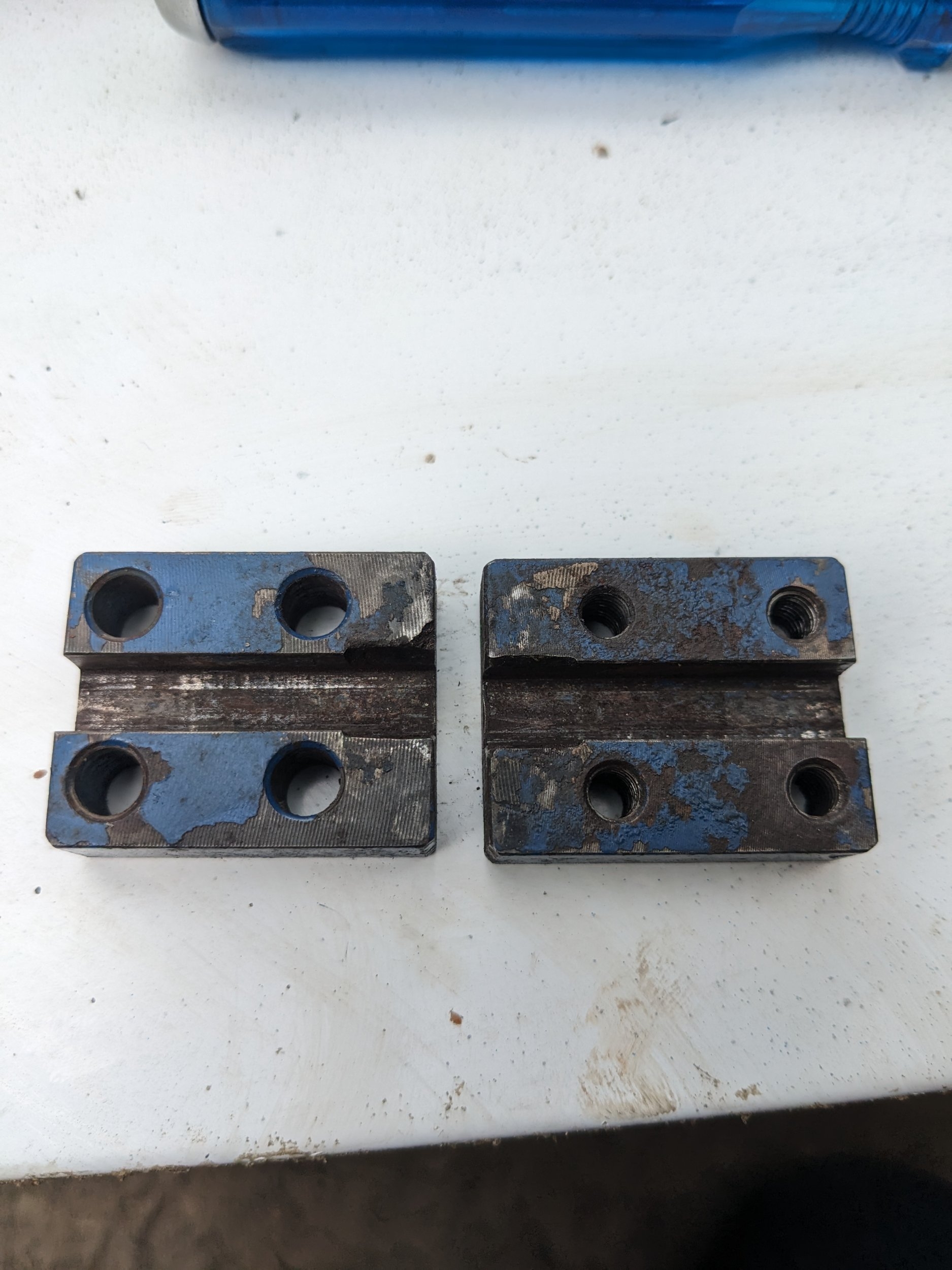

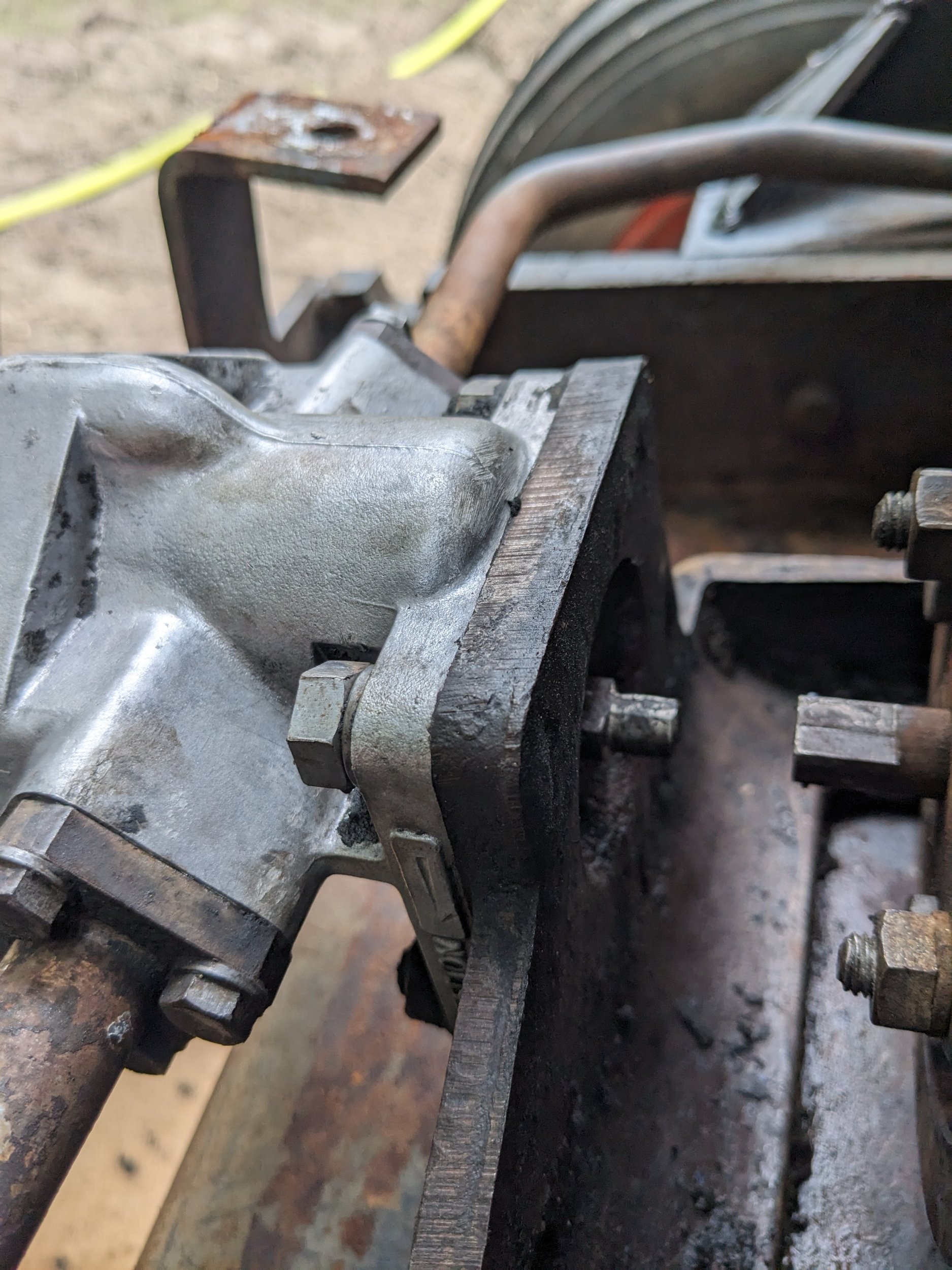

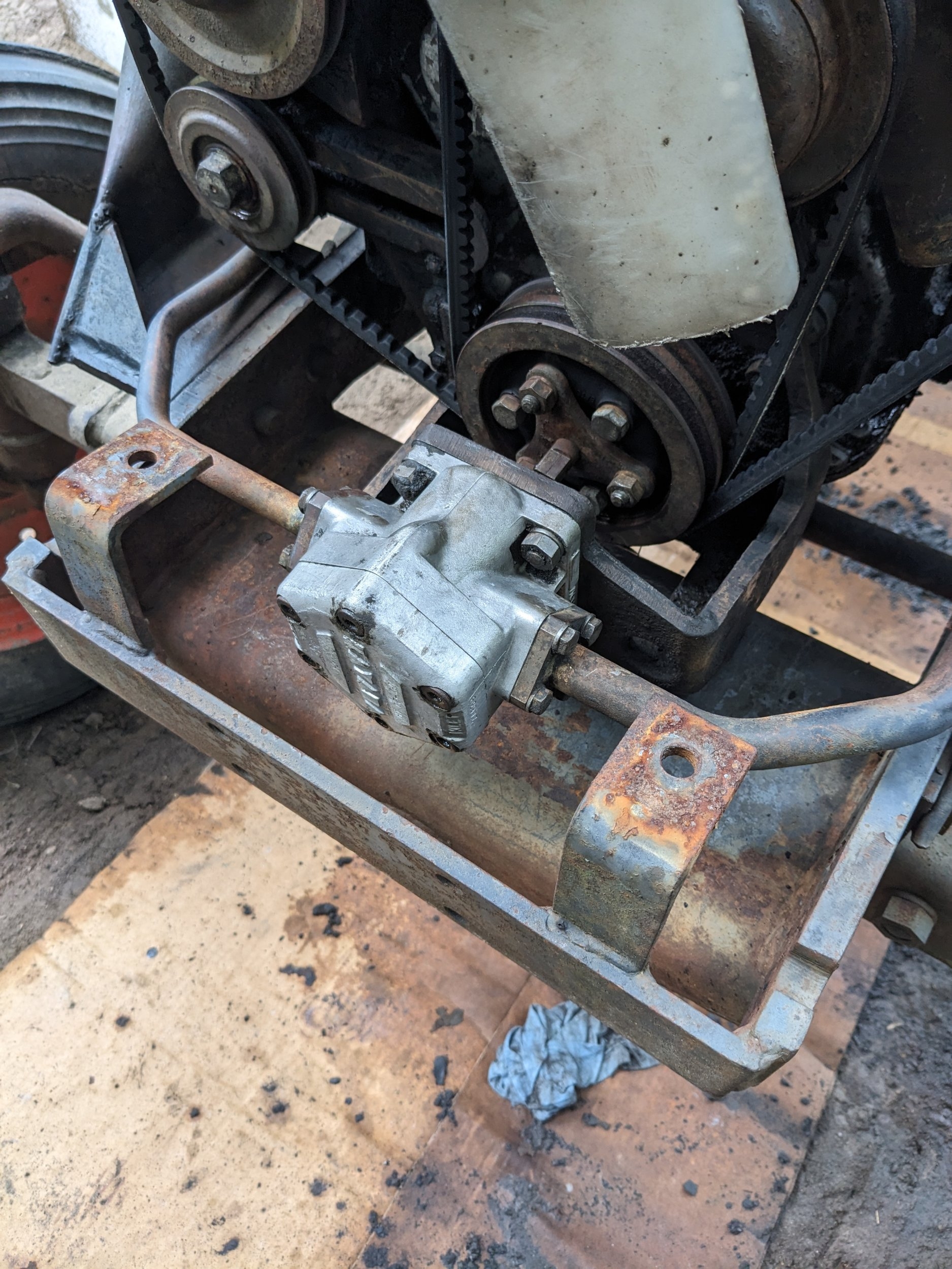

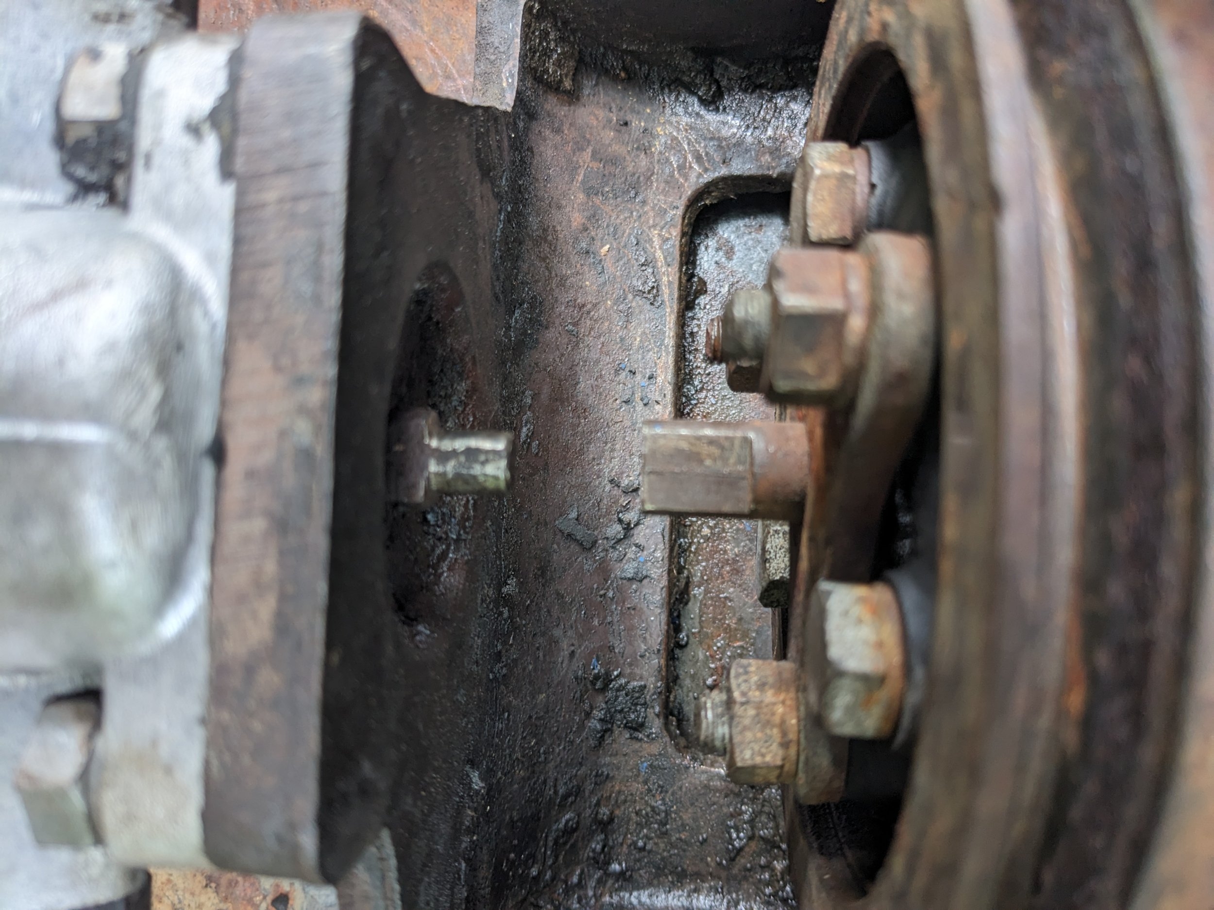

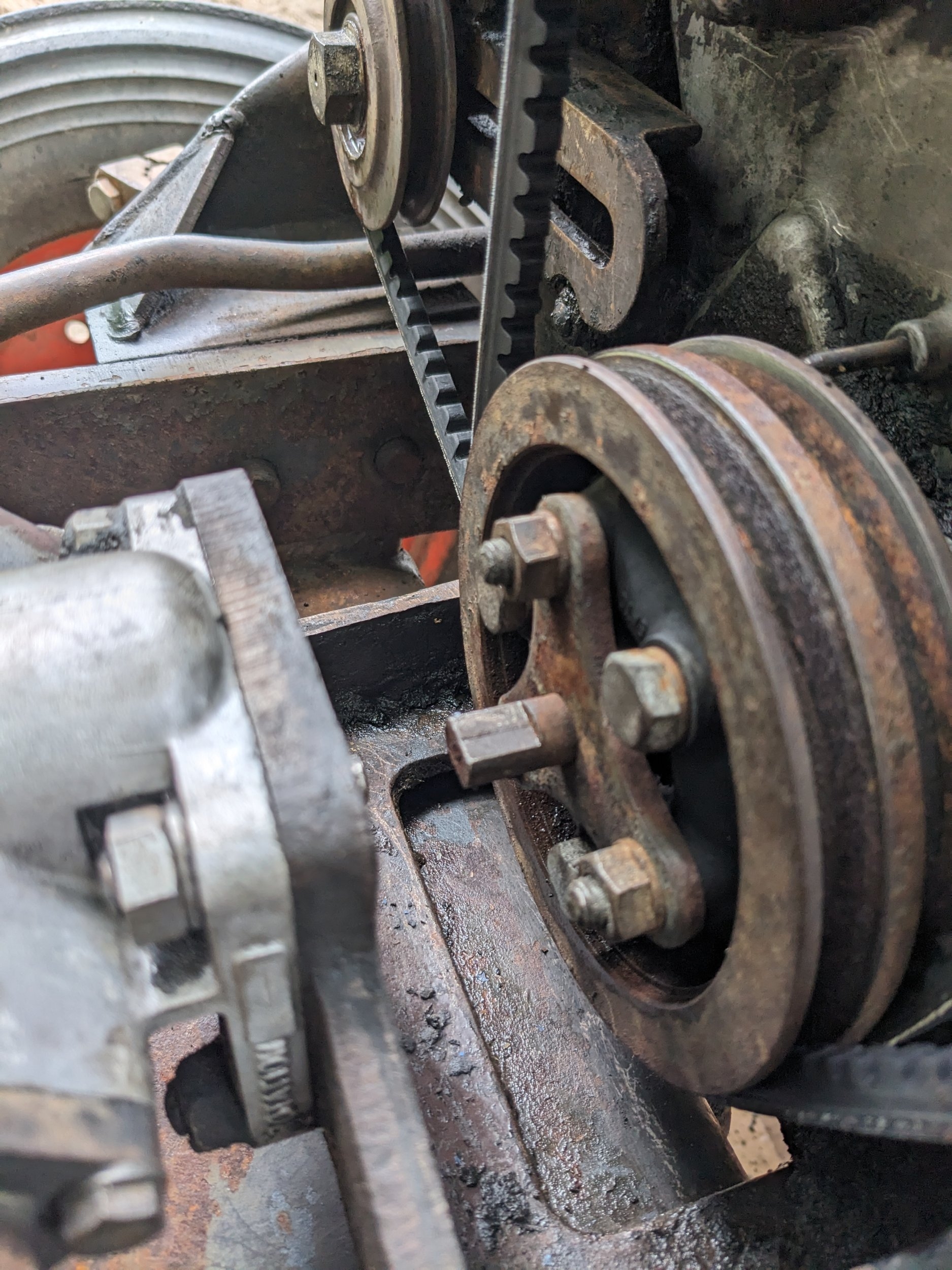

Hi Guys,
My Satoh 650g has possibly the worse designed crank to pump coupler ever. It is 2 pieces of metal stock with a keyway and then 4 bolts to hold each half together. The crank adapter and pump both have a "double D" shaft. Problem with it is that the end that holds the pump shaft only grabs just over a 1/4" plus the bolts are not right down the end due to the pump body. So less than great clamping, right where you need it.
So what happens is it gets chewed out and then hydraulics no worky :mad:I have seen many owners with this same problem and the one I saw who fixed it jerry rigged a love-joy style coupler. He was just using the set screw to bite into the flat. No idea how long that would last. And obviously his pump shaft was not rounded.
My pump shaft has rounded itself so I need a new pump. I don't want a replacement pump as they are only 4.1 gal/min. I also want to add power steering with an orbitrol valve so this curse hopefully turns into a blessing(with your help).

I wasn't able to work out all the details. So I welded up the damaged coupler and repaired it. I filed the flats on the pump shaft and had built up the coupler slightly to account for the shaft.
Works like a champ again. I've parked it and am going to sell it on or part it out. Not going to sink anymore funds into this old girl. I'm in the market for a newer 4x4 35-45hp machine.
