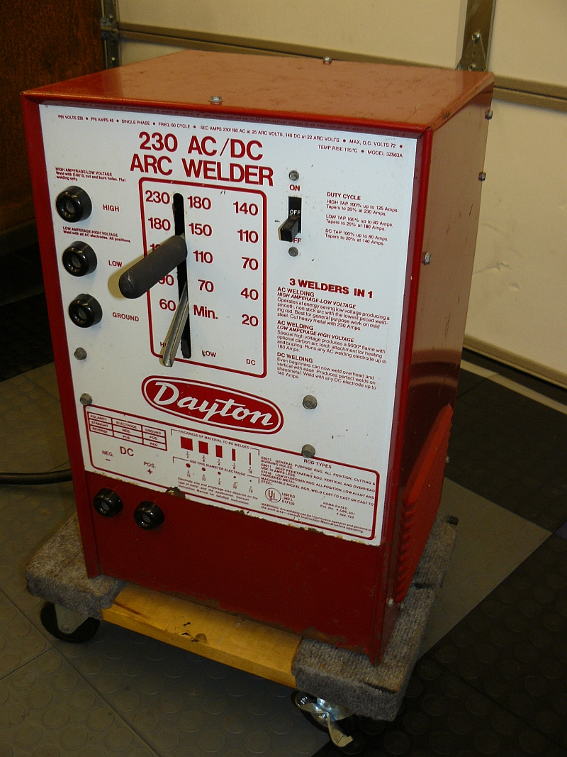

So I had some time on my hands Thursday afternoon....and I was sitting on the sofa with the laptop and the dog next to me looking around on Craigslist. My "buzzbox" is AC only, and I've read about the "joy" of DC stick welding. But, I really don't have that much welding to do and I can't justify buying a new welder just to have DC. I didn't expect to find much on Craigslist because as we all know, most stick welders for sale are usually AC only.
Low and behold, I came across one only an hour's drive away - a 230 amp AC/ 140 amp DC Dayton welder. Didn't have cables, but that's no problem since I already have a set. I just needed another set of lead plugs since I wanted to keep my "custom" set for the Marquette's non-standard size - $22 for the pair. I brought my DVM along to check the welder outputs and it was fine. Sold.
Price - $108. :)
It was made in 1988, assembled in Mexico, and aluminum wound. Nicely built unit, but not as solid as the Marquette. Haven't lit an arc yet, but that's next.
First picture is the Marquette. It's pretty f-ugly, but works fine. It was a lot worse before I stripped it down and cleaned it up. Second pic is the Dayton. It's really clean. I'm rather pleased, hopefully it welds as good as it looks. I'll have to build a cart/running gear for it, so that will give me a nice project to weld.

Update: Tried a few rods tonight with some various settings. The welder has an interesting setup of "high voltage-low current" and "low voltage-high current" taps, and recommends the low voltage mode for 6013. It does seem to make a difference even when both modes are set to the same current (of course who knows if the setting marks are accurate). I had a lot more success running 7018AC on AC tonight, but still need practice on that particular rod. The Marquette welder won't run it worth poop.
Then I tried DC. Ummm, WOW! I ran some 6011 on DC+ and I was amazed at the penetration and heat I was putting into the 1/4" plate. The arc practically started itself, was quieter, and much less spatter. Totally different welding experience. It seems that unless I need more than the 140 amp capacity of the machine on DC, I'll not be using AC anytime soon.

Use the high voltage, low current setting for the 6010/ 6011's. That'll help burn those better.

Mark - you are correct - I tried the 6011 on the low voltage side and it did not run nearly as well, and vice versa for the 6013.
