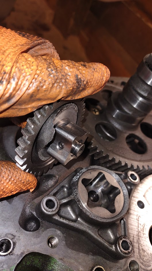

I would be very grateful for any insight into how to find out why my engine blew.
When we went to rebuild the engine we noticed the oil pump had broken! Now we are faced with a major rebuild.
We use this tractor for a food ministry to the poor and sick (cancer patients whos doctors have them on a nutrient dense diet).
All the food is giving free of charge and we have been blessed with amazing production.
I would appreciate any resources on rebuilding the engine. We are sending the crankshaft out to have the services ground. I am not sure whether or not to rebuild the head. The valves look good.
Please see photos below.
THANK YOU IN ADVANCE !

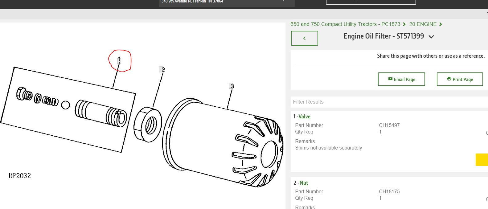

I'm guessing that either the oil pressure relief valve is stuck or you are using a very thick viscosity oil.
   / Cracked Oil Pump Housing on John Deere 750 from 1982 #4
If you go to the next page in the parts book it shows a picture of the oil filter. The piece marked 1 with the plug and a spring is most likely the pressure relief valve.
