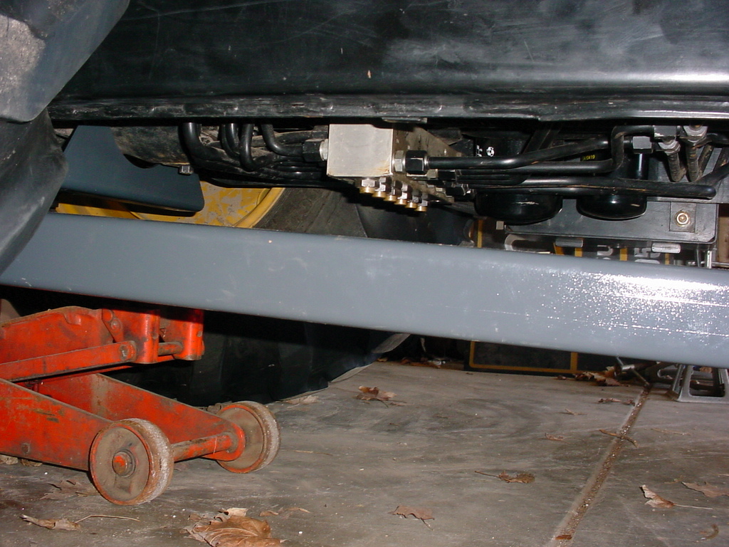

While I was looking at the cracked bell housing on the 2006 JD110TLB which was just on one side incidentally, the thought occurred to me that perhaps it was torque that caused it, a twist to the frame perhaps from some cowboy who maybe worked it too hard with the bucket out perhaps. I phoned the owner and he said one rental guy managed to turn it over on its side probably by the outrigger diving into the soft mud. I just crawled under my Kubota 4850 and noticed an extremely heavy(about 1"thick) cross brace linking the frames . So I started to design a similar frame for another 110 I am looking at which has 2880 hours but no cracks. I also noticed that there is a whole network of steel hydraulic lines that are hanging out there in the open just ready to snag on a rock or tree limb and I think I could design a skid plate which might even double as a cross member frame brace. It looks to me that these Deeres should have had a skid plate from the factory. What do you boys think of this bright idea? I have a nice new lift in my garage which would make the job a lot easier.

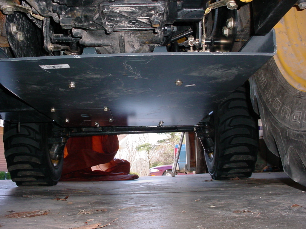

Soon after I bought my 110, I ordered and installed the Skid Plate from G.M. Manufacturing (I had to order it through my JD dealer). The main reason I wanted the Skid Plate was to cover up the hydraulic lines and filters. I don't think the Skid Plate would help prevent a cracked bell housing.

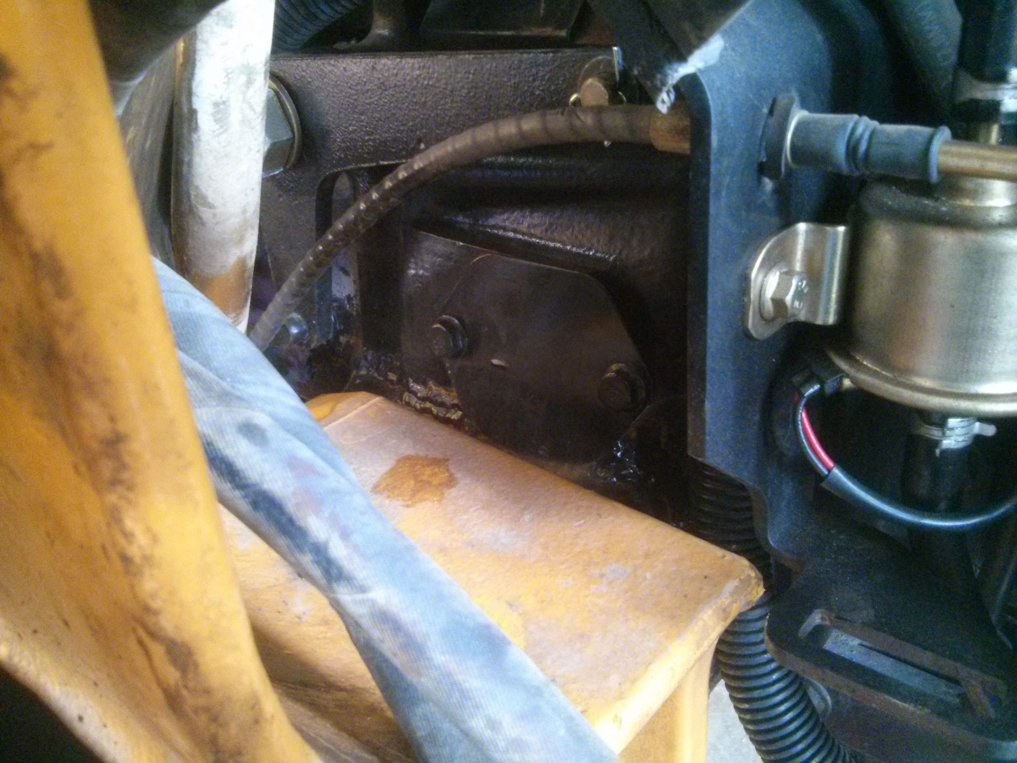

cracked BH 100 JD.jpgI took quite a few pictures but it is a little hard to see. If I was good with deese compooter/phones I could put little red arrows. I will try to post a few however.
