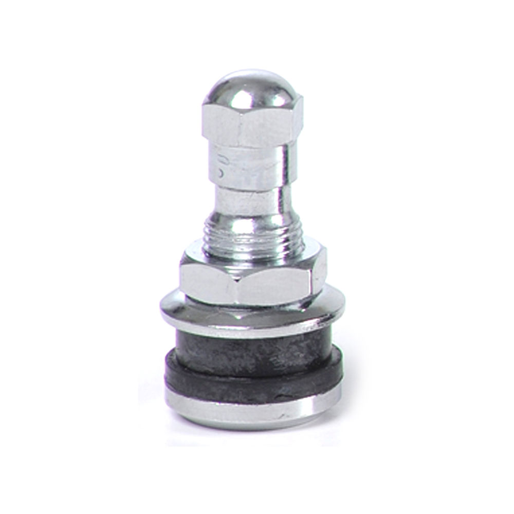

You can use heat to thermally weld the crack....
Or you can cut the fitting off and drill a hole, then use a bulkhead connector and bolt it through the hole... Even a metal valve stem with the 'rubber' washers bolted to it will work perfectly.
remove the schrader valve and increase the ID if you want... you can fish it into position using a length of wire.... KennyV ValveStem.jpg

GREAT Stuff Ya’LL; Mowed some more today with the “stuff repair” in place lost not one drop! Might just wait till late fall and try and install a new tank then…
