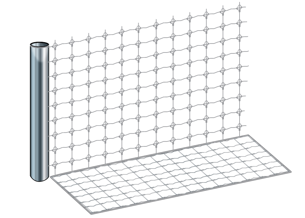

I'm still clearing my land for my fence, but it's raining today and I'm taking the day off, so I'm researching ways to keep coyotes out of my land. The most common way that I've been told is to install a predator fence on the ground outside my fence and tie it together like shown in this picture.
The problem that I have with this is that I have to put my fence inside my land 3 feet, or whatever the size of the fence is that's flat on the ground. That's really not that much in the grand scheme of things, but I really hate the idea of doing it. Where my fence is going, there is a gas pipeline on the other side, which is constantly mowed and kept clear of any trees for a 50 foot width. Nothing is going to fall on my fence along the pipeline.
What I'm thinking and wondering about is if I can bury the fence. I own a diesel ditch witch riding trencher with a blade on the front. It goes through the ground like butter. If I trenched down 2 feet the entire length of the fence, used longer poles so I still get them several feet into the ground below the trench, then put a 3 foot 12.5 gauge galvanized fence 2 feet into the ground with a foot of it sticking up, then installed my fence along the side of that with a foot of overlap, will the fence in the ground last? I've seen old cyclone fences buried in the ground for decades and all they had was surface rust on them. Still very strong and able to be used as a drag behind my tractor for years and years. I finally got rid of it because I came up with another drag that didn't catch every stick it went over.
Coyotes are a huge problem. Keeping them out is my number one goal. Maybe more important then keeping my animals in. I know guys who have lost 40 fawns in a week from coyotes!!!!! Others deal with a dozen or so losses a year. I want to take the time and spend a little more to make my fence 100% coyote proof. I don't think they will dig down 2 feet, then go farther under the fence and dig back up again. That seems to be too much for me to believe it will happen.
The question is will the fence in the ground last and be able to stop anything from digging through it down the road?

Coyotes are pretty determined and inventive. Might be better to bury the fence horizontal along the edge of your vertical fence to deter digging altogether.

Eddie Your idea along with a hot wire on top sounds like a winner to me. I would go for it. Ed

I'm thinking that if I bury something like this 39" Stiff-Stay 12-1/2 Gauge Field Fence upside down so the smaller sections are up and above the ground, I make it even harder for anything to get through the fence. The 8 foot fence also has much smaller spacing at the bottom, so overlapping them should be about as good as I can get. Then the bigger spacings would be buried in the ground down two feet. It's 12 1/2 gauge, which is the same thickness as chain link fencing.
rgr33, Thanks, that's what I was hoping to hear. I have no idea how deep a coyote will dig, but two feet seems like an aweful lot. Then to go farther under the fence and dig back up again just seems like too much for them.
I've read that they never use the same way under a fence twice by guys who trap them. They say that the best way to trap coyotes is to cut an opening in the fence for them to find, and use snares there to catch them coming in. I don't want to cut the fence. If wand when I find holes dug under the fence, I'm thinking that I will just dump a sack or two of Readi Mix concrete in there and add a little water. I will mow along the fence regularly, so I'm thinking that I should be able to see if there are any holes being dug.

EDDIE: your fence design is what you need. Dogs,coyotes, armadillos etc all start to dig under a fence right at the fence line so by laying your horizontal fence 2-3 feet back from the fence, they stop digging when they find the wire that they cant get thru. If you are concerned about rust out, put in chain link fencing which might last a lifetime. The last time I checked pricing (about 5 years ago) it wasn't much more if any to put in chainlink fencing compared to 4x2 net wire. The big cost for chainlink is the top rail, post and fitting. I didn't use any of that, just the chainlink fencing hooked on to metal T post. I put some of the heavy gauge wire (about 8 gauge) along the top and fastened it with hognose staples. I also ran a line of barbed wire on the bottom to discourage digging ( I didn't bury the wire like your diagram). So far it is holding up well.
