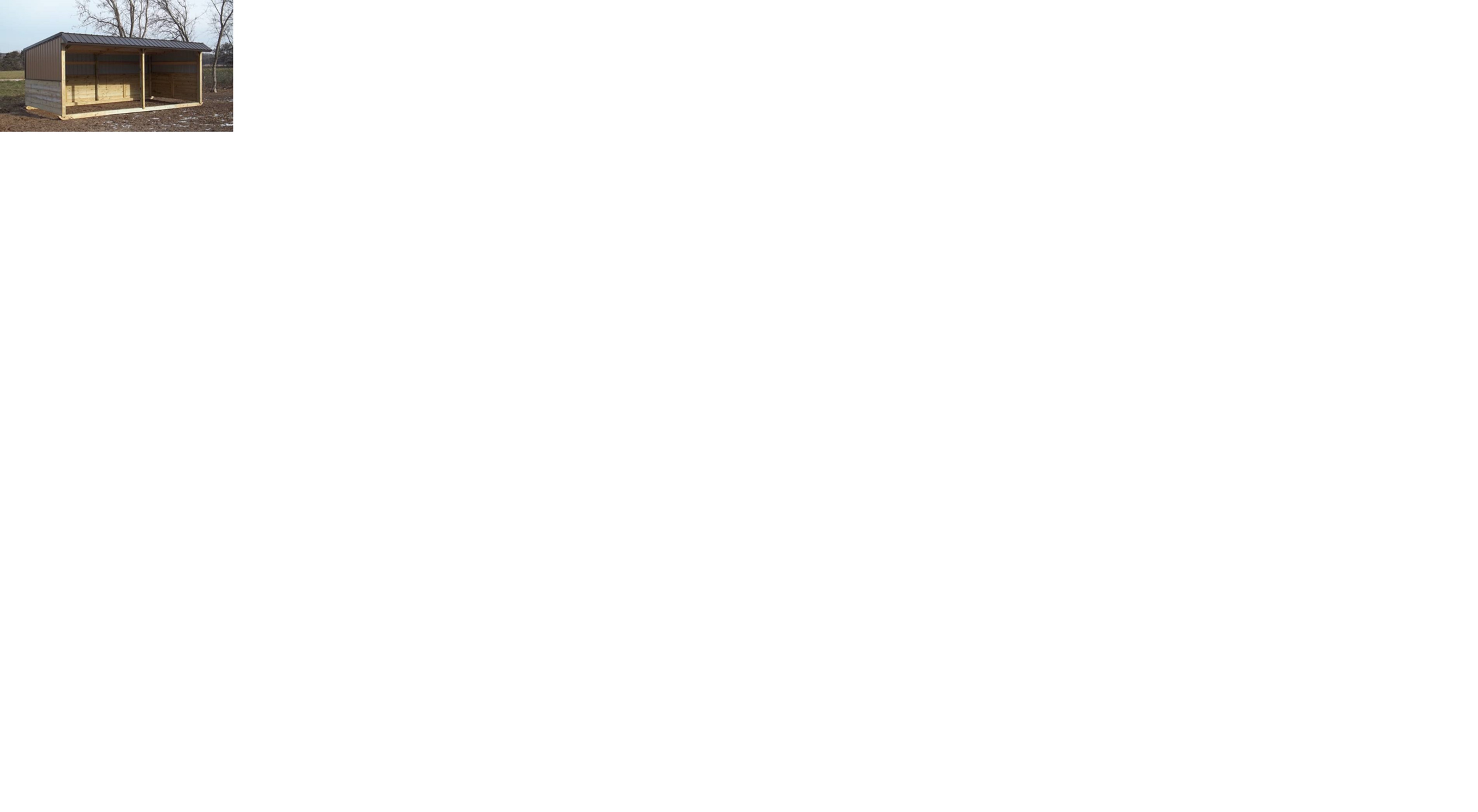

We started planting a 4 acre pasture last year in anticipation of feeder cows in the spring of '21. We will be buying 2 cows each spring and slaughtering them in the fall. Our local ordinances mandate that we have a lean to for the animals. At the same time, we have to get a building permit if we go over 120 square feet in size. I'm looking at thoughts for the design and building this within that size limitation? Also, I'm fully capable of designing this myself, but if anyone had any plans I'd take them! I'm thinking something like this:
I'd put a gate over one side and store hay and feed in it, maybe with a floor.
Thanks!

120 square feet is just 10x12. Just thinking out loud, I would build a stall that big and extend the roof out 12 or 16 feet for as much cover as possible.
What defines a building? Does it have to have four walls? Can you make it bigger if you only have three walls like a loafing shed?

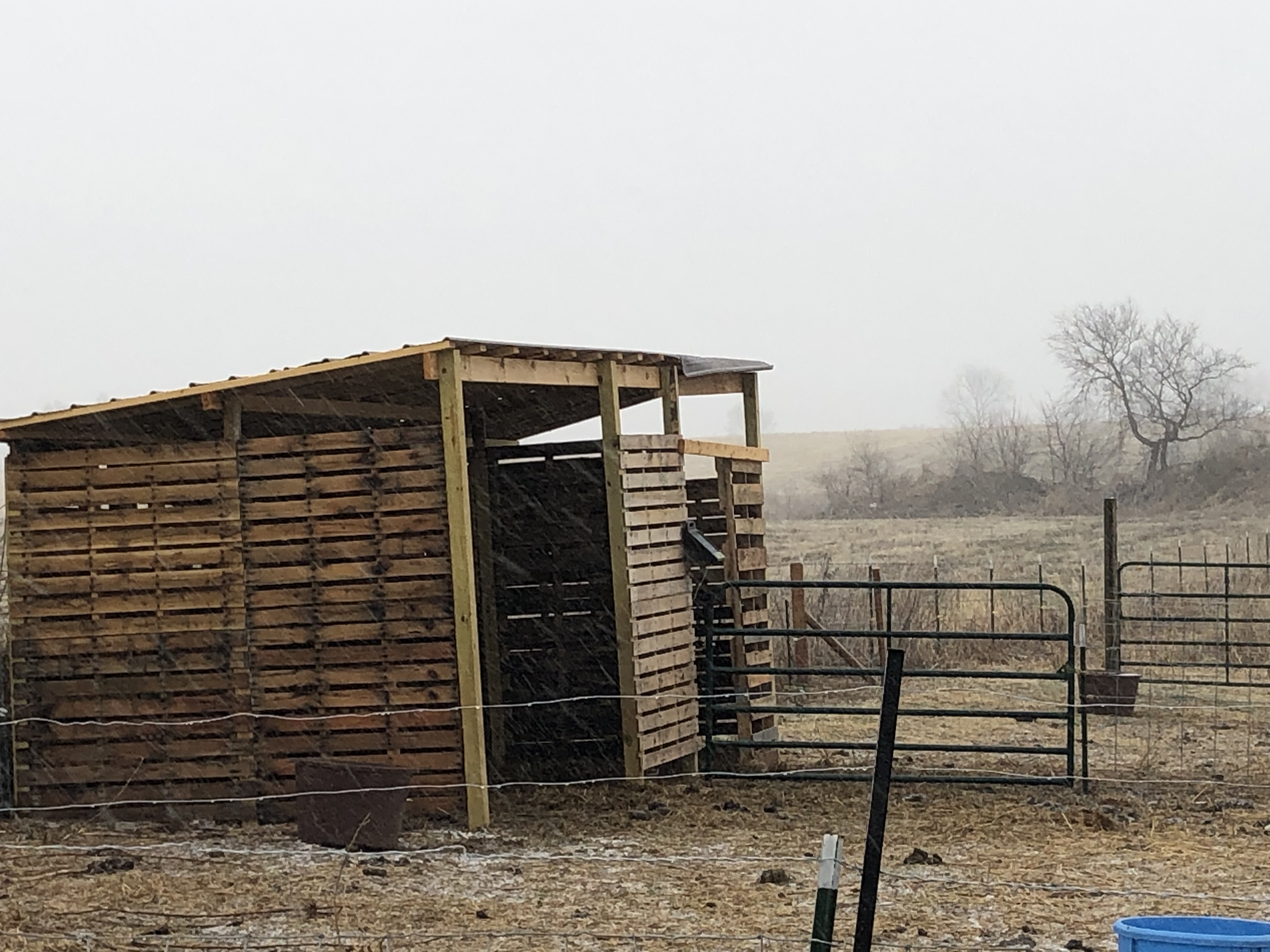

I made mine using pallets for the walls and posts between. Simple metal roof.

I think you need to figure out if you're gonna clean it out now and then and how you will do it? By hand and wheelbarow or tractor?
Where do your predominate winds and weather systems come from? I would want the closed walls to the weather side.
You might think of live stock panels inside of some sort of removable wall for cleaning. Those cows will rub up against walls and wreck em in time.
Don't use metal tin walls. nope nada negatory. They will ding em up, worst case scenario really wreck them and possibly cut themselves.
   / Cow Lean To / Loafing shed thoughts and plans? #7
What did you use to take apart the pallets without breaking the boards?
