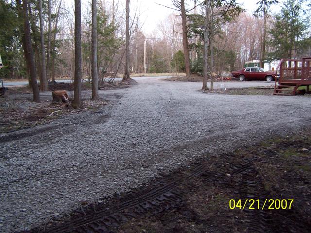

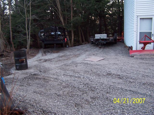

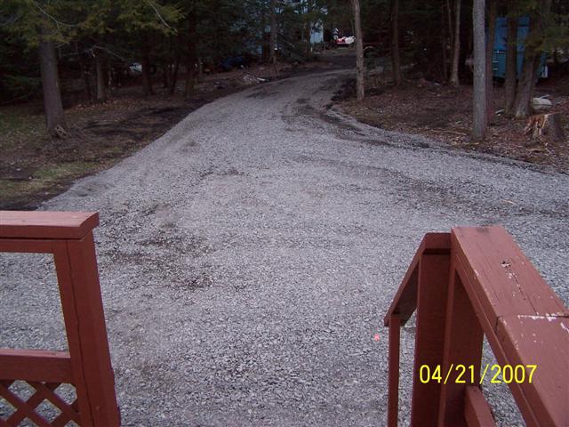

I just did my driveway areas with crusher run two weekends ago.
1 - 30' x 64' Driveway leading to garage (1920 sq ft)
1 - 28'L x 20'W for parking my trailers (560 sq ft)
1 - 10' x 250' half circle drive (2500 sq ft)
Totaling just under 5000 sq. ft.
I had 3 tandem truckloads dumped. Most areas I spread about 2-3" thick. The half circle drive got 5-6" thick since there was always a wet spot in the middle.
