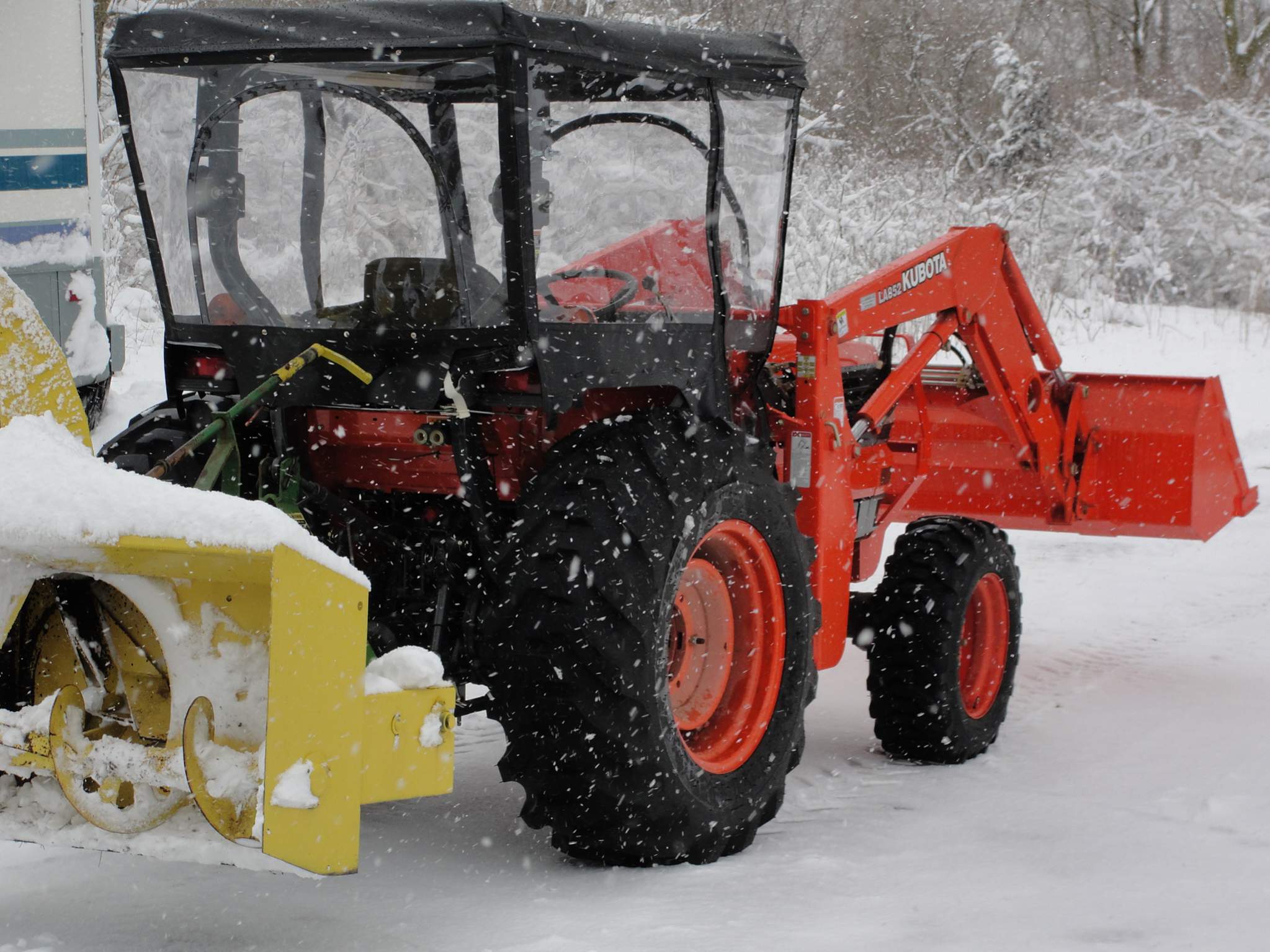

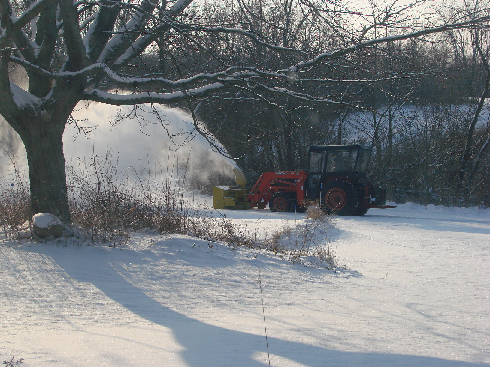

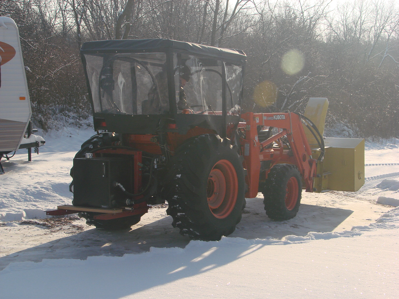

I have the "Cover My Tractor" Cab on my L4610 and highly recommend "Walt" and his people (Jacksonville, Fl). It is my 2nd winter with my CMT cab and am totally satisfied. The quality is excellent and the "StrataGlas" is totally clear. It fits within a fraction of an inch and keeps me dry and warm. We've had 11 degrees below zero here already this winter and I am very happy with my CMT cab. I need my tractor open for summer haying and this does the job in spades.
Pic 1 is last year and 2 & 3 show the blower on the loader a week ago (my present configuration). Not a flake of snow gets inside that CMT Cab. It has massive zippers that work. The seamstress sewing is extremely well done. And, lastly the style is that of an expensive equestrian carriage. I don't know how it could be done any better.

That actually looks pretty good for what it is. I actually just bought some clear vinyl to enclose my "cab" project, but I'm going to completely change it and make it a bit more permanent (instead of bolt on/off like I originally designed). Looks like the clear plastic works well though. Is the front "glass" hard or soft?

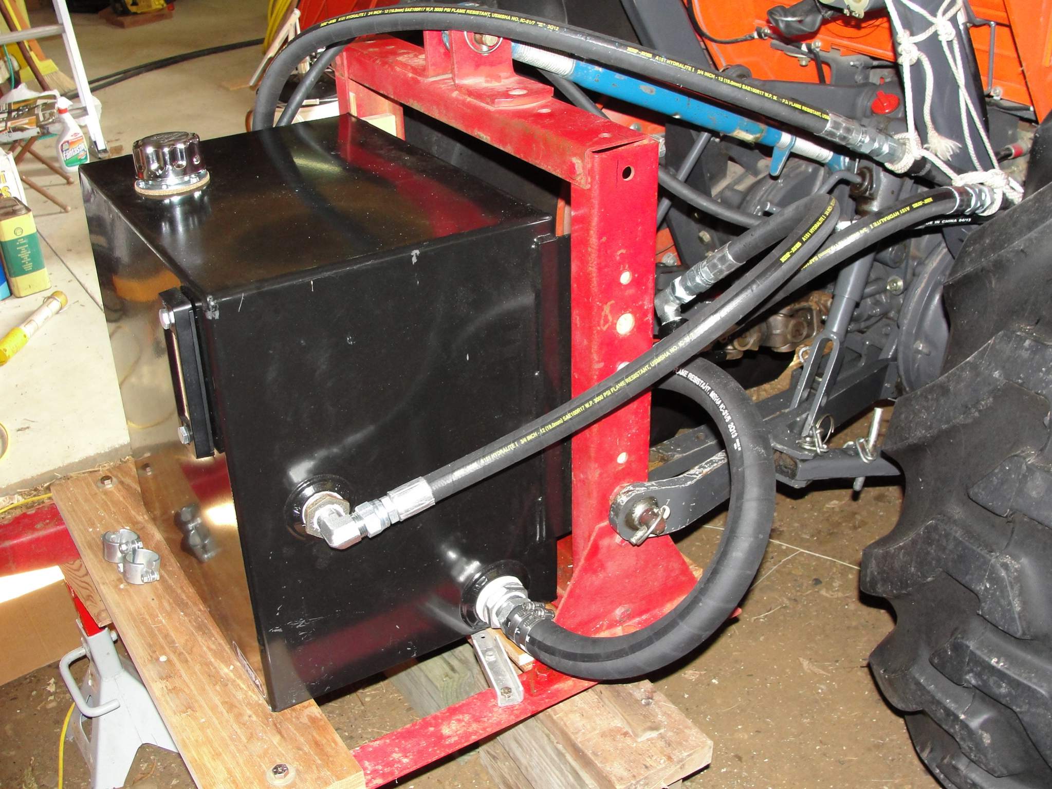

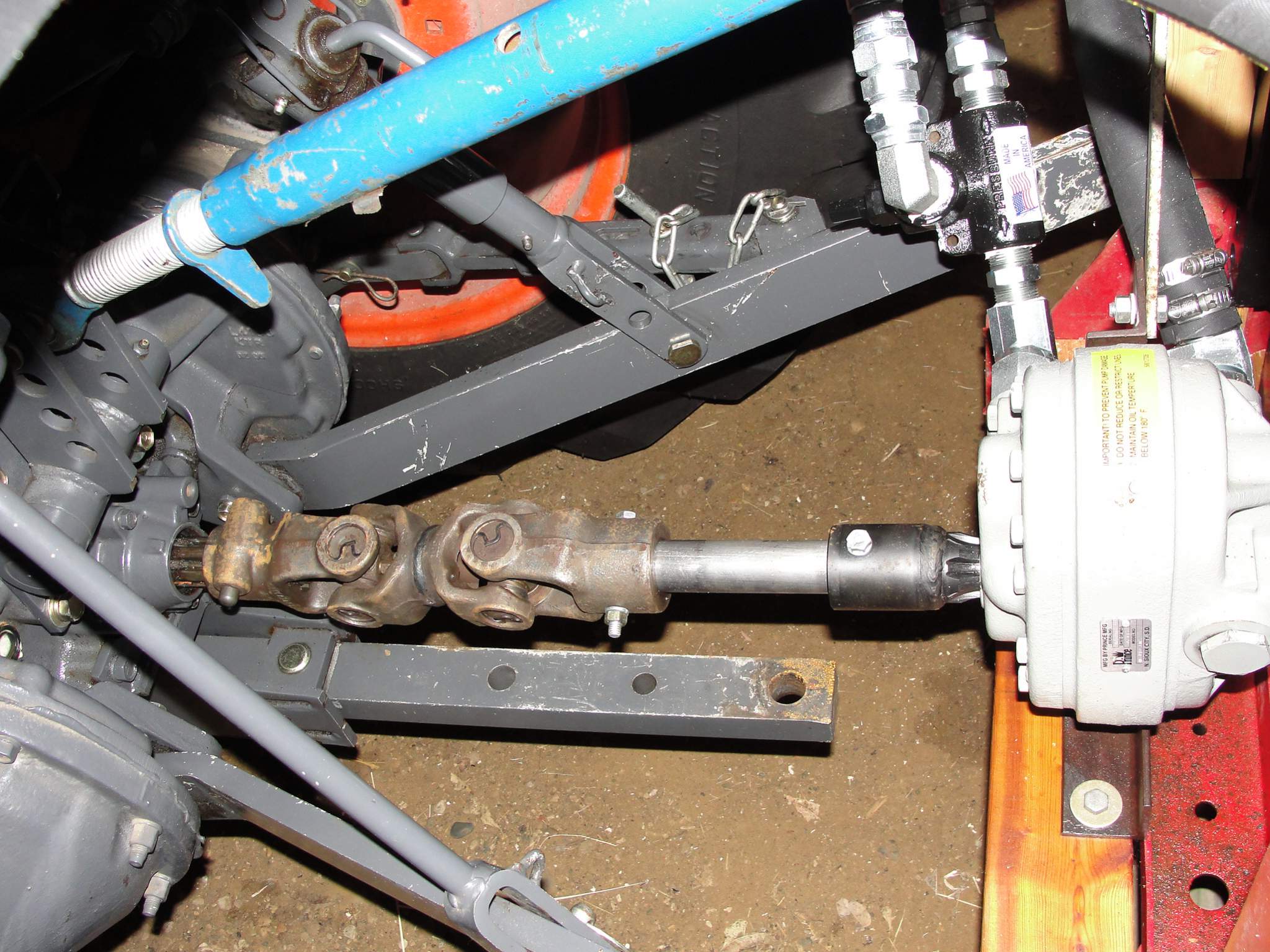

Also, what is that on the back of the tractor ??? A dedicated PTO hydraulic pump for the blower? Does the tractor not have enough flow to turn the blower?

My "Cab" is "StrataGlas" all way around.

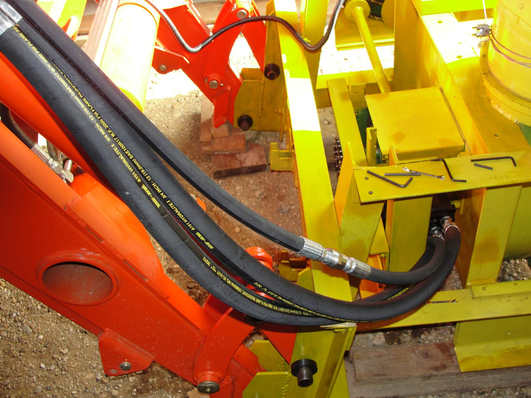

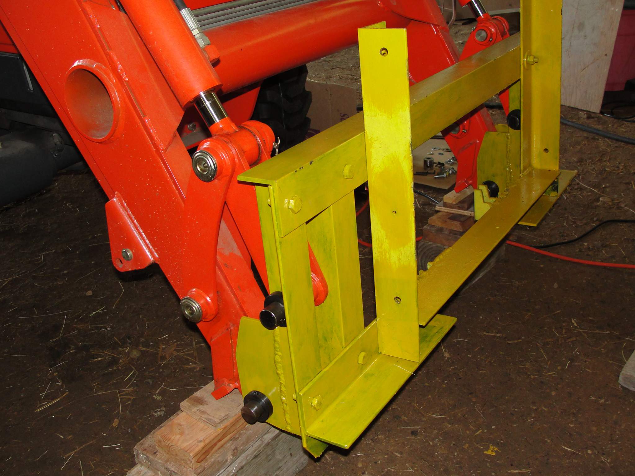

Yes, my DIY rear to front snow blower cannot run effectively on the Kubota's 10 gpm hydraulic system. However the independant PTO really makes it a simple job to power on-off a dedicated rear 20 gpm pump. Tank, relief valve, return filter and a 3/4" pressure line that goes to the blower's hydraulic motor are necessary. Provide a 3/4" return to the tank plus a smaller case drain line, some oil and your in business! I had earlier done the steel work to change the blower from a 3 ph to a 4 point "pin on" loader mount. There are no complex hydraulic valves or plumbing........................ you simply "turn on" the PTO to blow snow and "turn it off" when finished. It is a very simple system that works really well.
