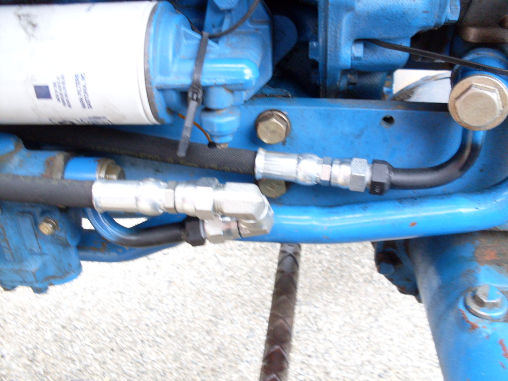

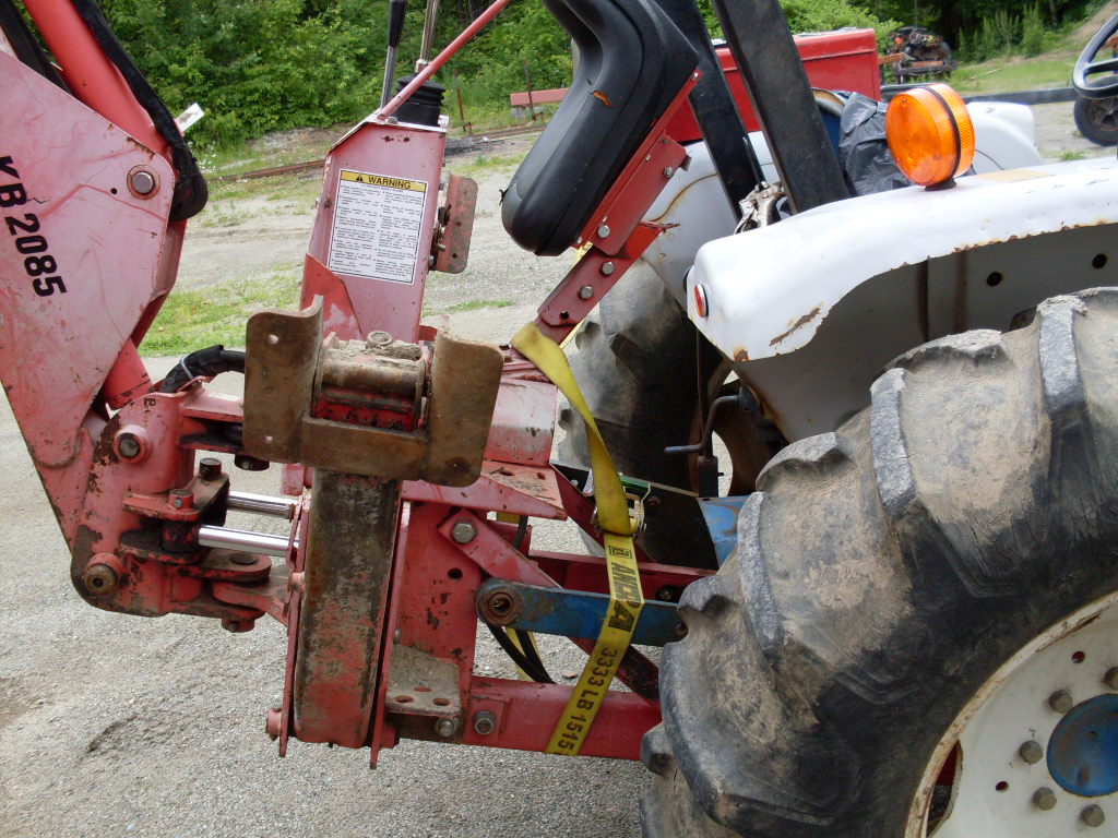

my cousin has a dk 55 w/ every attachment in the world including a hoe that sits out in his field looking lonely , I am quasi caretaker of the six hundred acres he has next door to me anyway long story short I have decided to put big hoe on my little 1910 for pulling out some small stumps maybe digging a ditch or two.
first step was cut main hydraulic line right after pump add qcs and run through backhoe to see if my tractor workede the big hoe okay, so far so good now just neede too makethe brackets to attach subframe to my loader subframe pics will follow

It's best for the direct line from the pump to be plumbed through a relief valve or an operating valve with power beyond before the first quick connect to avoid accidental dead-heading.
