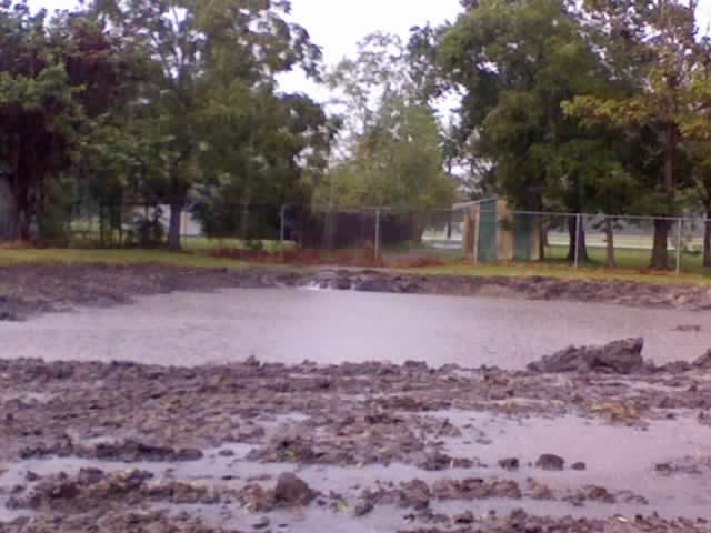

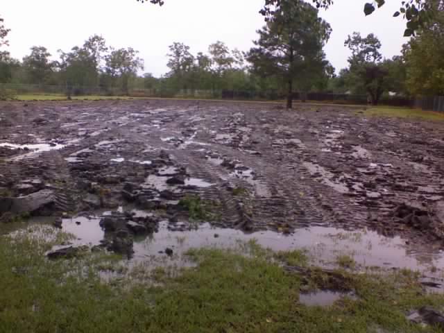

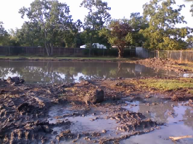

The pond project has come to a complete stop due to the rain and mud. Would a ~30,000 pound track hoe be good means to continue digging? My thought is I could a least get the pond dug now and spread the dirt later if/when it dries out.
About how long would it take to dig a 100'x90'x10'deep pond, I realize this could vary quite a bit with soil conditions etc.
The rental place tells me its very simple to run comparing to an jumbo version of my little BH75, any thought on this or would I be better off paying an expierenced operator who could get the job done quicker?
What is some of the going rates to rent a machine like this? I dont have the details of HP or bucket size yet just trying to get a general idea.
I attached a few photos to give a general idea what I am dealing with...
Thanks for any input, Chuck.

It's so hard to tell how much you have done with the water. It's also hard to tell without knowing the soil. The rental place is right as it's just a larger machine. I'd say if all goes right it should be done in a day but it would be nice to have a dozer to move the soil away while digging and have it over with. Save the finish work for your tractor.

Your looking at close to 3400 cubic yards of dirt give or take, with a 30,000 pound machine you might get a 2 yard bucket I doubt you will get it dug in a day. Your worst part will be you can dig the hole faster than you can get the dirt out of your way. Even if you had dump trucks moving the dirt for you it would still take over 180 loads to move it.

Thanks for all the help folks.. We just missed hurrican Humberto, but still got more rain that I did not need.

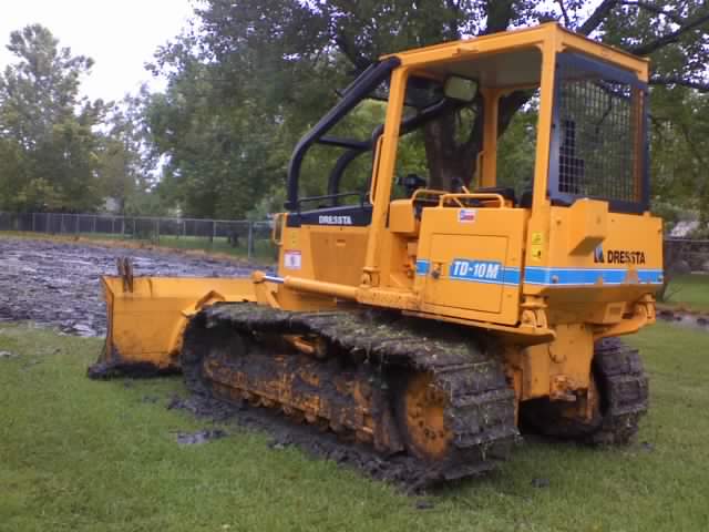

My thoughts where to rent the machine for 2-3 days while I am digging wth the trackhoe my brother in law would be on the TD-10 spreading the dirt and pushing it to the front of the property for a house pad.
I am quickly learing that SE Tx. gumbo has a small "window" in which the soil can be worked.. Too dry and its like pushing hardend contrete, too wet and the stuff will stick to anything, dozer blade, tracks and rollers it can be a royal PITA..
Until it dries out all I can do is wait :eek:

Glad to see you have the dirt moving logistics figured out. :D :D
Will you need pads for the hoe?:D
