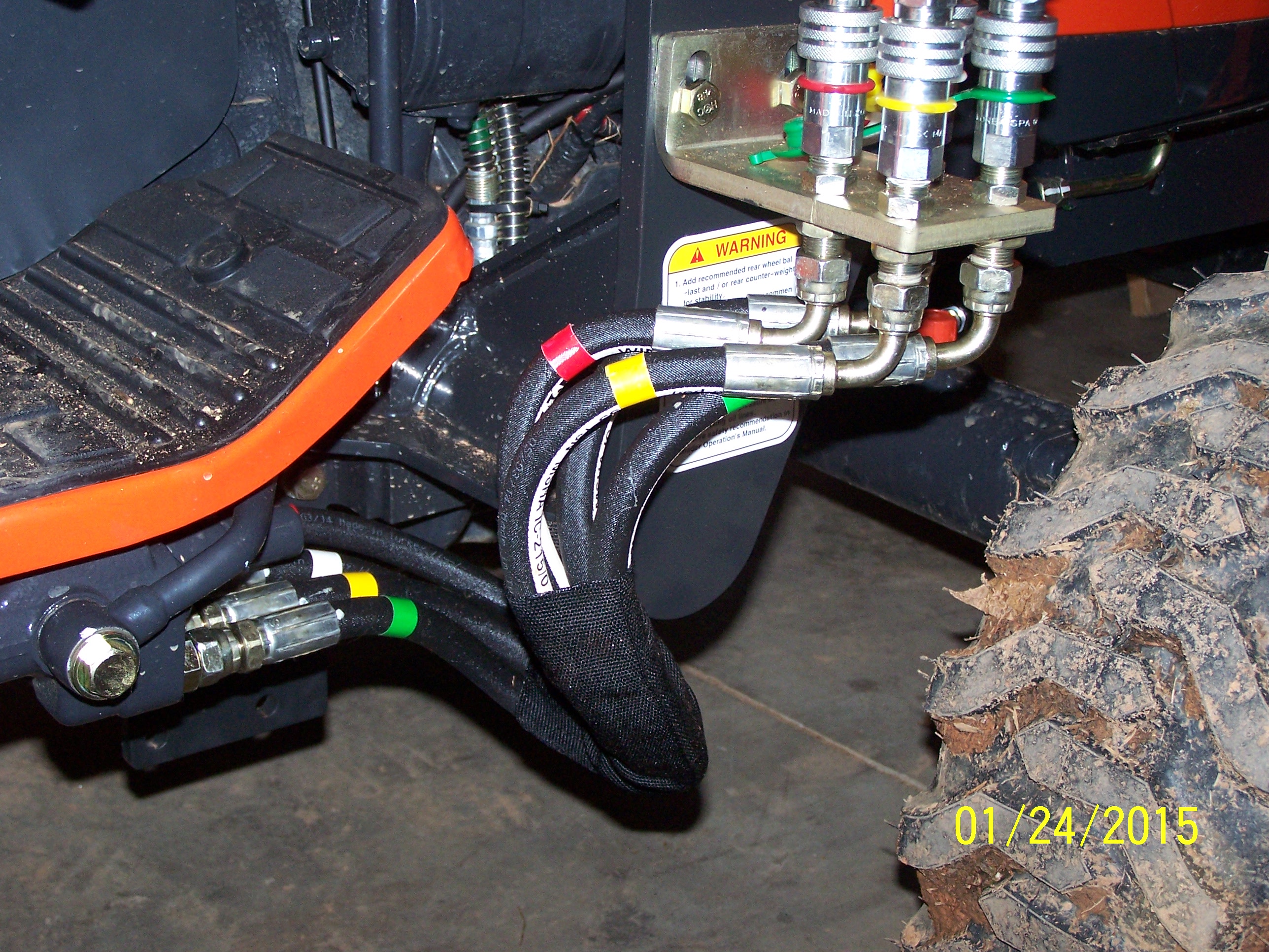

The 3pt. on my tractor is jerky when raising. Is this normal on this model? Its almost like it raises in very small increments instead of smoothly. This is aggrevating, especially when trying to raise an implement slowly. Is there an adjustment?
And also, is it possible to switch the hydraulic lines around, that are off my loader and that sit low to the ground? Well, I know its possible, just how do I go about doing it and how much fluid is expected to be lost? Thanks

Mine 3pt raises smoothly. I switched my lines around not much fluid lost less than a quart.

Yes that is what I want to do with my lines. Did you have to bleed the lines, or just work the loader up and down?
just work the loader up and down.
