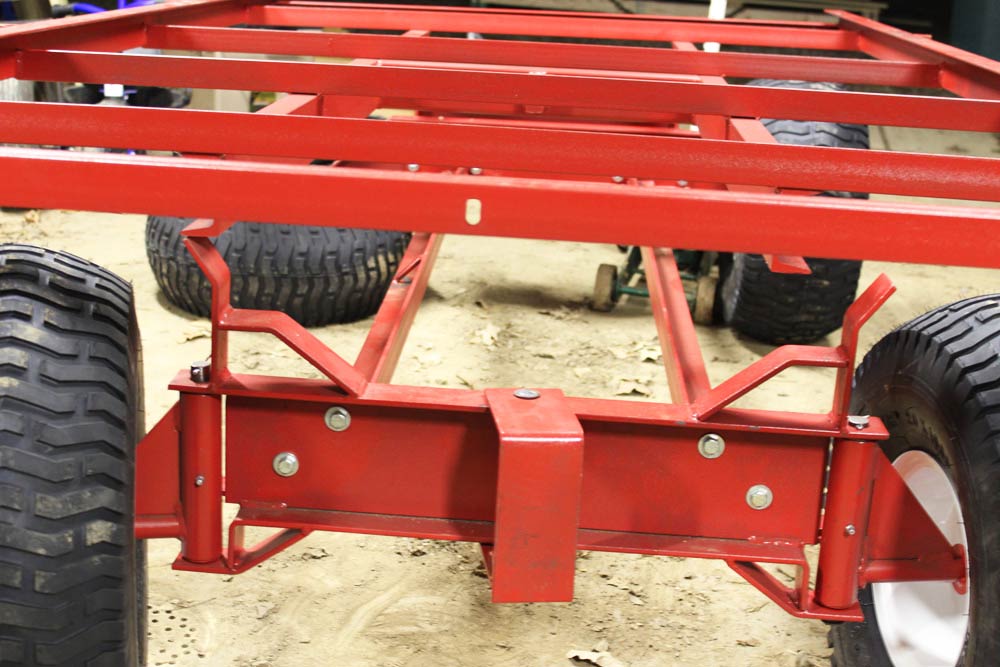

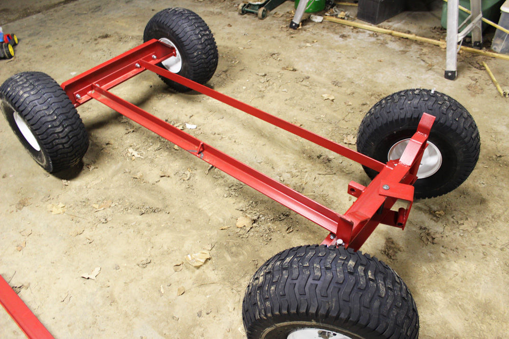

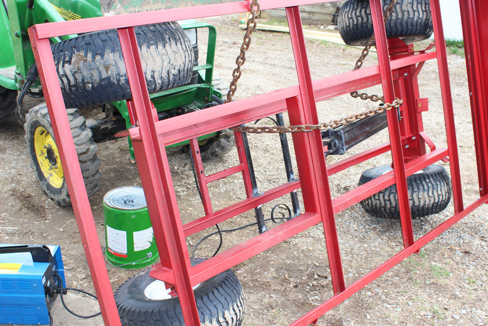

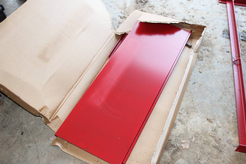

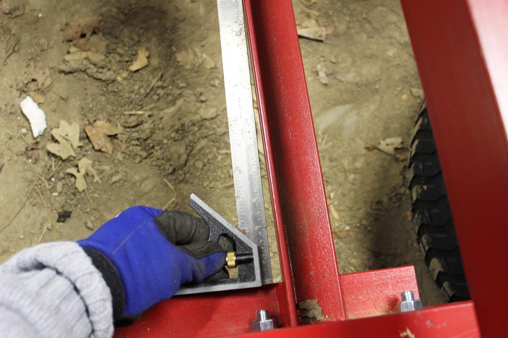

I received my order on Friday and immediately set to putting it together. I ran into an issue where the H frame is not square. This is preventing me from installing the dump hinge pin properly. The bed has to be twisted so far over to get the pin in place that the bed no longer falls between the two guides on the front axle. Also, it looks like on one of the end panels a strip of paint was sprayed on then the cardboard was placed over it while still wet.
I did contact the company and they were surprised to hear about this. They are sending out a new frame and have credited me for the panel. My experience with them so far is that they have been prompt and taken care of any issues.

I got the new H frame in the mail, it worked. The bed went on nice and straight with the new frame.

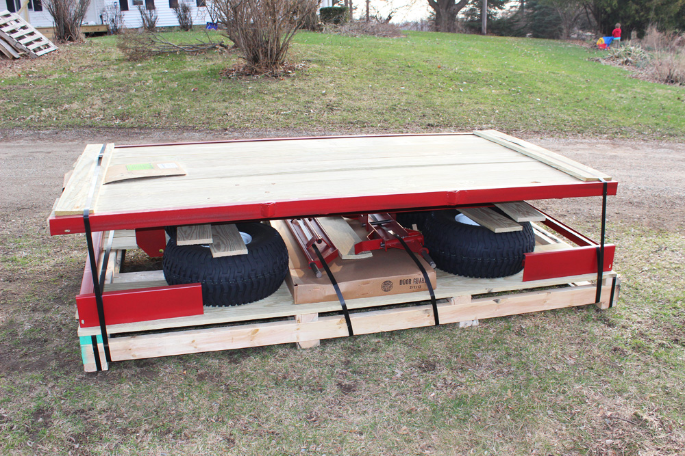

Here is how the unit arrives in the mail. Overall the packaging is great, however, the wife said her and the delivery guy had a heck of a time getting it off the truck. I was at work.

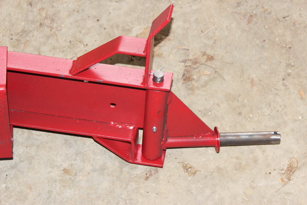

I guess they haven't updated the pin setup on the front axle:

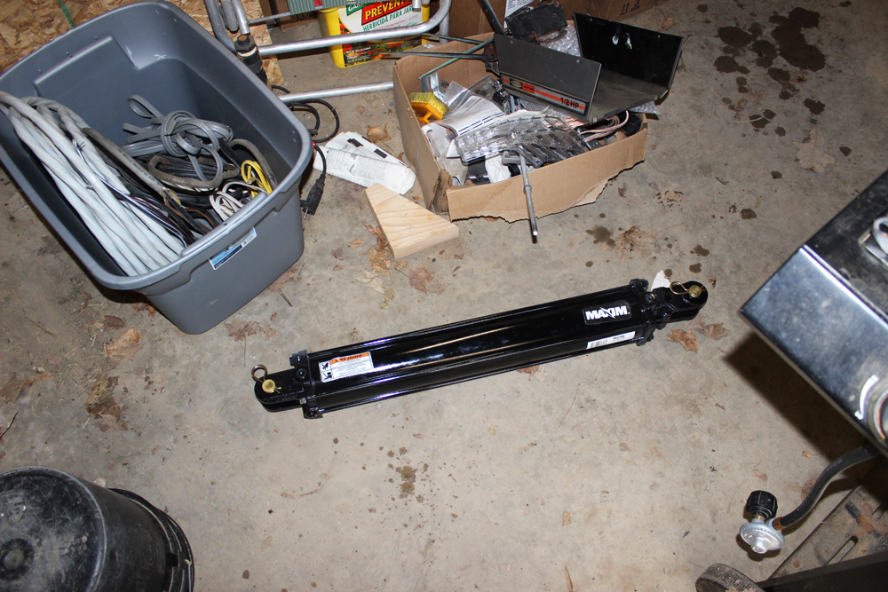

The build is going ok, I recently got the piston.. just waiting on the pump.
The piston is 3.5" x 24" 2500 psi.

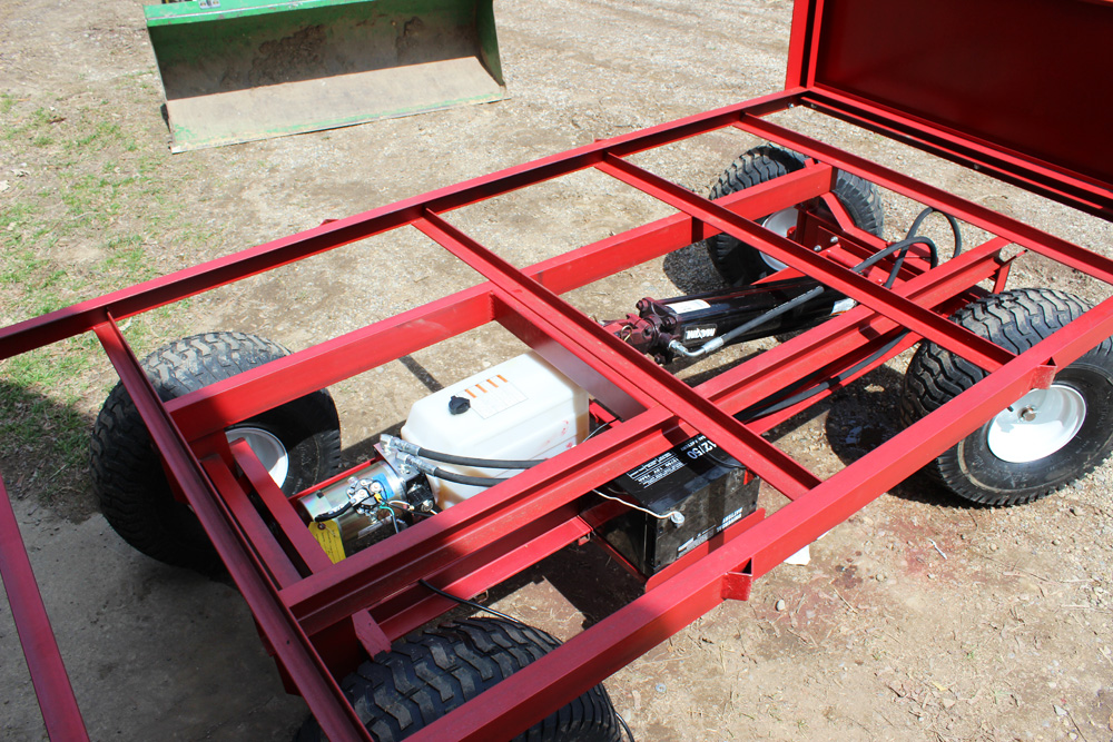

An update on the build.
I had a bit more time this weekend to put more of the system together.

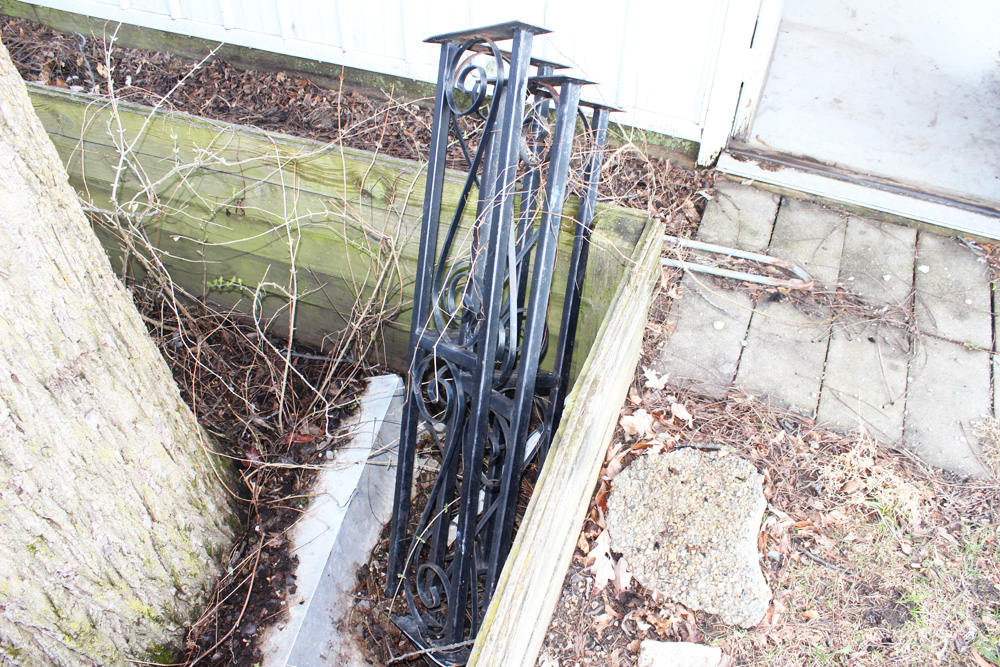

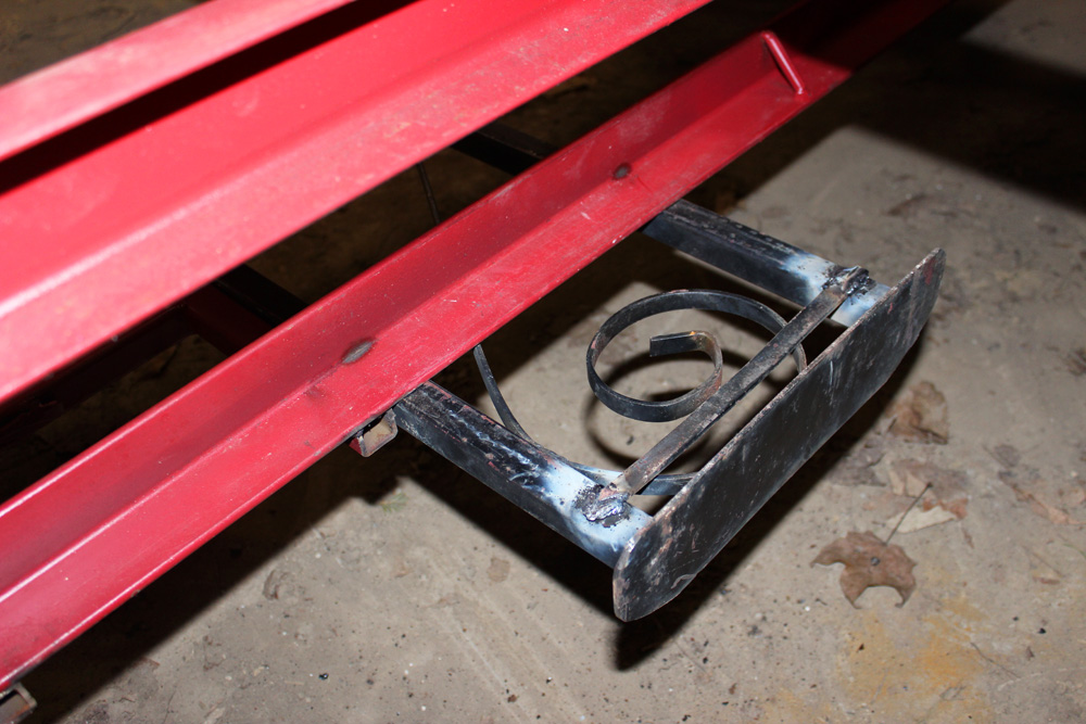

There aren't many options for mounting a pump and battery on the wagon as it comes so I set about welding up some supports.
I found these old porch supports laying around the farm and decided to re-purpose them.
Drilled a couple of holes to fit screws into the bottom of the pump housing. Also tied the ground strap to this location.
Next I needed to support the battery. I was out of room in the middle section of the cart so I decided to make a side carriage of sorts for it.
I'm not one to pass up a chance to arc weld, I need all the practice I can get... Frankly I'm horrible at it.
It's all in there, I think I still need to alter the configuration a bit. I'll probably flip the cylinder (rotate in position) so the hydro hoses loop around front and don't turn so sharp, I know that's a big no no.
I'm also experimenting with some way to keep debris and water off the pump and battery components. I'd like some protection but I'm also afraid of trapping moisture under the bed wood.

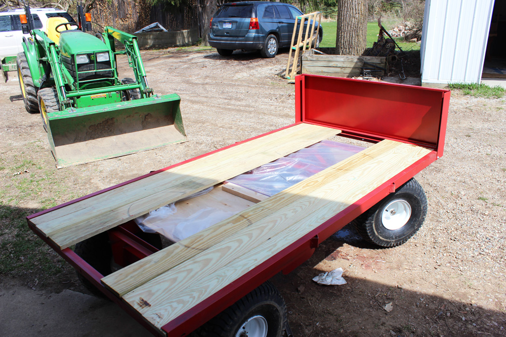

I should note that the filler strip they give you for the bed is a bit thin. To solve this I simply inserted some shims in each corner equally under the metal side lips.
I think a bit more tinkering and I'll have it put together this weekend.
