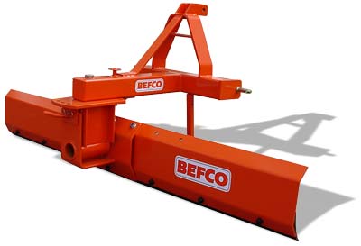

If you buy the tractor and if the snowplow does not angle, consider investing a couple hundred in a back blade, too. You can do a whole of driveway work with a back blade.

I know nothing about the snow blade at all other than it APPEARS to mount in the back. How can I tell?

If the blade looks like the one in the attached pic, it's a rear blade and they do angle (or pivot). They work fine for plowing snow, but if you get a lot of accumulation, the Loader comes in handy to pile the snow. If you don't get a loader yet, you'll just have to plow early and often to keep the snow pushed back.
As I wrote in my first post, the owner has been using this tractor for maintaining the property you're buying...so, it should do the job.
As far as the tractor itself...you could ask the owner where he bought it and to see any maintenance records. But if it pulls good when you try it, it's probably OK.
