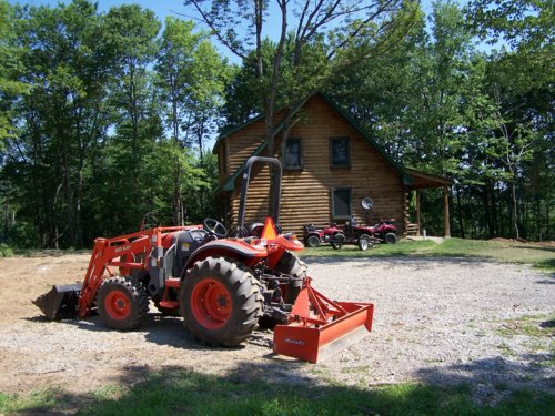

My favorite Counter Weight is my Box Blade. /forums/images/graemlins/smile.gif
God Bless,
Kinetic Kioti
CK30HST FEL BB 60" Hog

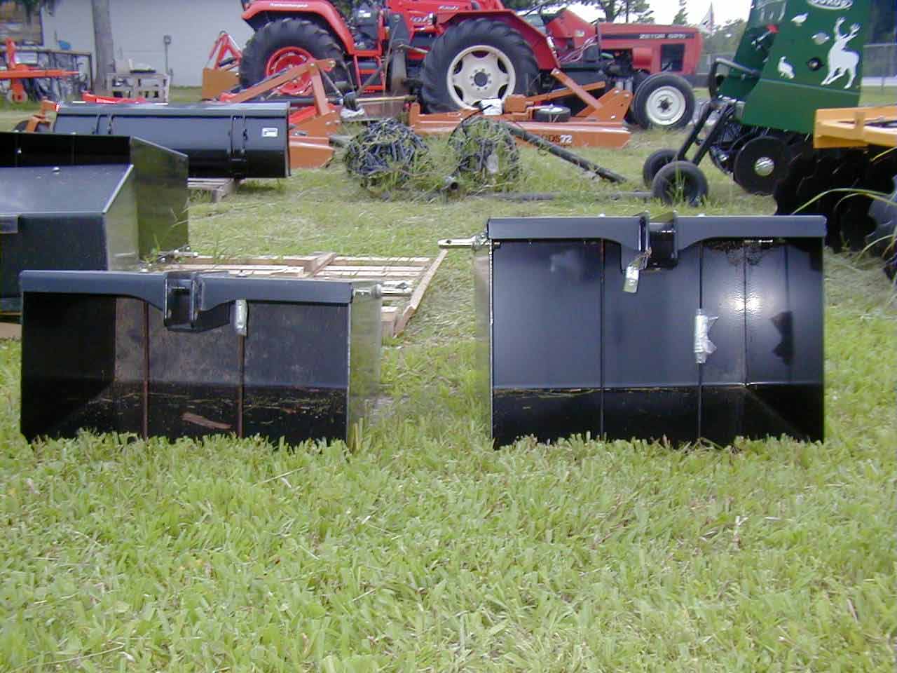

Here is a pic of two weight boxes that you can fill with sand or whatever. The cost is not much from what I remember, but I don't remember how much! These attach to the 3pt. hitch. On the left is the inside, right is outside.
John

John, do you remember about what those boxes cost?

Box Blade, mine is on all the time. Only when I need to rake or mow does it come off and then it goes right back on! Better to put a little extra money into an implement you can use than a box full of rocks...... /forums/images/graemlins/grin.gif
P.S.- Place ballast in your rear tires also!

</font><font color="blue" class="small">( John, do you remember about what those boxes cost? )</font>
I would say they were under $200. I have to agree though that an implement that has another use would be a better alternative, just wanted folks to see another option.
In order to use the max lift on most loaders, a boxblade may or may not have enough weight. Mine doesn't have enough to reach the full lift potential of my FEL. But, my backhoe does! /forums/images/graemlins/grin.gif
John
