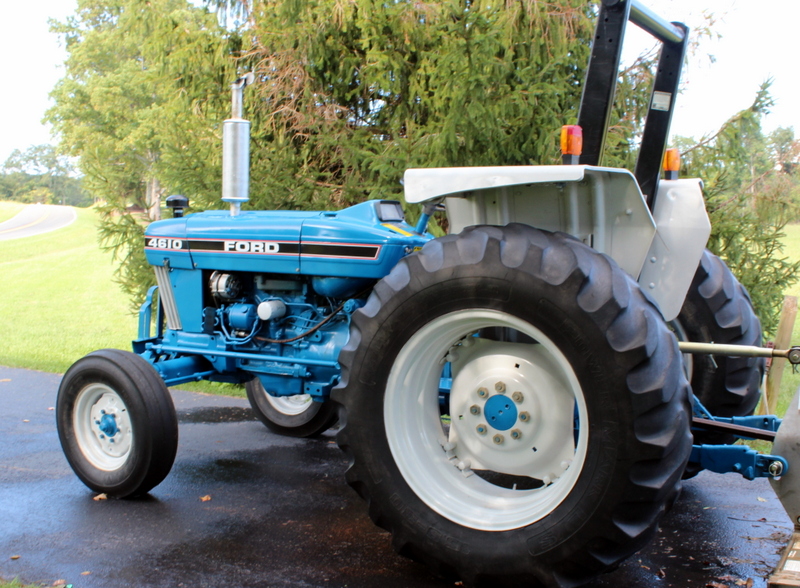

A couple of months ago I bought what I believe to be around a 1988 - 1990 (still have not located s/n) Ford 4610. Both my brother and I took it for a test spin and did not notice any problems with the engine; it sounded good to us. When the tractor was delivered and I hooked it up a my rotary cutter, I heard an unusual sound in third gear. When we go over 1500 - 1600 RPM the motor has what can best be described as a skip or putter and simply does not run smoothly. At higher gears the sound is not as noticeable, but it still does not run smooth.
We serviced the tractor, changed the fuel and air filters and cleaned all fuel related filters and lines and noticed some improvement - but it still "putters" and does not run as smoothly as it should.
I asked my local repair shop to check it again and they concluded it is probably a burned valve. This tractor starts exceptionally easily, does not smoke and does not appear to use any oil. Could this be a burned valve or should we check something else?
Any opinions or insight is appreciated.
