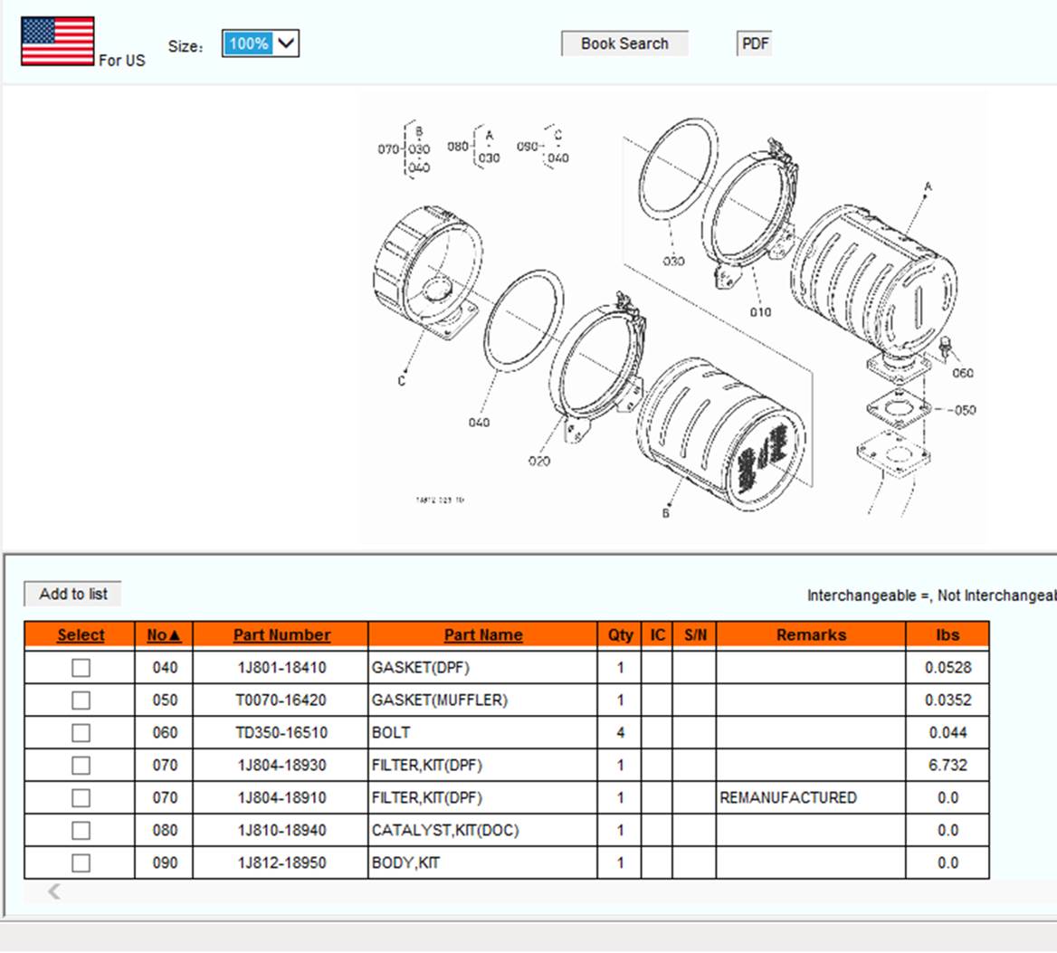

I've read costs for car and light trucks dpfs run from like 2.5k to over 6k$.
Any dealers care to look up and share the cost of a replacement dpf for say a l5460?
Just curious.
Manual says cleaning or replacement at 3000h, and hopefully in the next few years the technology for cleaning them will continue to improve and get cheaper. And hopefully they really do last at least that long...

DPF Filter Kit (DPF) P/N: 1J804-18910 is $659.64 on Messick's web site.
Catalyst, Kit (DOC) P/N: 1J804-18910 is $1,729.60
How long is the emissions warranty on the new tractors? On automobiles the emission warranty is much longer than normal vehicle warranty as this is dictated by the federal government.
   / Cost of a new dpf filter for an L60? Just curious. #5
The emissions warranty on compression ignition engines over 50 HP is 5 years or 3,000 hours. Engines under 50 HP are warranted for 2 years or 2,000 hours. The emissions warranty covers everything in the fuel system, DPF system, EGR system, turbo, exhaust and intake manifolds, and the ECU system including sensors. The warranty is void if there is customer neglect like running high sulfur fuel, non-CJ-4 oil, and not replacing filters and lubricants per schedule.
