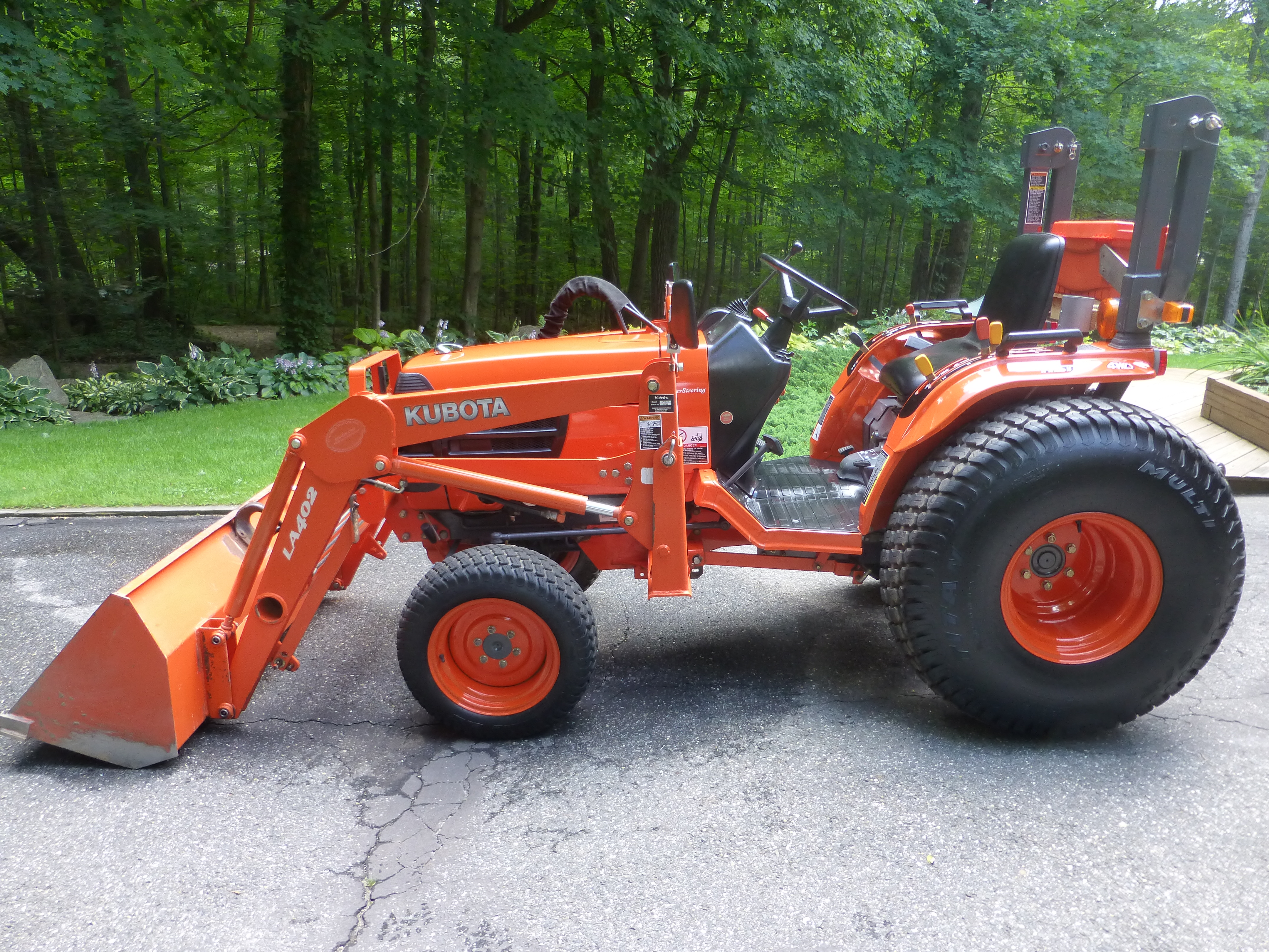

I am having a set of mounting brackets made for my Bradco pallet forks.
The pallet forks have skid steer mounts and I have a pin-on style Kubota FEL.
My question is regarding establishing the correct roll back. The brackets are going to
be mounted flush to the frame/perpendicular to the ground. As you can see in the photo the bucket comes with
an offset of 15 degrees.
To gain this necessary rollback I am planning on locating the BOTTOM PIN HOLES
further from the frame than the upper pin holes to gain the same 15 degree offset as the bucket.
Is this correct?
P1030861.JPG.
   / Correct pin locations? #2
That's how I did mine, otherwise you won't have satisfactory rollback.
   / Correct pin locations? #3
John I tryed to send PM but not sure it went. I said in PM that it was about that, I well check today and get a picture. It's like TMGT is saying .
