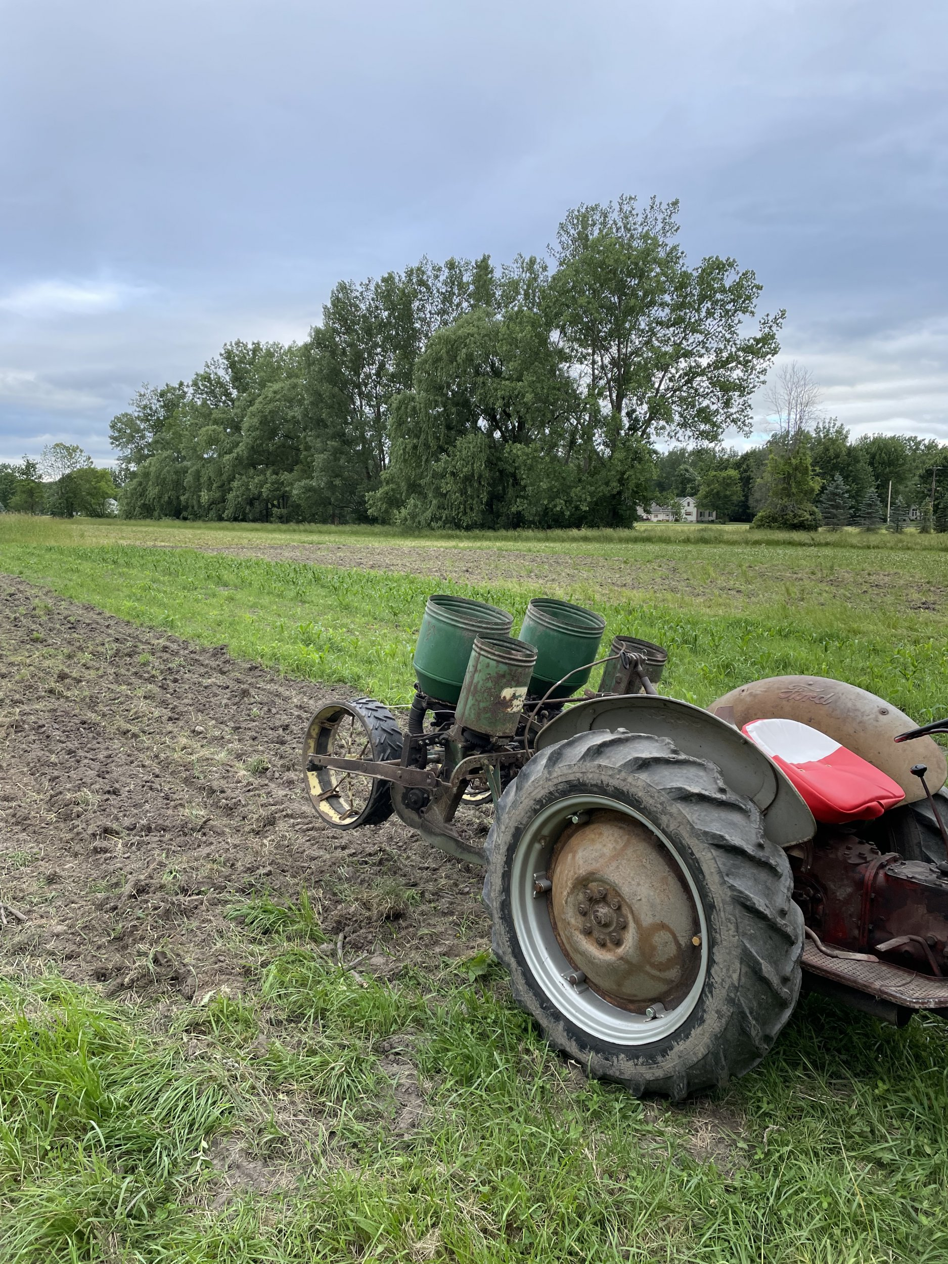

Looking for ideas for a corn planter. Currently using a John Deere 246, but it is about used up. Plant approx 10 acres for duck feed. Would like to apply fertilizer with seed.

I also use a JD 246 with fertilizer hoppers, that I paid $ 200 for about 25 years ago. The shoes were about worn out on it when I got it. My father in law gave me his old JD 290 a few years later and the shoes on that were like new. I swapped them out with the worn out ones on my 246, and sold the 290, lacking fertilizer hoppers, on CL for $ 250.
My 246 has some serious hours on it but it is relatively simple to maintain and repair when necessary. I like the fertilizer feature. I only plant corn on old clover plots. Doing that, gives me yields of close to 175 bu/acre with only 50 lb/acre of triple 15 starter fertilizer at planting.
