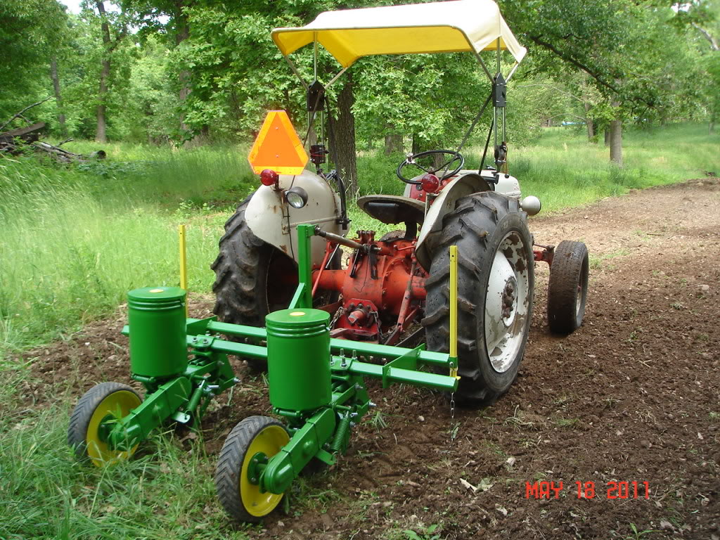

Like blueriver said, almost any planter will plant corn and beans. Lots of planters out there by John Deere, Ford, IH, MF, Cole, Yetter etc. You would likely want a 1-row or two row planter. I personally like my JD 71.
This sweet corn patch was planted with my TC-18 and my single row Cole 12 MX with a row spacing of 32 inches..

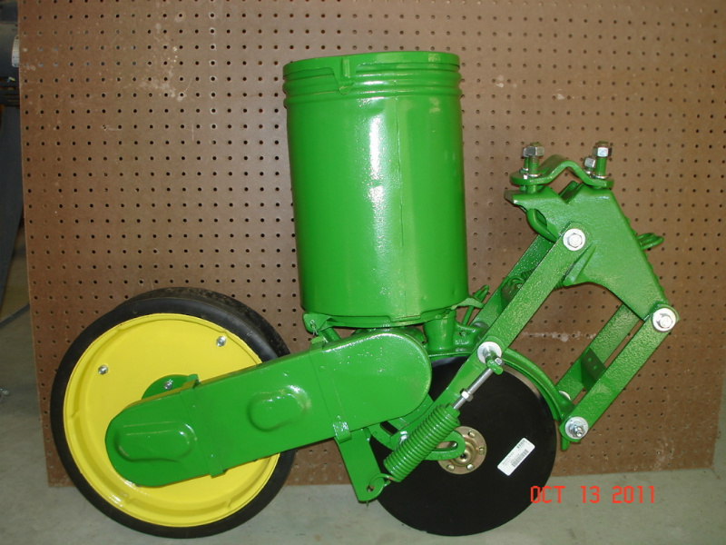

Yes, they were all pretty much designed to plant those, and many other seeds/crops by just changing out the seed plate. I rebuilt these JD 70 Flexi planters. BTW have a couple for sale if you're interested. Mark
