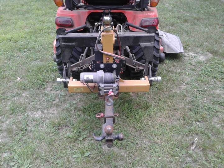

Wow.. It is heavy duty for commercial use.
Very nice
Thank you for the picture.
Only 2k actually --- here's my 8k version
The things you do when you never learned to weld

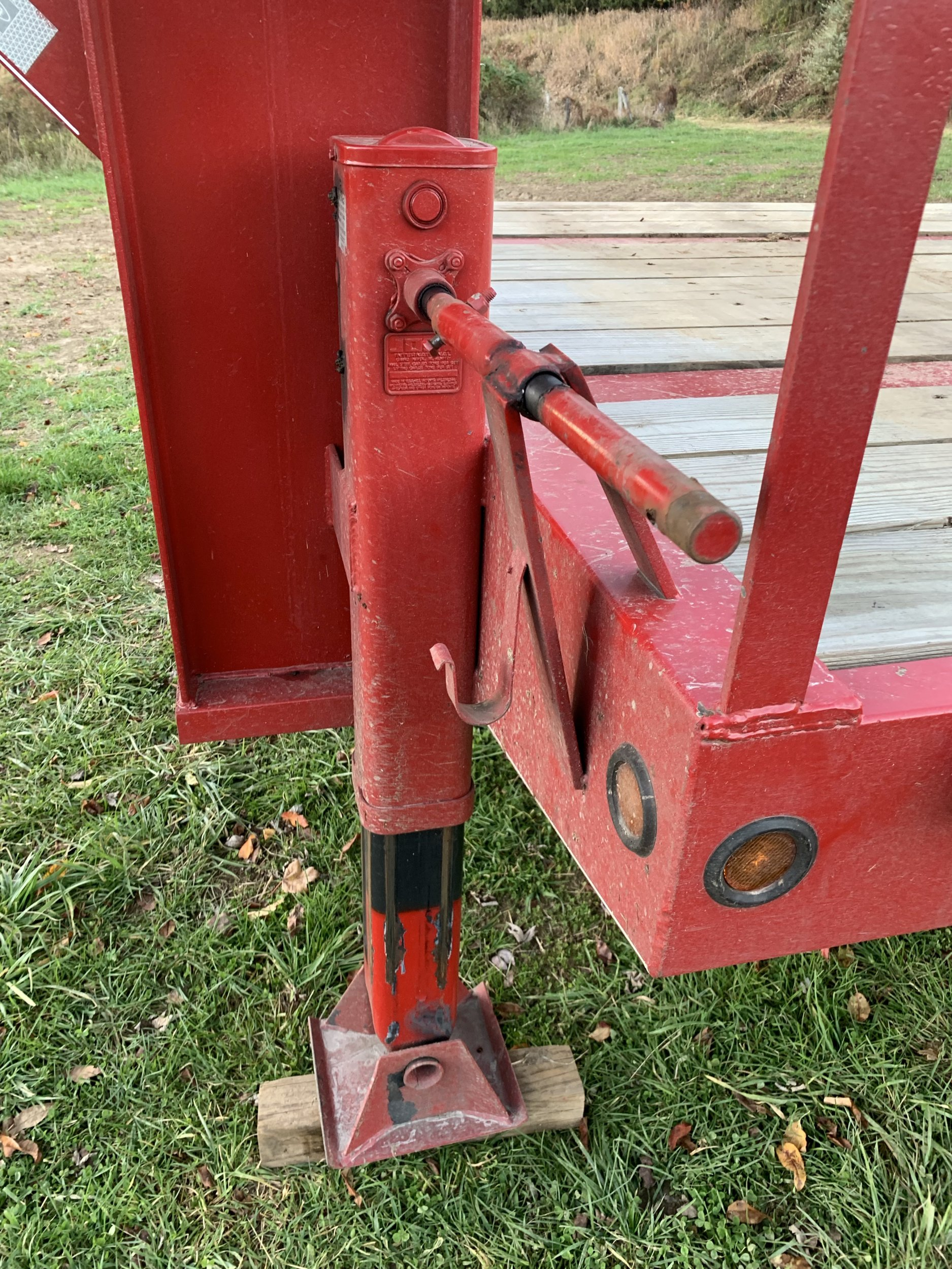

I wish someone would make an adapter for gooseneck trailers. A cordless, low speed 1/2” electricians drill would be perfect for raising/lowering my trailer. One of these days I’ll get around to it.
If you already have a suitable drill making an adapter is pretty easy. Without access to a metal lathe I’d find a socket that fits over the crank handle and drill it sideways so it can be pinned on the shaft. Then weld an extension in the socket and cut the ratchet end off so it fits in a drill. Or if you have access to a metal lathe it’s a pretty easy job to make an adapter.
   / Cordless drill winch from hand winch #13
This is what I rigged up back before cordless. The horse trailer was parked by the shop, so power was available.
And the campsites had power also:
   / Cordless drill winch from hand winch #14
What adapter is that and how is it connected to drill?
   / Cordless drill winch from hand winch #15
It is one that I made, connected the same way the chuck was connected.
The two speed right angle adapter came with the drill. I removed the chuck and used the bolt to fasten my adapter.
