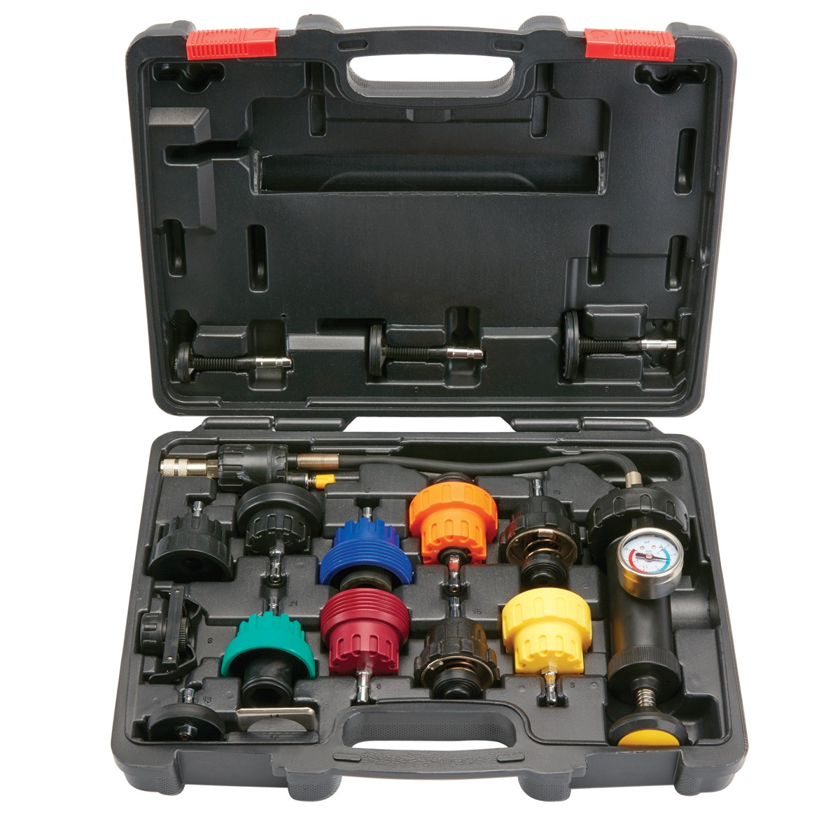

I bought one of these,,,
It worked great,,, if the pressure goes down,, there is a leak.
with the machine not running,, leaks are easier to find.
Advance Auto usually "rents" this for free!! :thumbsup:

Speaking generally-
If it's a slight leak between the coolant and cylinder (likely a head gasket), as described, you may not notice the exhaust. The second test method would show that. If the second test didn't show that but you were still loosing coolant then next step would be to overpressure the coolant system with the pressure tester described above. With the engine running something would change- white exhaust etc.
You would notice a leak between the coolant and oil with the milky oil.
I'm surprised the clamps can be tightened. Most modern OEMs use a constant pressure spring type clamp. The typical band style clamp doesn't apply the constant pressure and doesn't apply it equally- hence the change.
