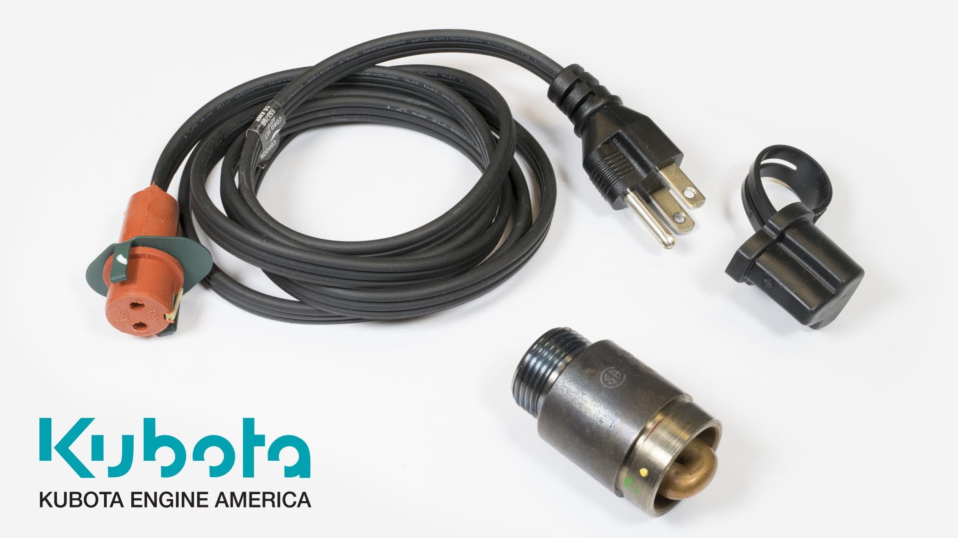

Bought my tractor new with the block heater installed. Noticed some coolant on the ground and traced it back to the block heater. Also noticed that my coolant level was very low. Glad I didn't overheat it.
Now I either attempt to fix the leak myself or I have to rent a trailer to bring my tractor in (float charge to bring it in for warranty is insane!)
Anyone have any suggestions on what the cause of the leak could be? I plan on taking a closer look at it when I get home from work.

To install a block heater you knock out a freeze plug... I suppose if the knock out was miserable and someone beat the snot out of it with a screwdriver or something and gouged the block itself - the heater might not fit the hole tight enough where the ding is and it's leaking there.

Some block heaters are threaded in, could just need some thread sealant, the ones that replace a frost plug usually have nut to snug them into place and swell the o ring that seals them

Teflon tape for the threaded kind works. I installed a threaded thermostat in a 2200 a few years ago and had to redo it using tape. Threads on castings are not that tight
   / Coolant Leak from block heater? Kubota BX
This is actually what it looks like

The block heater is a tap in.The part that looks like it has threads on does not go into the block the other side does.The instructions say to keep it from leaking you have to put Red locktite around the block heaterand hole in the block and tap it into the block.Of make sure everything is clean free from anitfreeze etc;.
   / Coolant Leak from block heater? Kubota BX #10
Its a press fit block heater. Wondering if they used a sealant like Loctite 515 when installing heater. I installed mine a few years ago, pretty straight forward install. May have to unistall and install with sealant. There was a thread on here that a guy replaced his block heater. Made a slide hammer to get it off, pretty slick.
