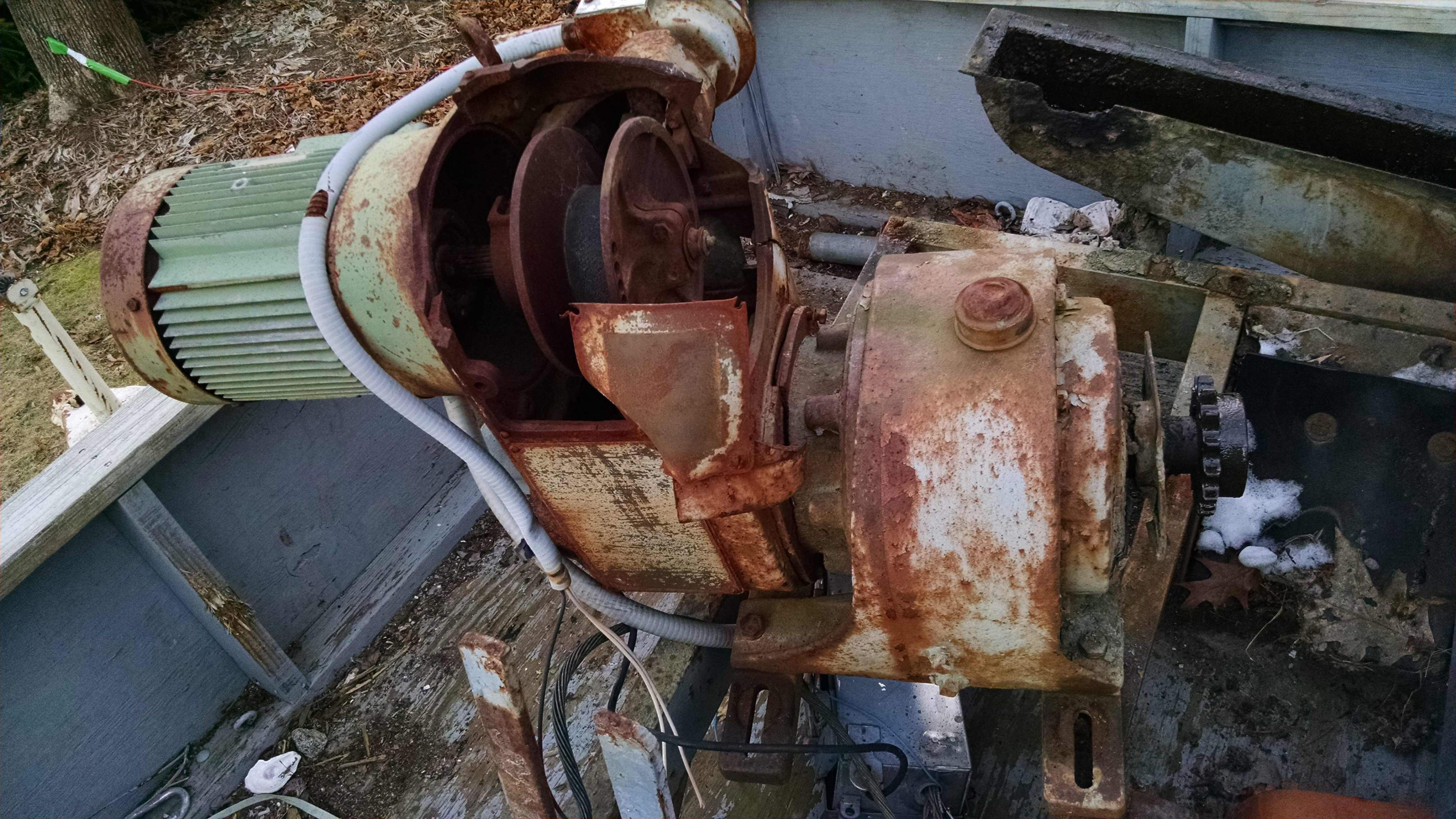

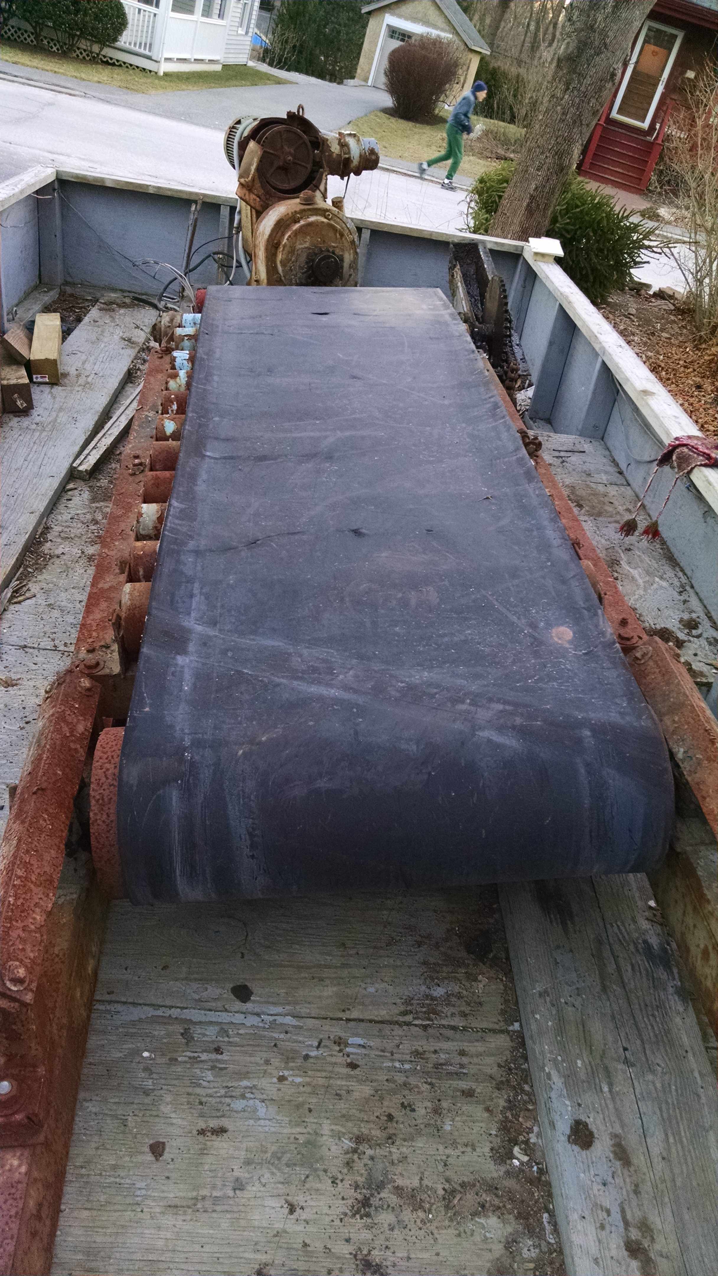

Hi all, So i have a 8ft by 30 in conveyor that I am going to build walls around and use as a hopper. I will be dumping compost into it. Compost weighs about 1000lbs per yard. I'd like to be able to have 4 yards in there, but I could be happy with 2 yards if what I build can't handle the weight of 4 yards. The bearings on the conveyor are all well greased, it was well loved by previous owner.
The clutch case on it appears to have exploded, which is fine because I'm not going to use it or the electric motor. I believe the conveyor was previously used for rock duty.

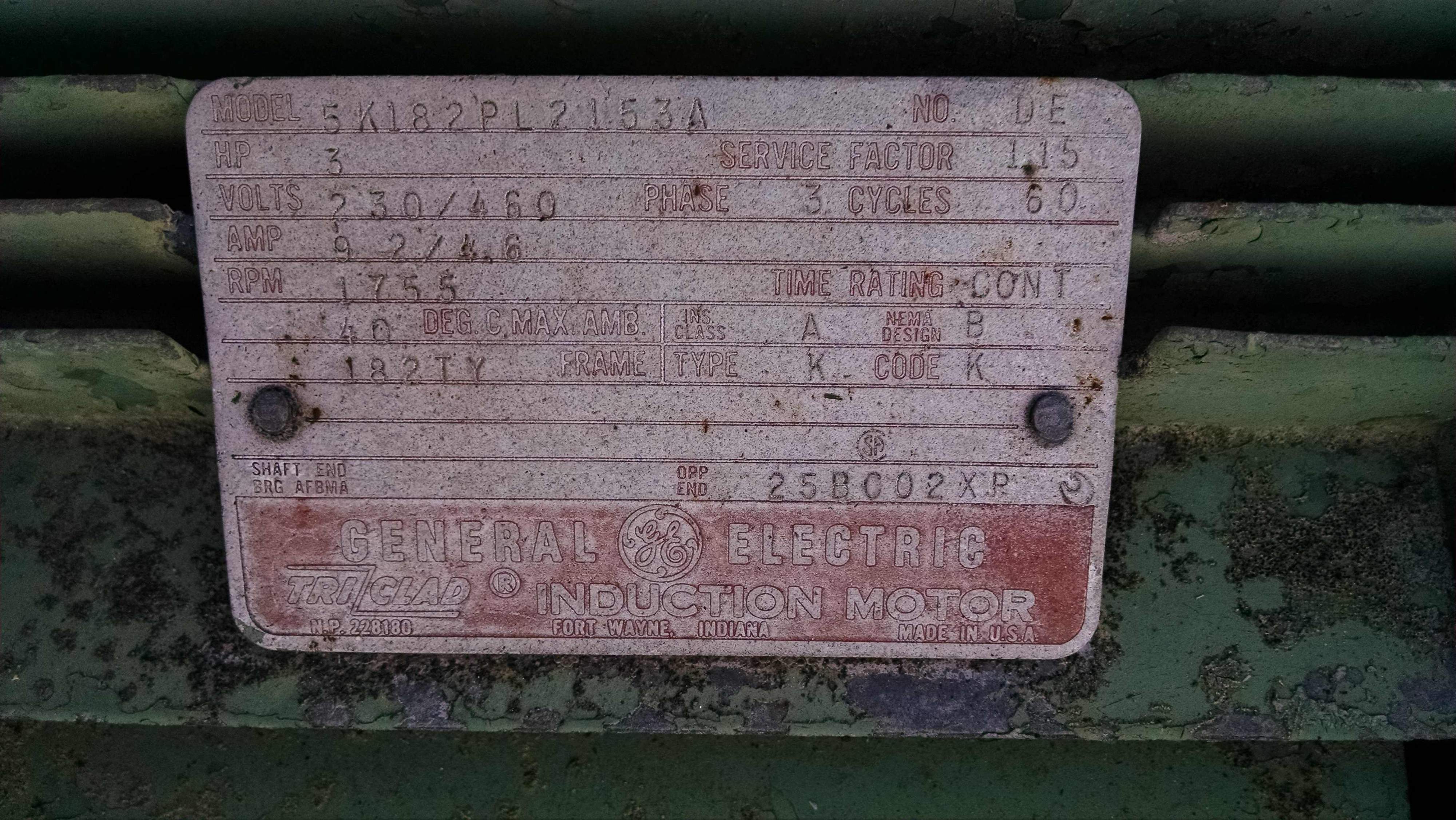

I understand the need for a centrifugal clutch or other type because there will be so much weight of compost on the conveyor and it will need to be stopped and started when its full. The original electric motor says its 3hp, 230volt, 9.2amp, 3 phase , 1755rpm. I want to replace it with a hydraulic motor. I have one that I do not know the displacement of. I will be powering it off of a mustang 440 skid steer. Using that as the power source I can give it 7gpm and up to 2000psi. The motor I have powered a pair of 2ft long discharge augers for a large mixer wagon (which mixes hay/straw for livestock).

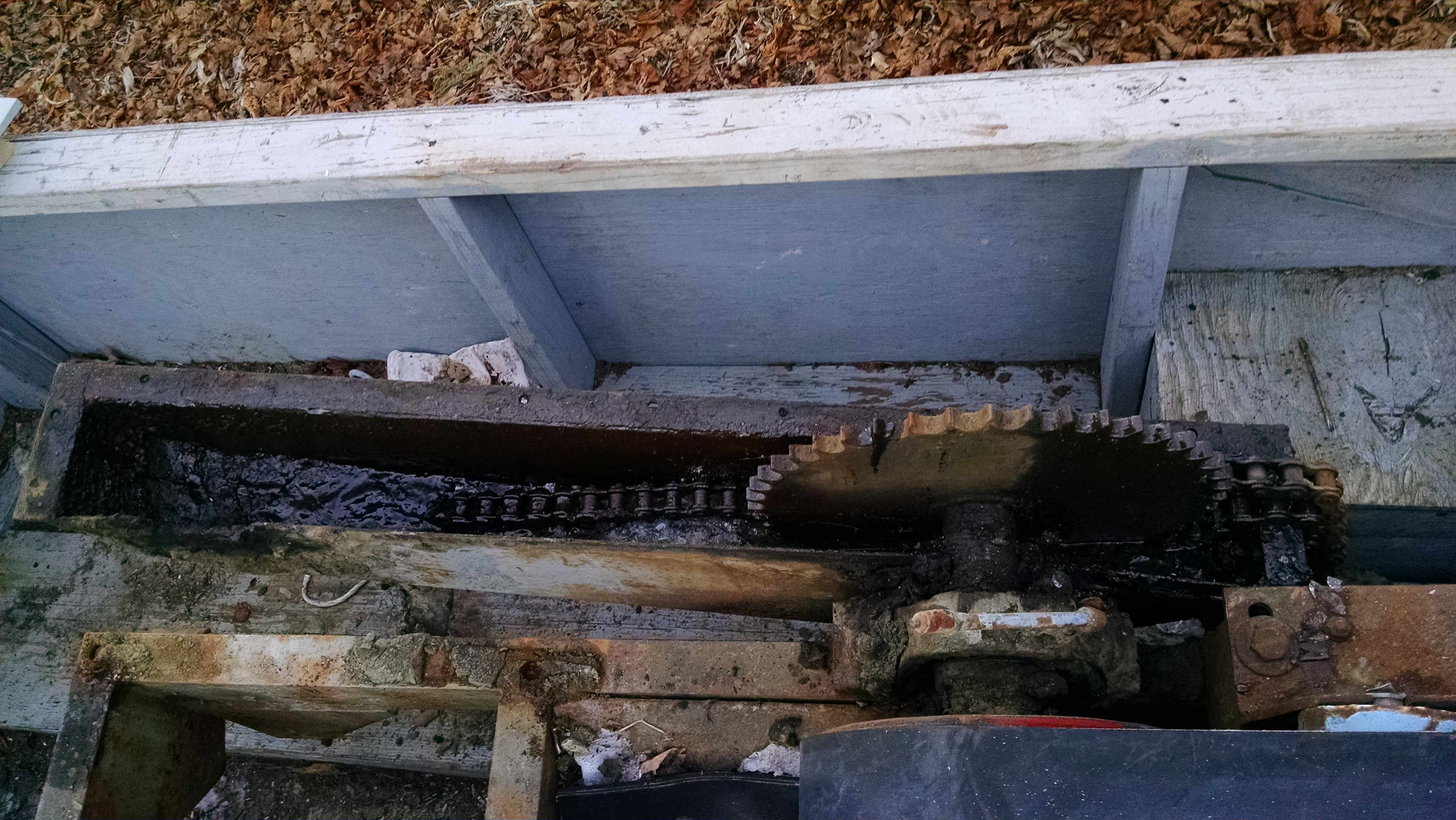

The conveyor is chain drive, I could put a small cog on the chain in order to help the motor power through the weight of the compost on the belt.
Any thoughts are appreciated. See the attached photos to see the conveyor and electric motor I am replacing

Do you have any numbers on a nameplate on your existing motor? I f yes post them and some one can probably provide the specs on that motor.

Hi oldnslo, I have done some rough calculating based on this belt's speed of 1 foot per second as the ideal. 1ft/sec however is just a guess of what I might need for this feed hopper. I want to load up to 4 yards of compost in it.
I'm calculating about 200 lbs/ square foot on the belt which has a total area of 17.5 ft. So thats a lot of weight.
Starting from the belt going at 1 ft / 1 second..
Drive rolller on the conveyor does 3 ft of belt drive / 1 rev_roller
Drive roller connects to the large sprocket so 1 rev_roller / 1 rev_LargeSprocket
Large sproket has ~45teeth and connects to a 15tooth sprocket, so 1 rev_Large Sprocket / 3 rev_SmallSprocket
The 15 tooth sprocket will be connected directly to my new drive motor.
So doing all that I calculate that to get 1 ft/sec on the belt, I need 60rpm out of the motor. This seems very low, but I can't see if/why its wrong. So using that motor rpm, and knowing that there will potentially be up to 4000lbs pressing down on this belt, I think a high torque, low rpm motor is what we need.
Additionally I could decrease the size of the 15tooth sprocket a bit to get even better gearing.

a 3 HP motor at 1750 RPM produces 9 ft/lbs torque
Speed reduction from 1750 to 60 RPM is 29:1 ratio.
29 x 9 = 262 ft lbs torque which is what the hydraulic motor would have to produce.

You might consider using the gear reducer from the old drive. It looks like there was a variable speed reducer coupled to the gear. The sprocket is on the output shaft of the gear reducer. Likely simpler to couple the hydraulic motor to the original gear reducer.
