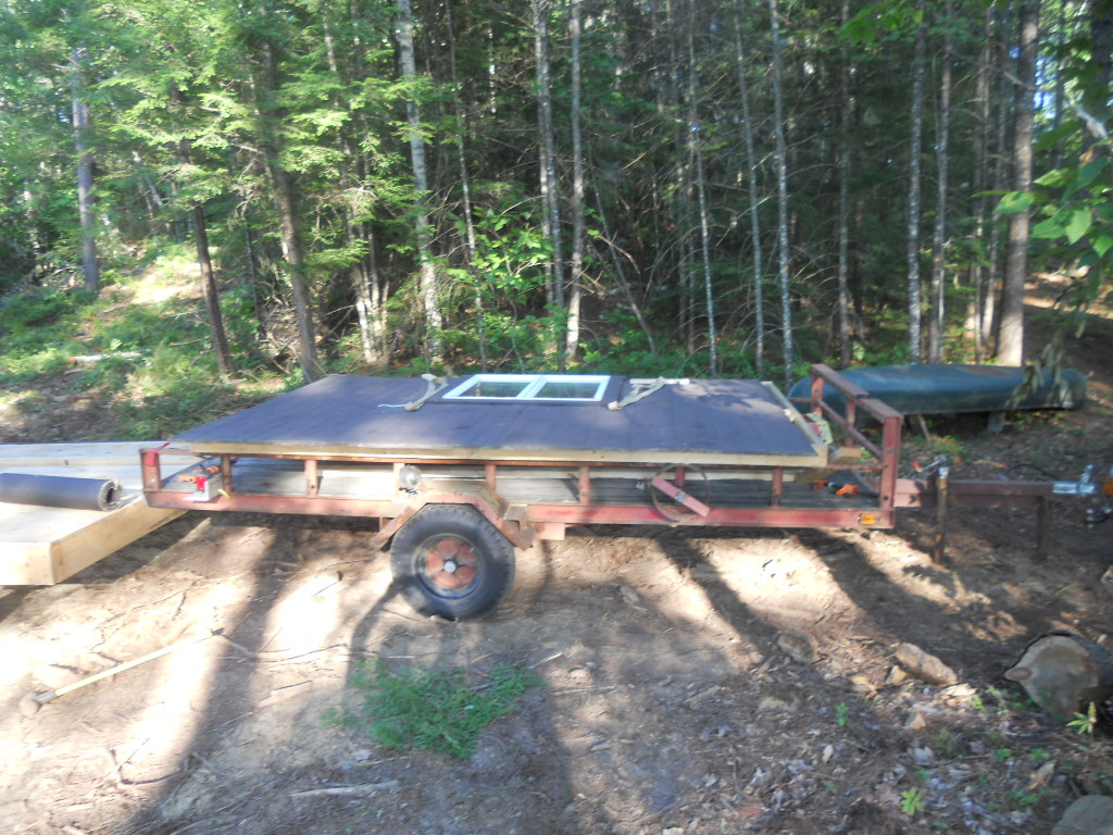

What's it going to take? I have a good utility trailer that has the old spoke type drums with the open center clamp on type wheels - (like a Mobile home trailer although it's not from a m/h). There were common when I built the trailer 25 years ago, but I feel that they are not suited well for highway speeds. It's a single axle with light 3500# axle (Dexter?) and I'd like to switch to a regular "dish" wheel and have better tire options.

There's no problem with those wheels for use on the street. Good bearings and tires are more important than anything on the road. The biggest problem with those type wheels is getting them balanced these days, but a truck shop should be able to do it for you. They are also heavy so take away from your payload.
If you want to convert you probably will only need new hubs for the spindles. If it was me I'd look at the cost of tires and bearings for your current set up vs new hubs tires & wheels...
Good luck

By the time you figure the time and cost of materials for converting I'm thinking you won't be far off the cost of a new axle. Just buy some new u-bolts and you're in business.

My trailer originally had mobile home axles and I was going to convert them to 8 bolt hubs. After pricing out the hubs and brake assemblies I figured I should do shackles and bushings and a broken leaf and such but in the end it was actually cheaper to buy the whole axle assembly complete and just weld on the new shackles. It can be done either way but I would have a good look at the whole outfit. If it's that old it would suck to buy new hubs then realize you need new brakes, bearings, or springs and the list goes on.

The axle had brakes but I never wired them up. This is my little trailer for the little jobs, a ton or under. It's a tilt deck, good for lawn tractors, Atv's, picking up things too bulky for the bed of a pick up.

Might be close in price to just buy a 3500lb idler or look on craigslist. 3500lb axles are cheap and common, as are the 5 lug wheels. The hubs available for that axle are going to be 6 or 8 lug.
