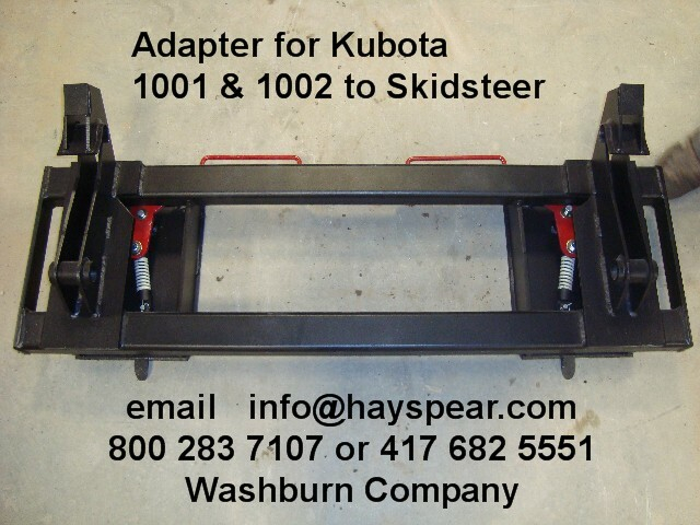

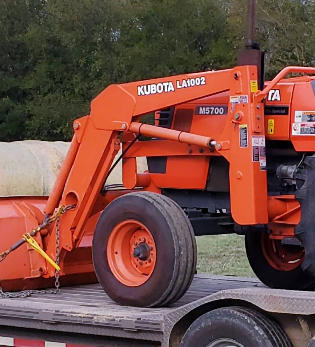

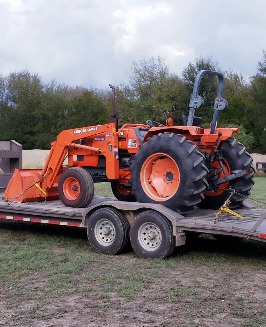

Have a 04 M5700 with a LA1002 pin style loader, has anyone converted it to a quick attach, its a pain in the butt having to swap attachments, if so what brand of quick attachment did you go with, Thanks
   / Converting to Quickconnect #3
Just did this exact thing. Kubota makes a factory quick attach for that loader. It cost around $500 ordered from the dealer. And then you have to weld a skid steer plate to your bucket.
   / Converting to Quickconnect #4
I agree that this is the simplest solution. I've converted a Kubota and a NewHolland this way. At the time it was cheaper to use factory parts than aftermarket too!
