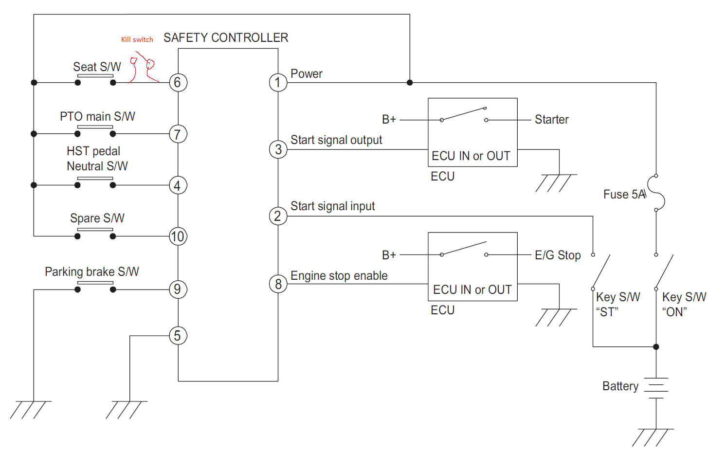

Hello,

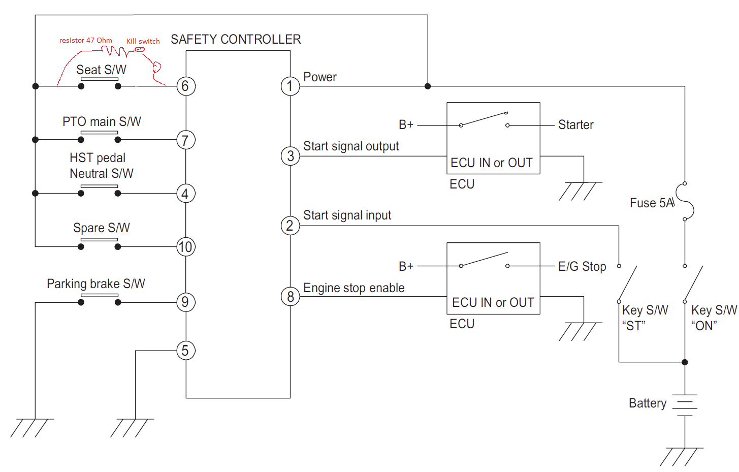

I've been thinking about a good way to create a anti-theft hidden engine kill switch and I was wondering if anyone else has used the seat safety switch for this purpose. The idea would be to tap into the existing circuit and add a switch, somewhere hidden which can be used to disable the engine. I think it could optionally be used to just disable the safety feature, but I'd like to keep it in tact. Whether you want it disabled or not, I think it would be good from an anti-theft prospective if it looked like the seat safety circuit was not modified.
See the attached circuit, I think I can just tap line 6 and and a switch, hide it under the tractor somewhere near the line going back to the seat from the safety controller. Will have to find a weather proof high quality switch I guess.

I guess if you wanted to disable the safety, you'd want to do something like the following attached curcuit.

Seems like disconnecting/unplugging (or installing a switch in) any of those wires would disable the vehicle. No?
   / Converting safety seat switch circuit into a hidden engine kill switch?
Well, yes, kind of, when you disconnect or unplug, thats the point of a "kill switch", but with a switch you can re-connect or plug back in and then the vehicle is re-enabled.

Some people just leave pto switch on. I'm thinking a battery disconnect switch may be more useful, anti theft and disconnect power.
I think the PTO switch is a good idea, but obvious if your thief knows much of anything. The battery disconnect is a good idea also, but obvious and usually easy to jump...? I was just thinking this mod would be easy to hide making it less obvious.
