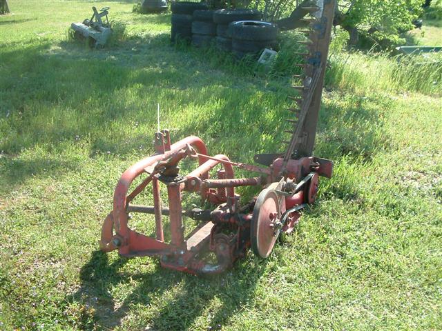

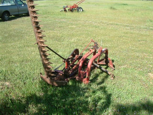

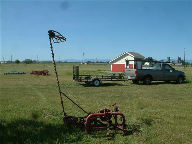

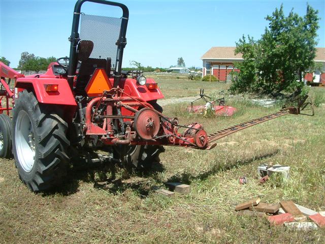

Here's what my vintage Massey Ferguson 41 sicklebar mower looks like
It's hooked to my 2008 Mahindra 5525.
Bought it for $550 at auction. Put in another $150 for new sickle sections and guards. Be prepared to do likewise with your particular sicklebar.

Flusher: your Massey unit looks a lot more user friendly than mine. the PTO power is converted into a linear reciprocation motion early on in mine, and I'm fairly sure it won't function much past horizintal.
I'm also sure that the sickle parts on mine are essentially buggered - it's in need of some re-building: Wery clunky, all bushes are dead or gone, and the sickles (when not missing) are bent/worn. the safety linkage that protects the sickle is "adjusted" in such a way that it is rigid, and won't offer any protection for the sickle at all.
